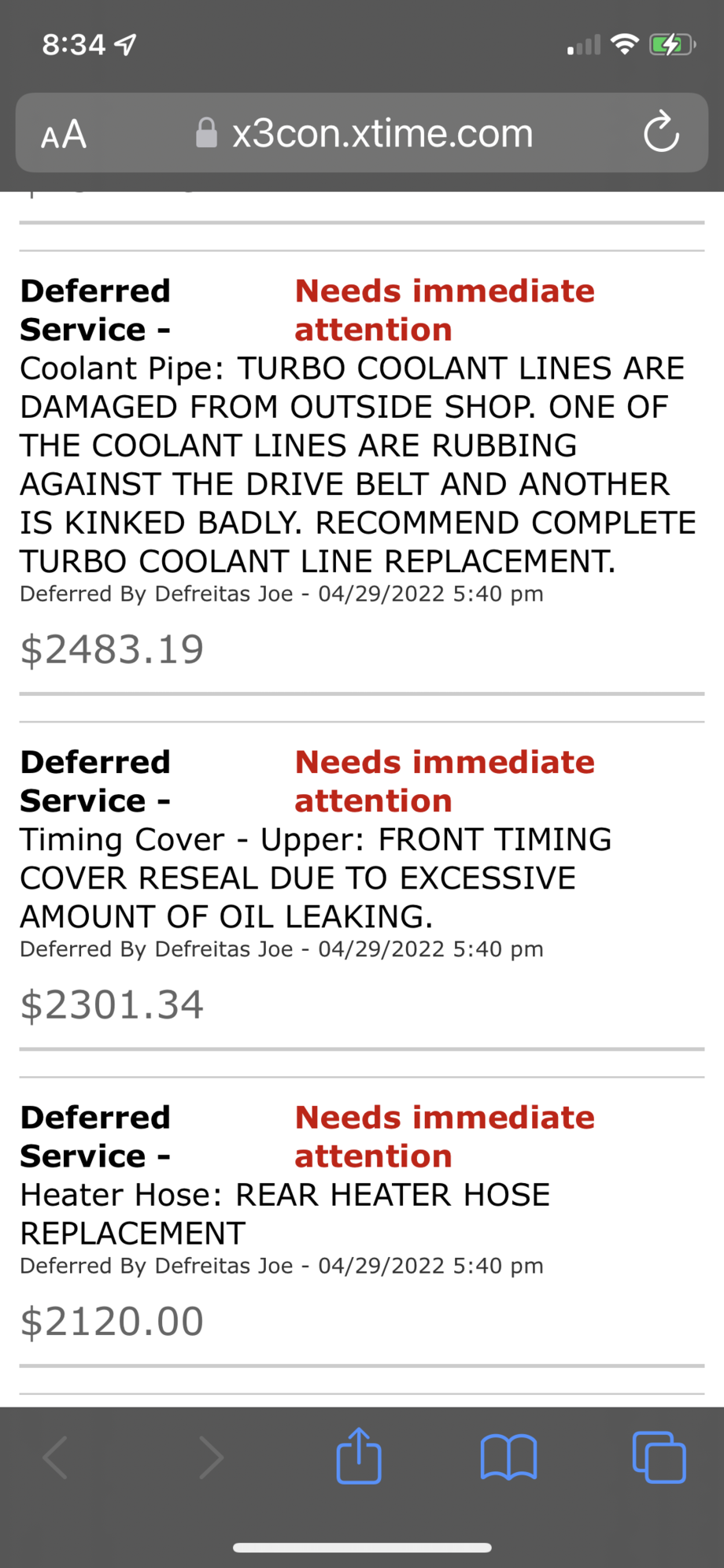

Quote from local MB dealer, I ended up going to a local shop for less. Fremont CA

If the quote was 2.5k I would get it done, but 5k?
Techs here in n.FL think they live in Dubai.
