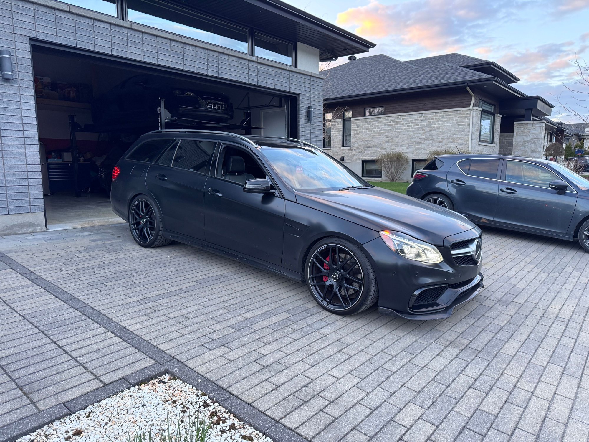

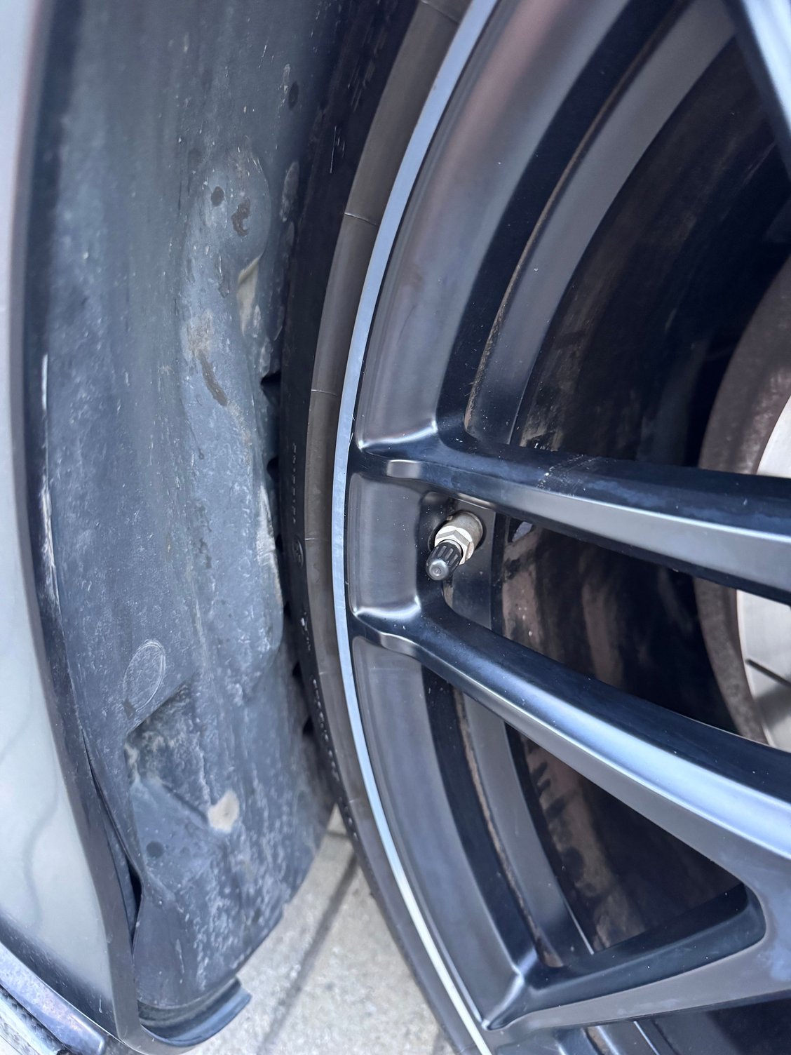

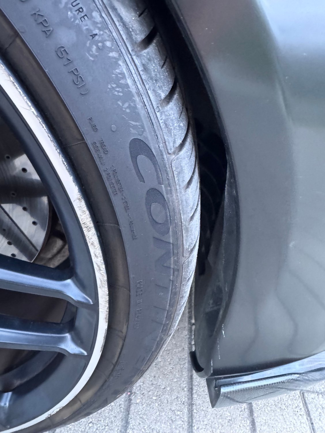

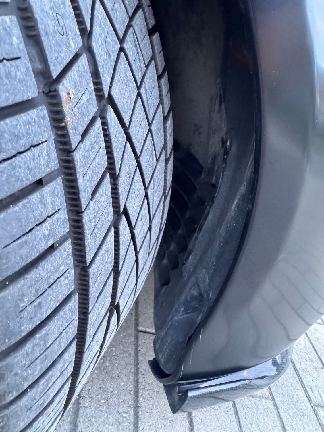

Installed 295/30/20 in the rear and 245/35/20 in the front, unfortunately the front is rubbing against the fender liner at full lock (mostly on the passenger side), rear is completely fine.

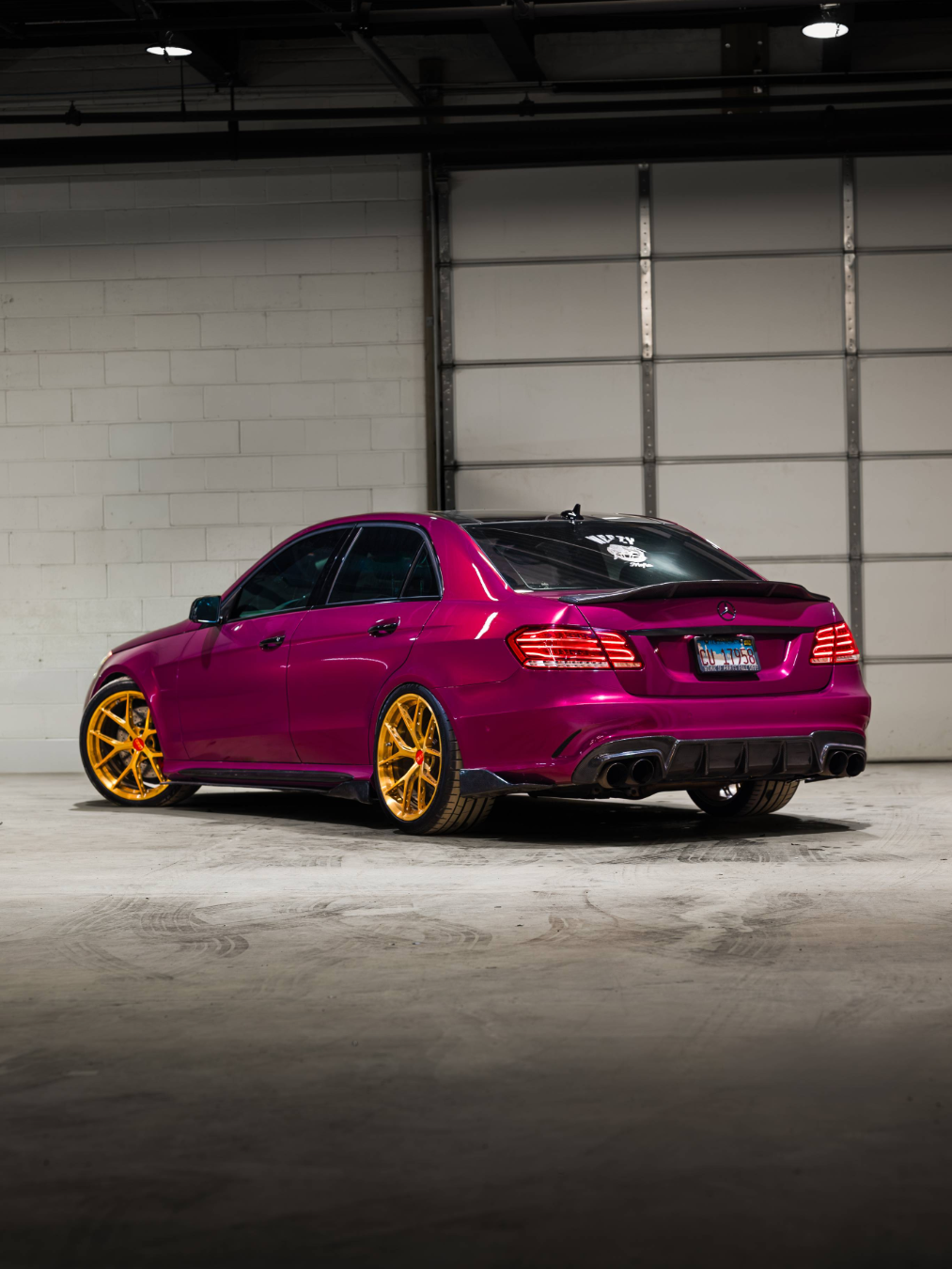

My 2014 e63 amg setup
20x9J et +25
20x10J et +38
Front 255/35/20
Rear 295/30/20
Here are the pictures.
