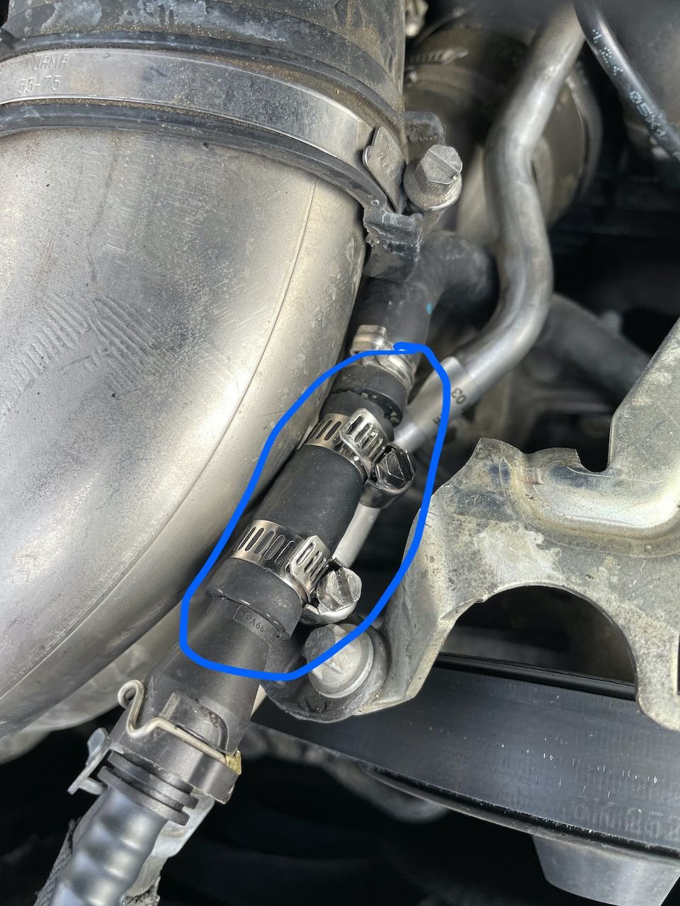

Here is how I temporarily patched the hose that broke. I used a 7/16 ID hose (3/8 should also work) and slipped it over the two halves of the broken hose and clamped it on both ends. So far (1 day) so good.

Nice work. I did the same on my 06 e500 while the part came in fcpeuro. It worked so well I never installed the oem piece 😂
on the e63 I decided to spend the extra cash

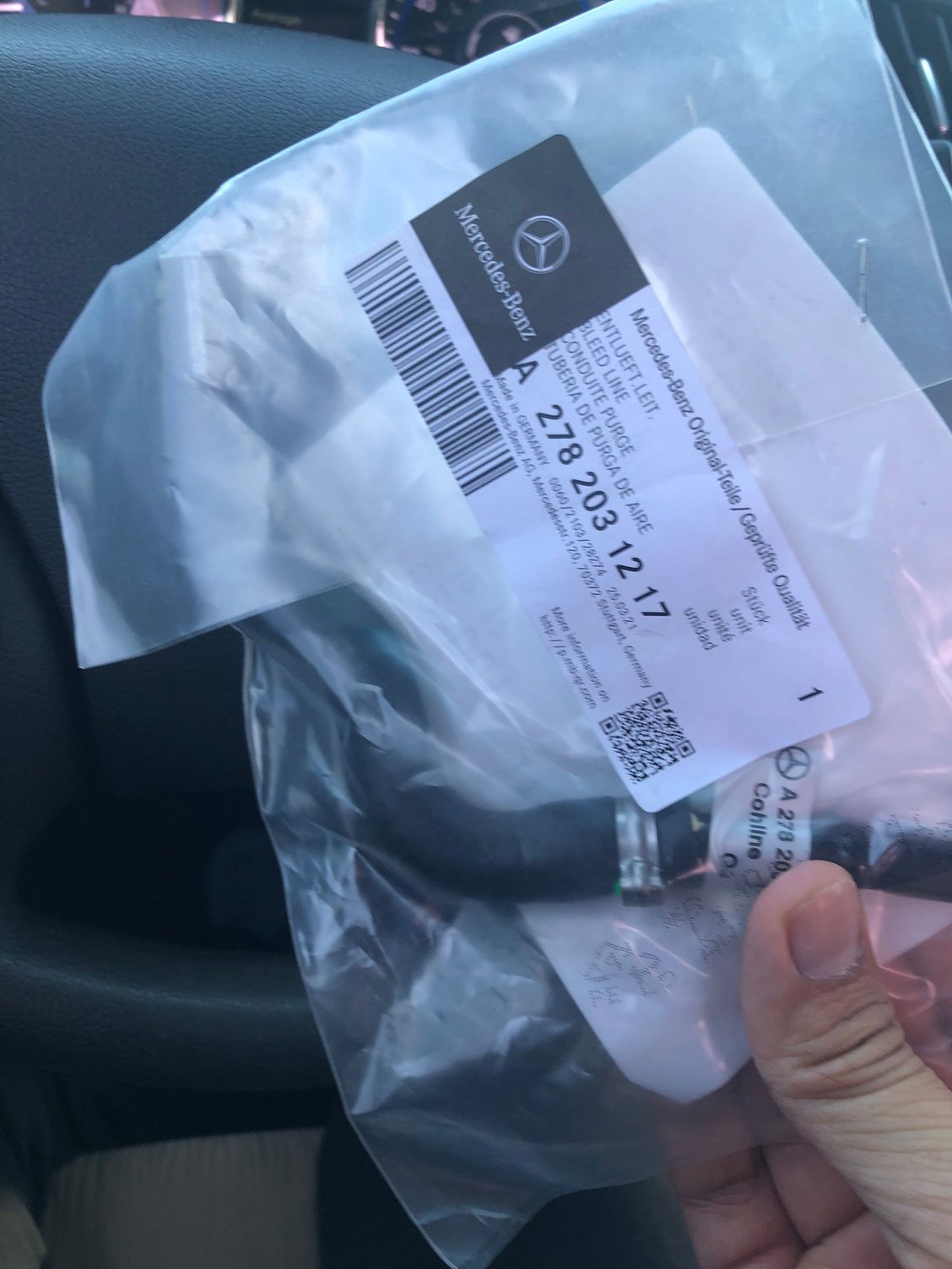

Thanks for the information and part number!!

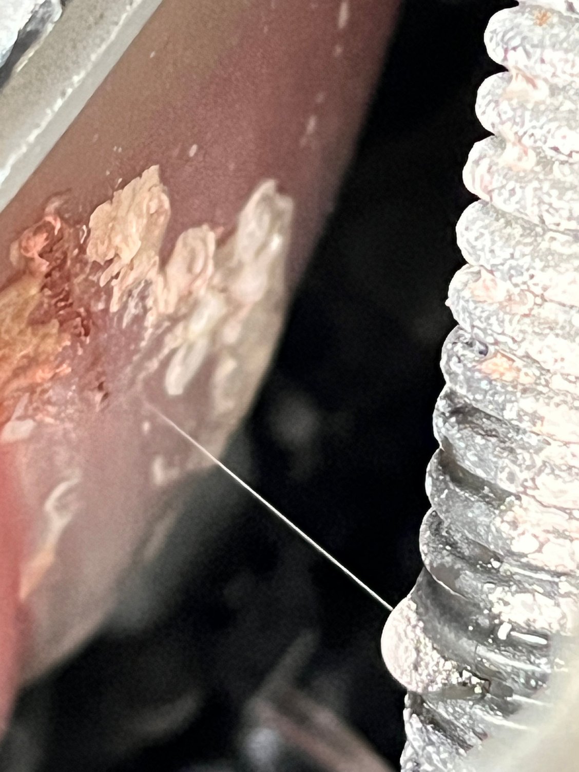

Well karma has caught up and now in addition to the cap leaks now I have my own pinhole leak.
It's not at the seam between the clear and black plastic but oddly in the middle of the clear. You can see the high pressure stream in this picture as well as dried coolant residue from previous leak events. Going to stealership this week.

Nice shot there . Swapping out reservoirs is easy enough pinching off the lines to avoid bleeding the system . Are these 157's self bleeding ? or is a vacuum tool needed if a more significant amount is changed or lost ?

MB replaced under warranty, service notes don't specify whether the system was bled just refilled.
They also found a stress-cracked turbo coolant line, presumably the plastic one and replaced without prompting. Kinda surprised actually.
