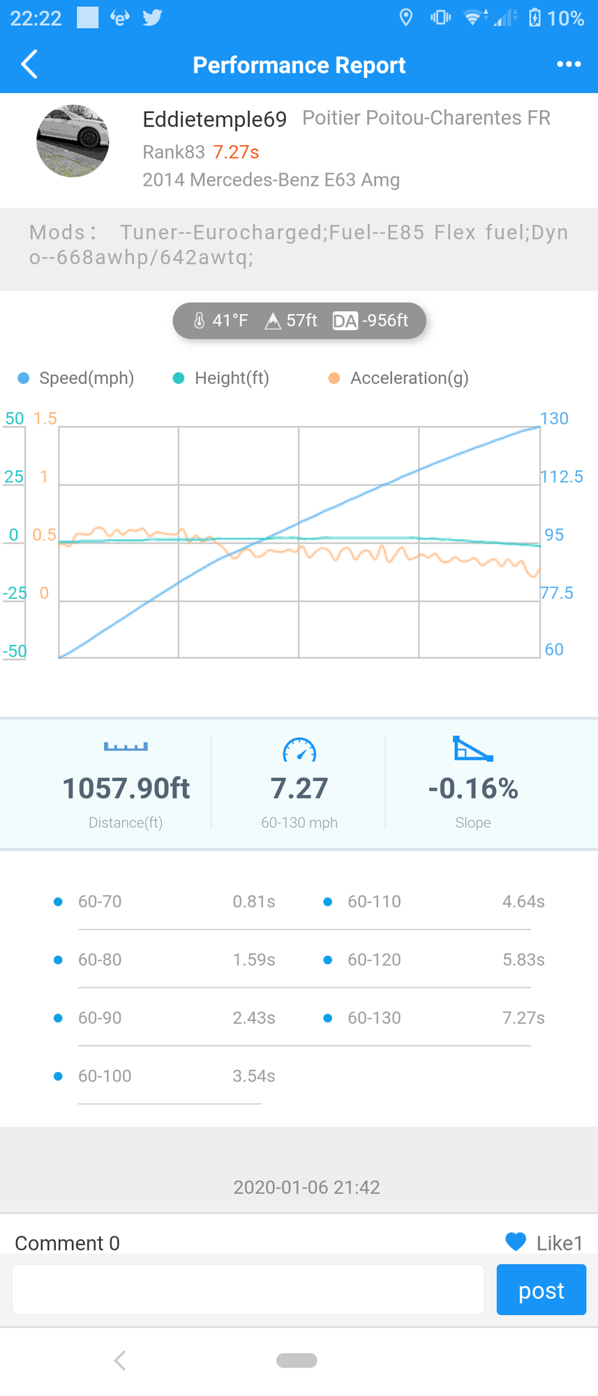

One of the guys in here just ran a 7.27 60-130 with the Eurocharged flex tune, but he is RWD. The stock TCU in the AWD platform is very restrictive in the lower gears.
Its not an apples to apples comparison I feel. What are the quarter mile times for comparison as well?
correct. And aren’t the rear wheel drive gearing different? Maybe I’m wrong.
