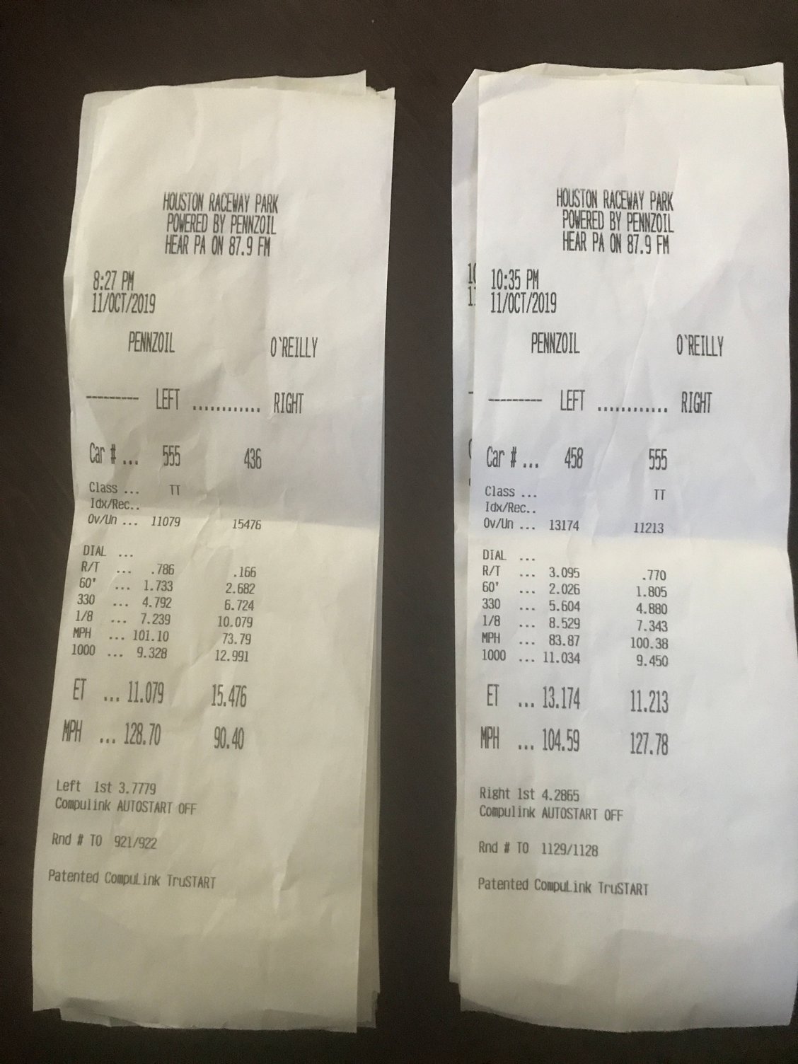

I've made many runs down the quarter mile over two different weekends and backed it up with many draggy runs on private roads over the last few months.
The car still has the stock TCU tune, and Jerry has done an admirable job of staying within the torque management parameters dictated by the stock TCU.
When in "maximum attack" mode we've found that brake boosting and turning TC off, while having the transmission in Sport+ netted us the best times at the track. When configured like this we only saw one run when the nervous nellies in the Transmission put a halt to the fun... of course this was when we pulled a 1.6 60' and were on our way to a 10.9 run, before the TCU shut the throttle.
Here's the car during testing on the first night at the track.. Houston Raceway Royal Purple Raceway, in Baytown TX.
Followers of the other thread will know I experienced fuel cut on that evening because the car's injectors couldn't keep up with the demands placed on it by the E60 blend.
The week following this picture, we went back out with a revised tune and a slightly less aggressive ethanol blend in the tank.. E50. This time I was car 555...

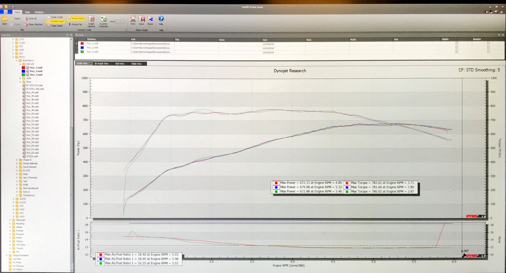

This is the last dyno we took with E50 in the tank... this is the power I now make daily.
These cars love the higher octane when tuned for it!
There are a lot of tunes out there that make more torque than I do, but not many that make the same amount of power... and at 17 psi to boot.
By purposefully retarding torque down low, the car is able to adapt much better in the higher rpm's.

Here's an update on the flex tune.
The following dyno is running 93 octane using the same tune as the E50 blend.
As mentioned previously, the car adapts to the various blends from straight 93 (10% ethanol and 93 octane) to E50 (50% ethanol and 100 octane)
Straight 93 octane gas nets me ~635 AWHP and 720 AWTQ... using 15% DTL as an estimate this puts me at 750bhp and 850 lb-ft torque.
E50 blend nets me ~680 AWHP and 780 AWTQ... using 15% DTL as an estimate this puts me at 800bhp and 920 lb-ft torque.
The addition of the increased octane allows the tune to make much more power.
I'm going to the track again soon.
We've seen what the E50 blend gets me.... 11.0@129mph... I think I'm going to spring for the good stuff and try a tank of 104 Race Gas to see if I can crack into the 10's tune only.
