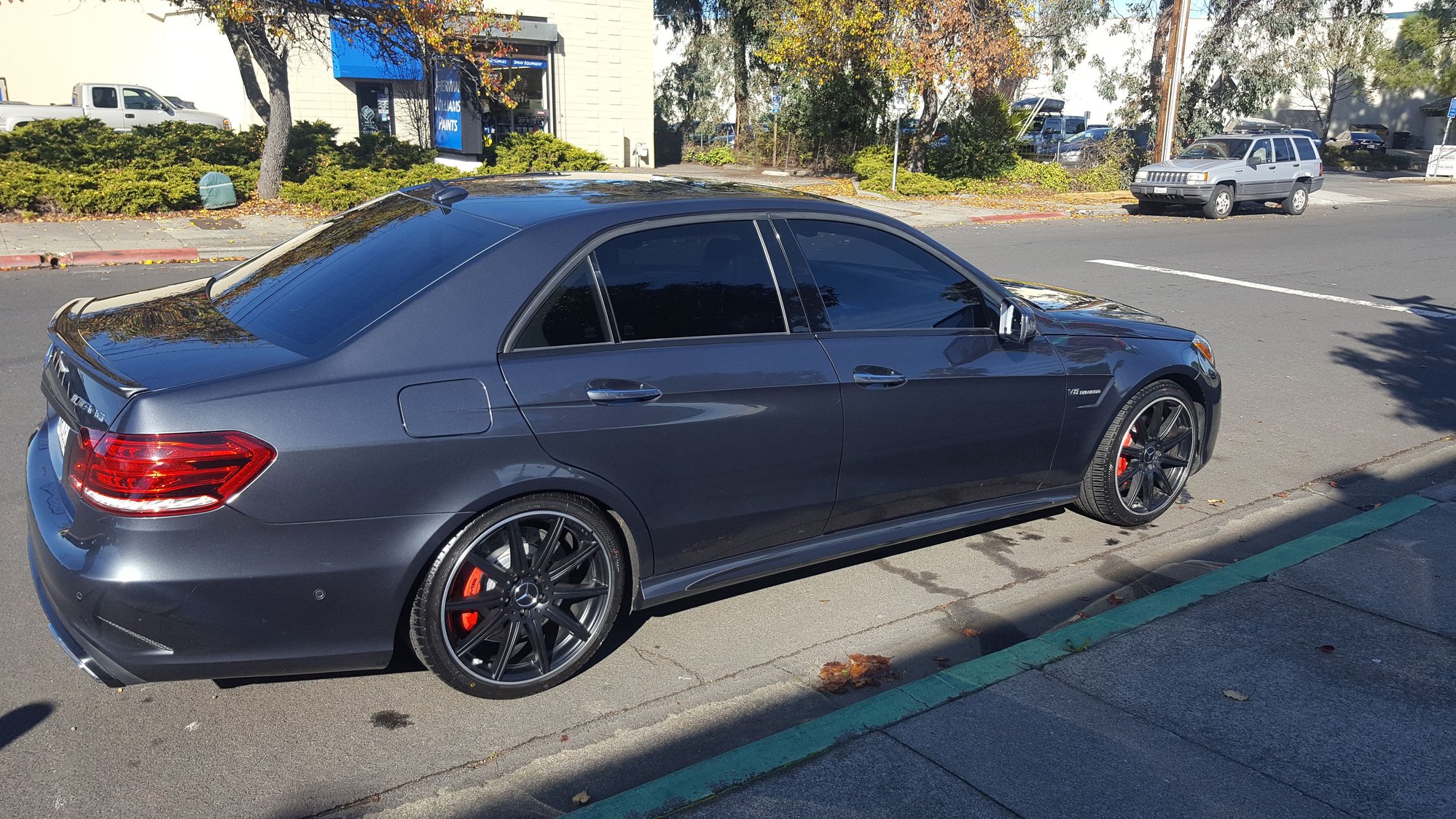

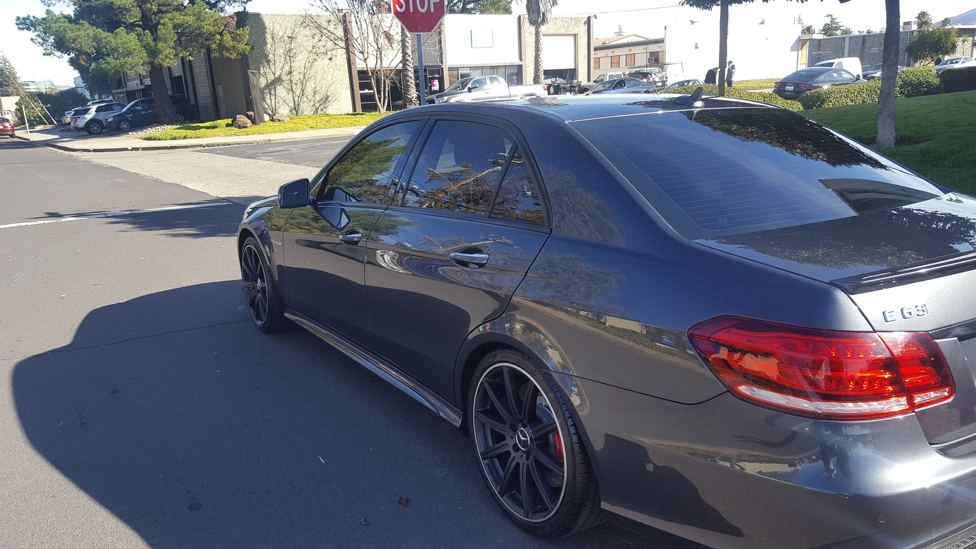

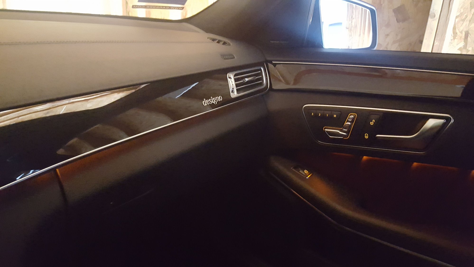

Hey Gentlemen,
Yes I'm a newbie but not to the Mercedes world, so forgive me for chiming in earlier just elated on the progress here. I just picked up my other baby. Long story short it already has secondary cat deletes and a Renntech exhaust. Sounds mean even in C mode. The dealer said it a renntech tune but subsequently it has been flashed back to stock. Nonetheless I have been following all threads from here and read every single comment (seriously). I will be dyno'g the car next week in its form now then following up the the flex fuel E50 route. I am really intent on adding BMC or AFE dry filters and DP's. Emailed Jerry he stated he has a set of used Renntech catted DP's on his car and they added no power so that might be up in the air. So to continue the research here I will baseline and follow up with the progress throughout my adventures.
Wish me luck and welcome to the W212 platform. I will also be investing in data collection which should help here.
2014 E63 S-21,000 miles
Designo-Sweet
Coming for you!
Super clean very fortunate.
Loving the color and W212 platform.
