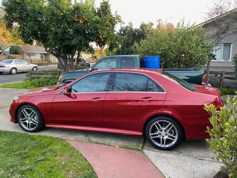

Updating everyone: I have tentatively purchased a 14 e550 in cardinal red 75k miles. It has almost every option I was hoping to find and a few more miles than I originally was looking for; however, it is owned by the original CA owner who has every invoice from dealer service since new in addition to the factory window stickers. That sort of sealed it for me especially when I learned he's an old car enthusiast so it certainly hasn't been abused. Owner is in his mid-70's.
I wish it had a few less miles, active driver seat and distronic plus. I paid $19,500. 70k B service including the transmission was done 5k miles ago. So hopefully it will be a good solid car as I like to DIY and keep things in ship shape. Glad it has the black ash trim, premium 1, LED lighting, folding rear seats, and keyless-go packages.
