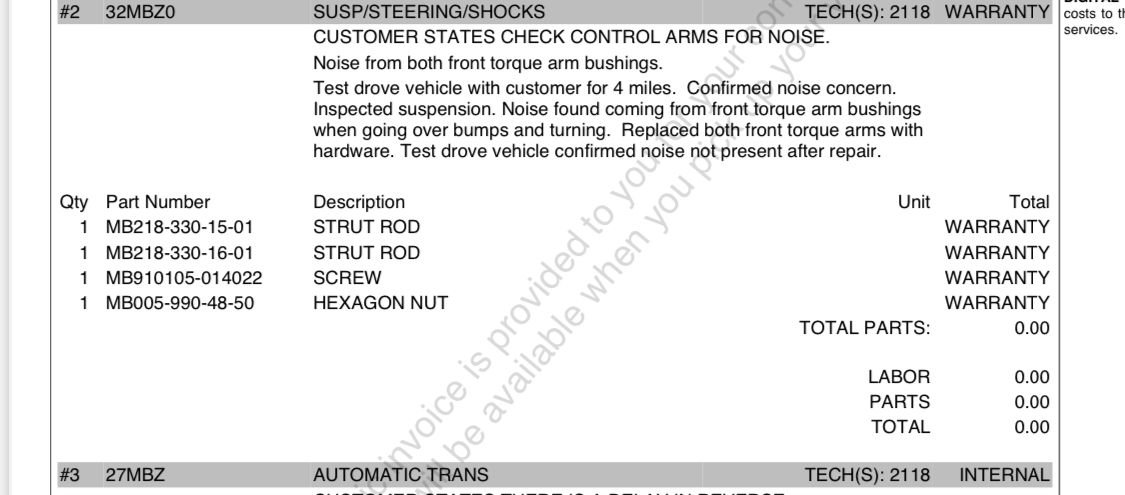

Well here's the update. They didn't find an issue with the lower control arms but rather found failures in the upper control arms. Invoice notes "torque arm" but part # references upper CA.
Maybe check these if you can get to them.

Last year I got estimate for those Strut Rods but when work was done, they replaced the Lower Control Arms (Cross Members):

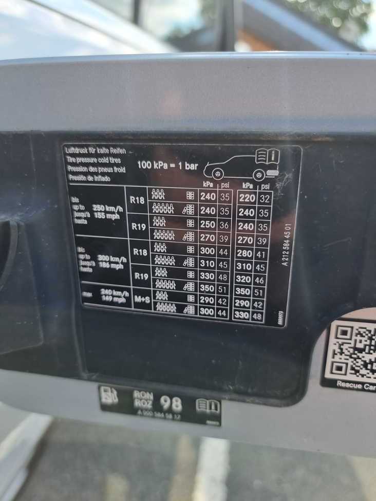

On the gas cap lid it says 35/38 front/rear. Dealer had it set at 35…. What tire pressure is correct for 19”AMG Run Flat tires?

Sorry my mistake I was thinking of my GLE63s which is 45/51.

here's inside fuel door posted on another thread:
