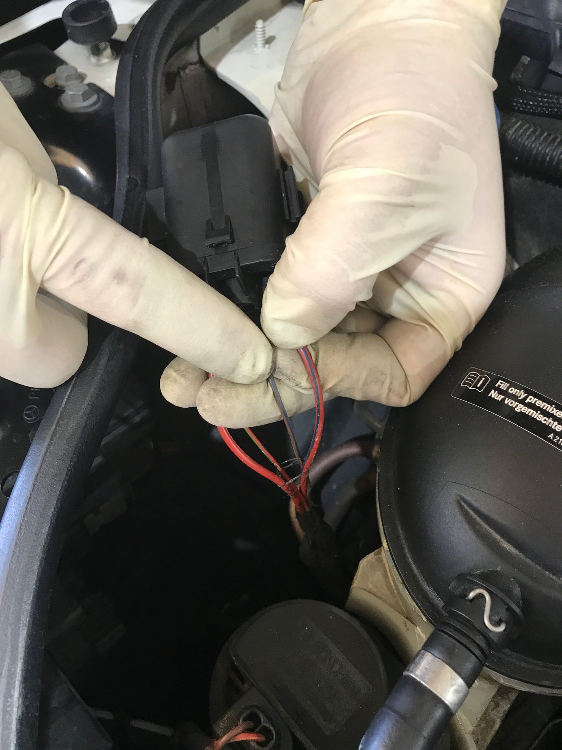

$ 6. Rewire IC circuit to always on (simple rewire)

Trey, Its as easy as pie....
What the mod does is bypass the solenoid to provide power to turn the IC pump on continuously when the car is running.
Currently, the stock IC circuit doesn't open until 114°F I believe.
The solenoid we will be tapping into is the square one just left of the coolant reservoir (split cooled W212)
Step 1, lift the solenoid off the cradle, flipping it over to splay the four wires a part. You are looking for the brown/blue wire depicted here...
Next, you want to remove some of the insulation around the brown/blue wire....
Taking about a 1 ft length of similar gauge wire, splice the new wire onto the exposed wire... solder the wire to ensure a tight connection and then wrap with electric tape and fiber tape if you have it available... this pic shows the wire connected prior to soldering.
In the picture above the wire that was attached came equipped on the other end with an eye. The image doesn't portray it that well, but this is attached to the solenid wire on the other end.
Underneath the solenoid cradle, on the passenger side strut mount you will find a convenient ground point...
In this image you will still see the exposed wire prior to us soldering and taping the connection. The other end gets attached the ground location noted here with the wrench on the nut.
With all the wiring in place remove the engine cover exposing the IC coolant reservoir in front of the ECU. Open the cap.
If all is configured correctly, the simple act of opening the car door with cause the pump to turn on and start circulating coolant. This will be evident by noticing flow in the IC reservoir.
Put the cap back on and re-install the engine cover....
Now, whenever you are driving the car, the IC circuit will be continuously on, helping to reduce IAT temperatures...
On the highway I noticed a very respectable 15-18 degrees above ambient. It was 90 degrees out. I'm keen to see how much an improvement there will be in the cooler months.
Good luck with your project... On a 1 to 10 scale for complexity... this is easily a 1.

Many thanks!!! that's a great write up, really appreciate your help! 👍👍👍
​​​​Cheers
Trev.
