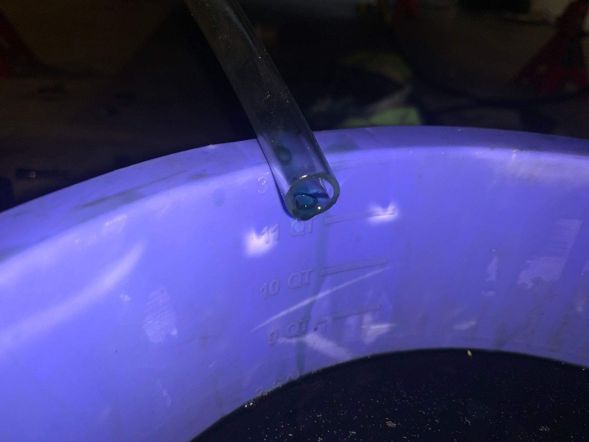

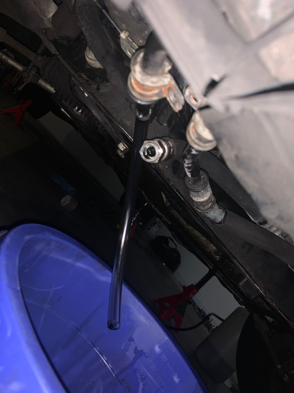

Huge update, all is good. I bought the FCP trans service kit and flushed about 7L of fluid from trans pan and trans cooler. The magnets had a very normal amount of metal particles and tiny too so I’m surprised at how well the MCT protected itself after 70k in possibly original fluid even though I was spinning the rear tires all the time. I also changed front diff fluid but that one was still brown unlike trans fluid which was black. Now the MCT launches like it used and is not slipping anymore. Also took care of a RPM related whining I started hearing right before it started to slip. I’m not sure if the whining was the diff as only 500ml of fluid came out of it when it needs 650ml so it was low but I’m glad I did it anyways.
I can’t believe someone who spent 120k on a car would skip on a $500 transmission service after 40k miles but oh well. CarFax does say recommend services performed at 40k, but says nothing about the transmission. Also nothing in the VMI from dealer. From now on, when in doubt, do it anyways.
