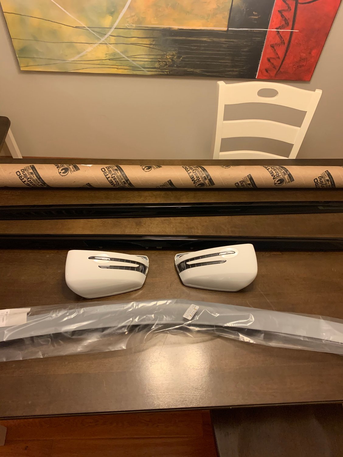

The car came with a factory carbon fiber package which is interior trim, outside mirrors, rocker inserts, truck spoiler, and front bumper inserts!! I bought new parts and also 3M carbon fiber vinyl wrap and have a buddy that installs paint protection film and automotive wraps so the parts will be wrapped soon!!

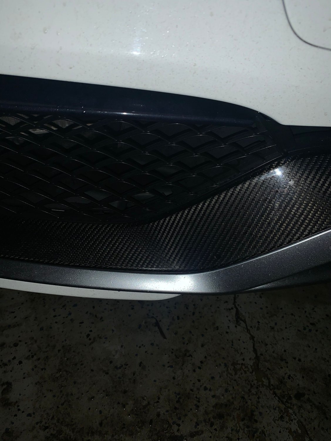

Not a great picture but the front bumper has the carbon fiber!

There 100% is a carbon fiber package from Mercedes for these cars. It is on my window sticker. Will try to find it and post a pic...

My W212 has the factory CF packs. Over time the side mirror and front bumper pieces do peel, as far as I can determine, from UV and road debris. I am in the process of fixing it. In this case, the vehicle was likely exposed to lots of UV (i.e., parked/driven in the sun).

Factory clear wears fast. My car has 50k
factory ‘13 s212 interior and exterior carbon package on mine. Front lips and mirrors need new clear. The rear bumper “insert” was pretty perfect, though had to be re cleared when getting PO bumper scrape fixed. Fun fact is the carbon maker for Mb is listed right on the part in case anyone was wondering. No aftermarket parts are as good in terms of yellowing, but the longevity of the clears are short and should be protected from day 1.
