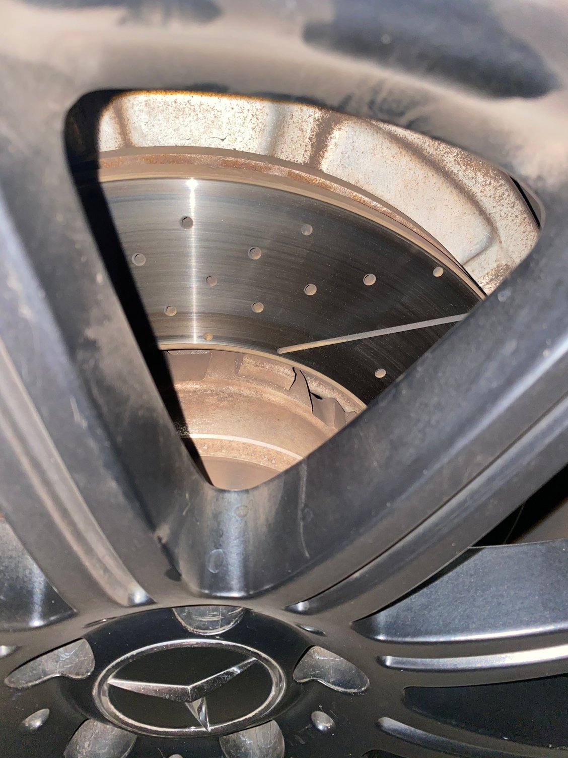

Rotors possibly wearing faster than they should.
Hi guys, so my entire rotors and brake pads were changed about 12k miles ago, now there’s grooves when you run your finger. I’ve never had this happen to a car so fast. Pads are still aboht 70% in the front and 50 in the rear. Is this just how these wear? Sorry for the possible dumb question, just my c63 didn’t have grooves even after 20k of hard driving .
Not sure about the exact milestones however I have a hunch at why they wear fast. I was messing with my front pads and noticed that the pistons don't retract as much as pretty much any other car I've ever worked on. You literally cannot remove the pads until you force them apart with a tool. Any other car the pistons have maybe pulled back to a millimeter or so.
I'm assuming this may have been intentional, so that you get instant feedback when you touch the brake pedal. However it almost always leaves the pads touching the rotors at all times which would cause excessive wear. (As well as a crazy brake dust we all experience)
Oh man I observed the same. When I removed my wheels, I noticed that the pads and the rotors are very very close. Seem they are always touching each other. I couldn’t verify though (maybe next time I can use a piece of paper to see if I can insert).

Old Apr 29, 2021 | 05:06 AM
EckFe1's Avatar
Joined: Jan 2016
Posts: 235
Likes: 69
From: Was, Cali, 95XXX, now Bavaria 91XXX
993 cab, 2014 E63 AMG 4matic T
Looks pretty normal to me. I've been using EBC yellows for 2 years now and I have no complaints. The brake dust is however just about the same as before with OEM. I seem to think that the yellows bite a bit better.
I'm at 54k miles, still on the first set of rotors. I measured the thickness of the rotors when I changed to the yellows and I was .5mm thinner. Meaning original of 36mm, down to 35.5mm.
