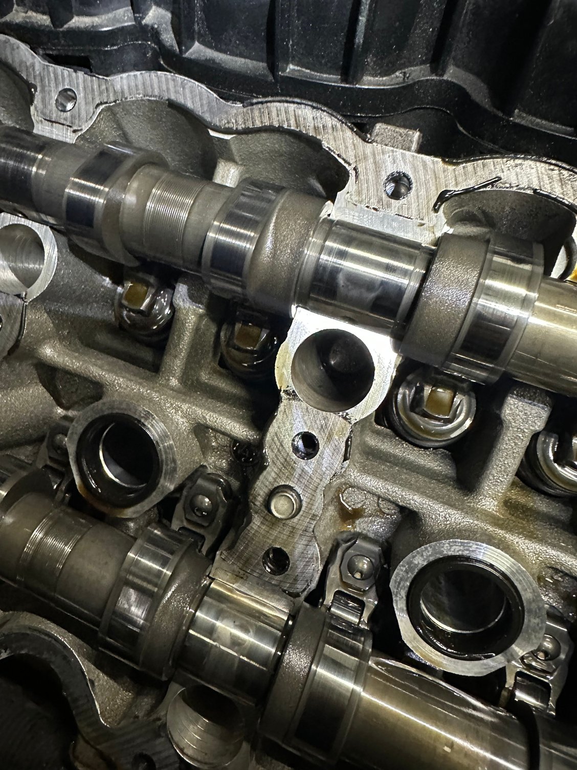

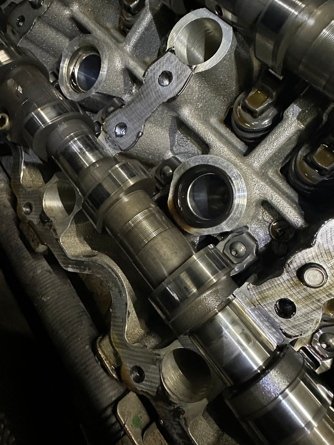

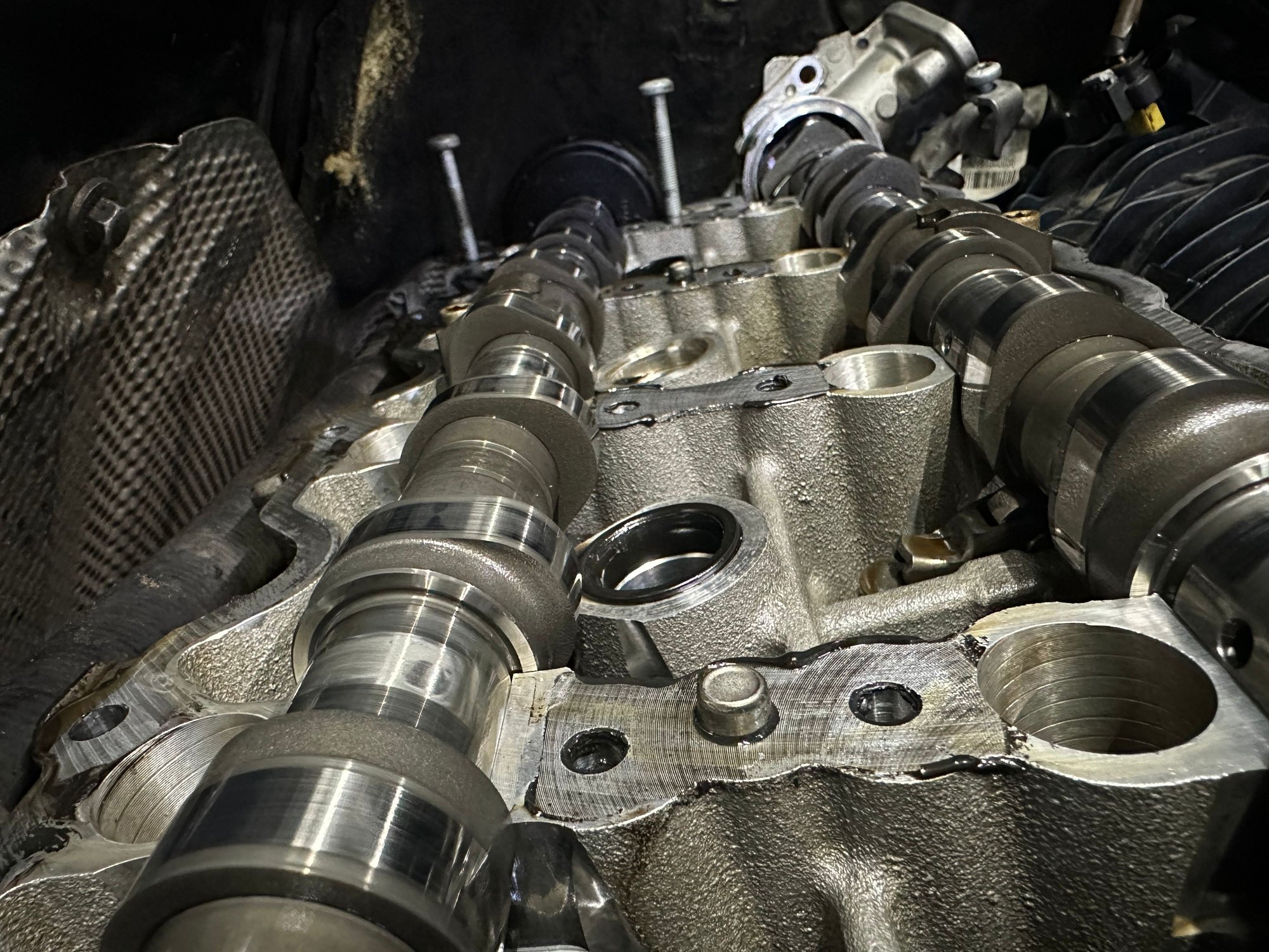

Well opened up the valve cover tonight, and I think my camshafts are done. I am not a engine internals expert by any means, but any input by the guys looking at this thread?
