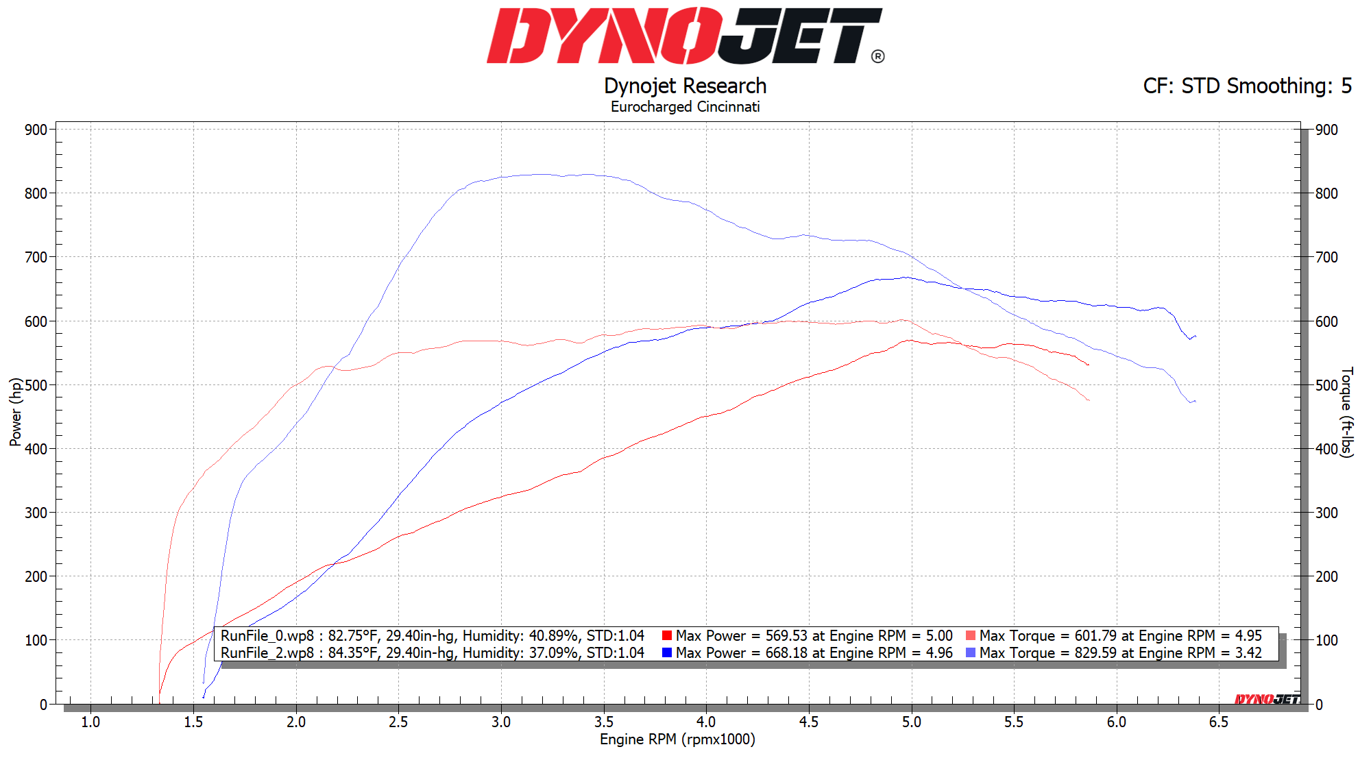

I finally pulled the trigger and had my 2016 E63S AMG dyno tuned at Eurocharged Cincinnati (thanks Duranni, Matt and team). I was on the fence what route to go - did a lot of research and for me it came down to AMS or EC and given the proximity of Eurocharged and that I had been talking with Duranni at local cars & coffee events for a few years, Eurocharged won out.
Once I settled on EC, I had to make my mind up whether to go canned stage 1 tune or dyno tune...I really wanted to dyno...and then once I decided I was going the dyno route, I started researching the flex fuel tune more and decided to go that route with E30 being my goal.
Before I took the car in, I installed the BB intake. Can't say enough about Jose's customer service and support - I was getting a random CEL popping up after install, even after flipping the harness extension around. Jose shipped another harness at no charge just to rule out a bad harness. All has been good the last several hundred miles so I think the issue was my user error, lol. I love the added intake sounds and "ffffshhhh" you get on acceleration/tip off of the throttle too.
I have also since had the Spool Performance Ethanol Analyzer added to the car...had EC Cincy do the install and it's been nice keeping an eye on my blend and being able to use the app to fill up to stay at E30 each tank. For me, I just didn't want to guess what E rating I was achieving so the analyzer was the perfect add on.
As for the tune...it's freaking awesome...haha. Wish I would have done it sooner but I was waiting for my CPO to run out. I daily this car and unless you intend to use the added power, you don't really notice a change. Driveability / accelerator tip in / stop and go traffic daily driving is like pre tune, but once you want the power, what a night and day difference. It flat-out moves.
As the title notes, the car put down 668 AWHP and 830 AWTQ (ok fine, 829.59 AWTQ without rounding lol). I didn't expect to see a TQ number that big...was thinking in the mid to upper 700s...even the EC Cincy crew was surprised by how much power it put down. Also to note...turns out my CPOd car was already tuned as the baseline 569 AWHP and 602 AWTQ is more than stock...but from there the EC flex fuel tune picked up another 100 HP and 200+ TQ.

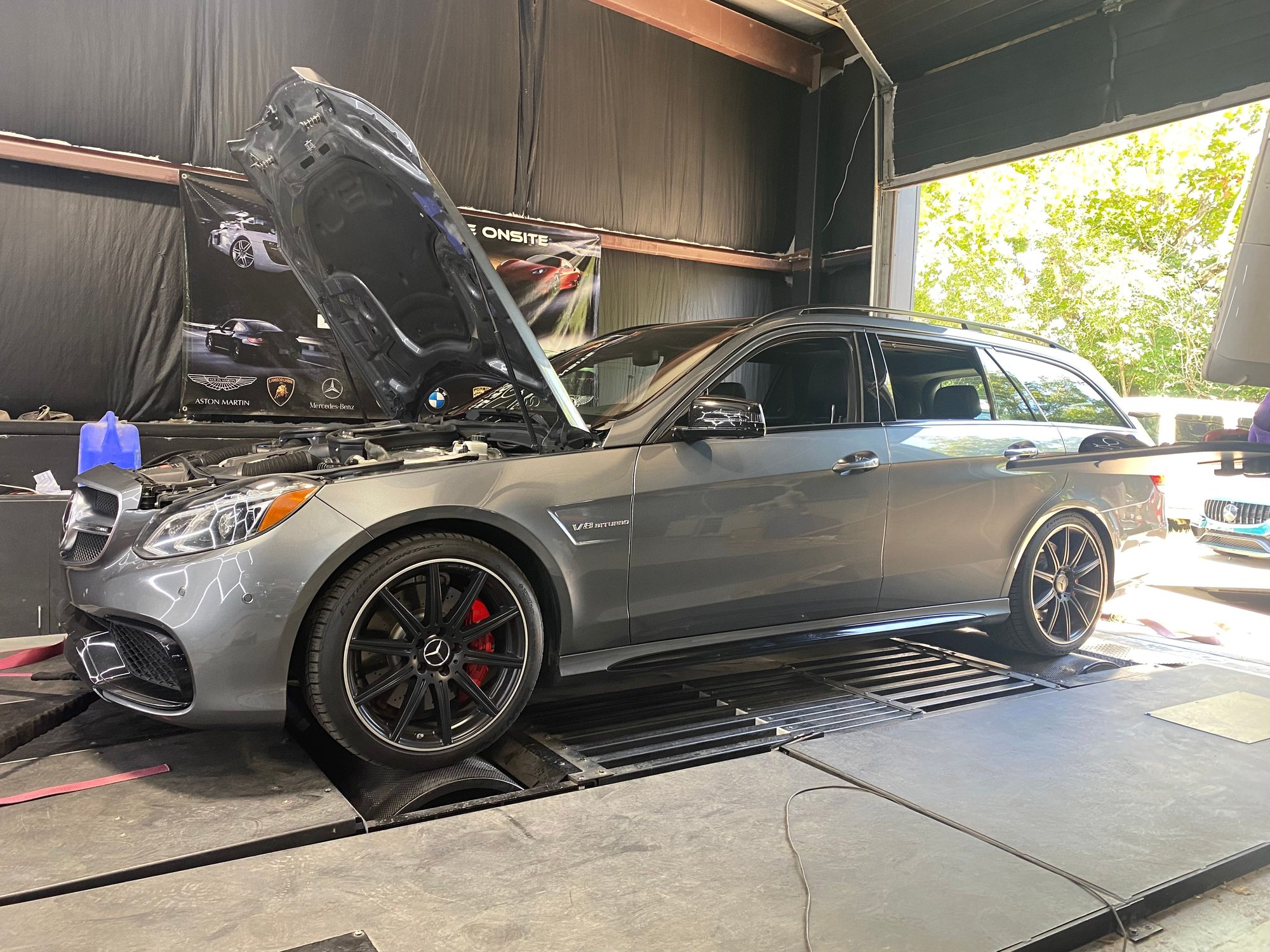

Process was really easy (once the Jag with locked up brakes got off the dyno)...baseline run was done, info was sent to Jerry at EC ATX, new file was loaded, new dyno / data pull completed, and all was confirmed "good" and they had me on my way.
Obligatory Dyno below with some pics of the car as well.

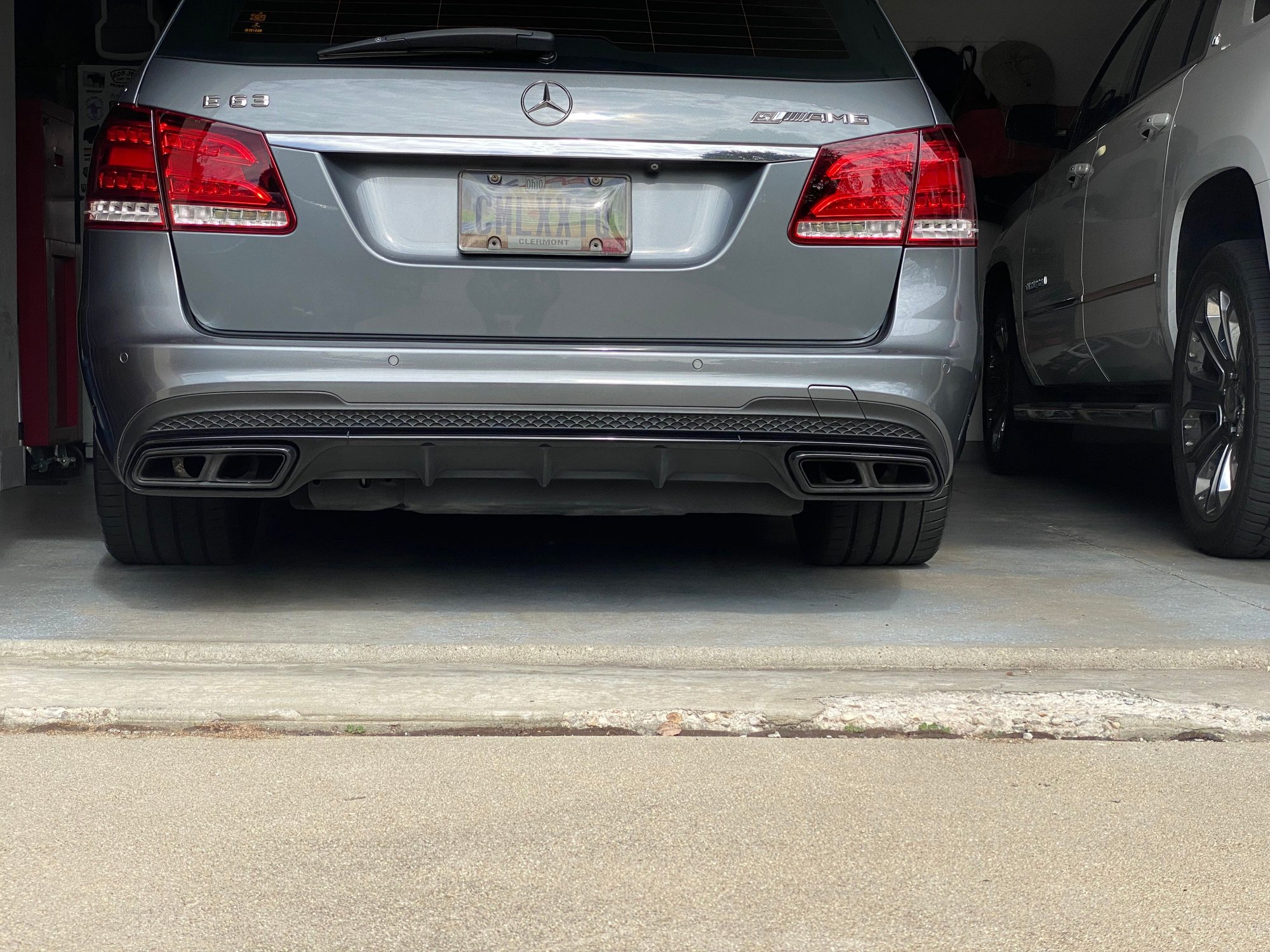

New license plate - CMLXXTQ, roman numerals for 970 TQ

Your torque curve is ...curvy ... Interesting to see that high spike early to mid band... then levels off
have you logged it? Curious what boost levels you're peaking at

I have not logged it...what are all the cool kids using to log? At this point...I'd be interested in logging to see how things are running and to see if there are any further tweaks that might be possible/needed down the road.

So you used 15% drivetrain loss ... I thought we were at 17%
https://www.renntechmercedes.com/ind...crank-wheel-hp
So what's the Roman numerals for 998 TQ?

That torque is scary, congrats on the numbers though, car should flyyyyyyyy!
This is just a personal preference, but I would have had them eliminate 100wtq from the low end. Smoother power, better on drivetrain.

Time for a new license plate, lol...let's see 829.59 / .83 = 999.51. I think that rounds to 1,000.

Once I can data log I may go back for some edits to the tune. Also, the ECU tune was done first...the dyno was run and the full power was noted...then the new TCU tune was loaded. My understanding was the TCU would limit torque specific to what gear you are in...maybe I'm kidding myself with that...but I do know I am not launching the car from a stop often. Have only done it once. All other spirited driving is with the car in motion...
