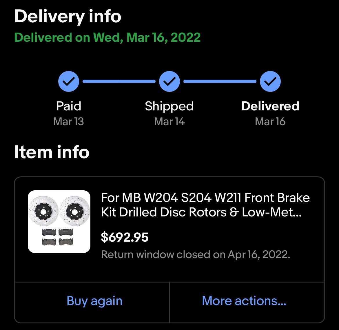

same here - got a great deal on eBay for brembo pads and 2-piece brembo rotors for $670 shipped
Don't see front rotors on Brembo. Got links and/or part number for Brembo rotors and pads on ebay? Thanks.

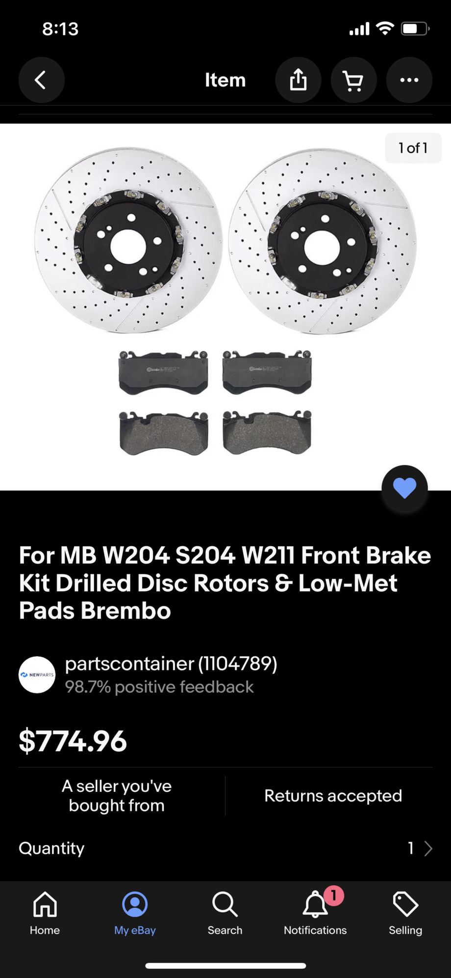

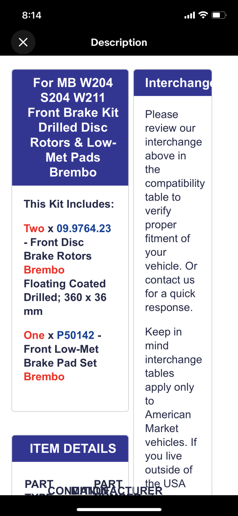

Thanks, thats a great price. Found the ebay vendor link:
For MB W204 S204 W211 Front Brake Kit Drilled Disc Rotors & Low-Met Pads Brembo | eBay
Wow, their 2 Rotors and pads are less than 2 rotors and no pads on FCPEuro:
Mercedes AMG Brake Disc - Brembo 2194210212 | FCP Euro
but you can theoretically send back the rotors when they are ready for replacement (fcp)
I got my sensors and rear hardware from fcp
or eBay ...
https://www.ebay.com/itm/36295913498...mis&media=COPY
