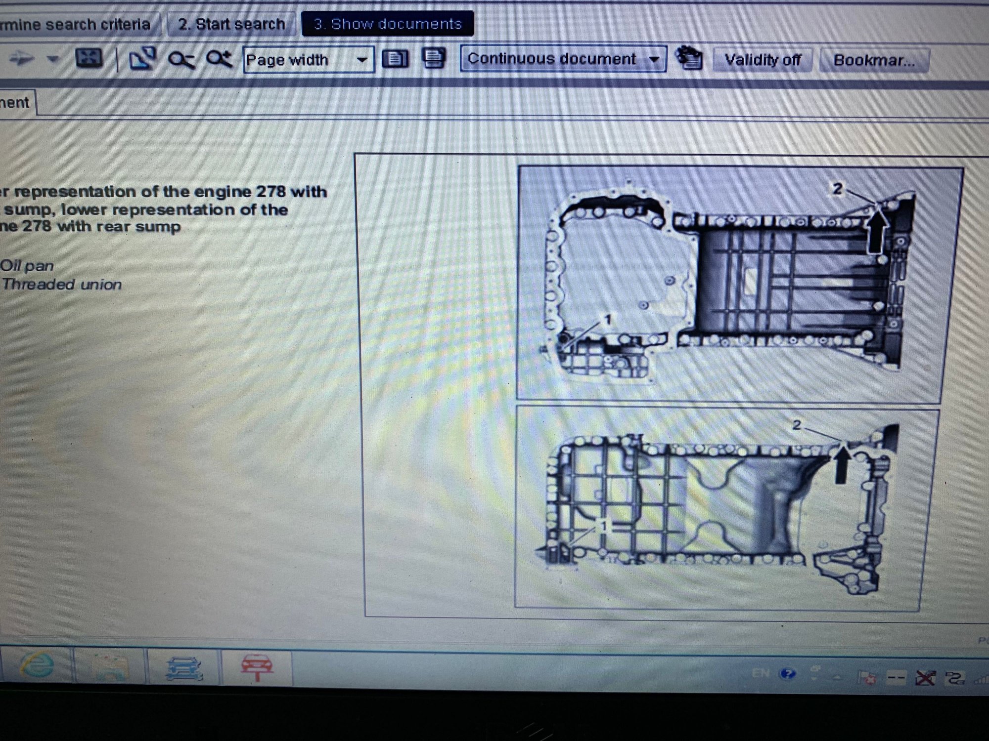

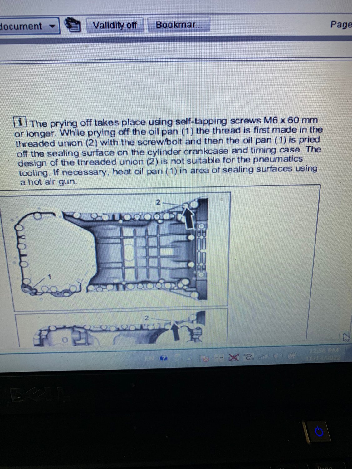

I’m in the process of removing my E63’s oil pan using guidance from WIS, but I’m a little stumped as to separating the pan from the block.
WIS states that you use a M6 x 60mm self tapping screw to pry/separate the two surfaces. But where the f*k do I find that? I’ve seen these for use in wood, but not with a hex head for metal/aluminum.

I dont think they are talking bout a wood tapping screw, just the common m6 with the slight tapper at the end. In reality, any m6 with the correct threads should work.
I have not done this, but i've seen similar procedures. i assume the as the screw bottoms out, it literally pushed the pan away from the block. be gentle

​​​​​​​So they essentially designed it like older brake rotors where you had a screw hole or 2 on them used to pop them free from the hub? That's kinda nifty.
