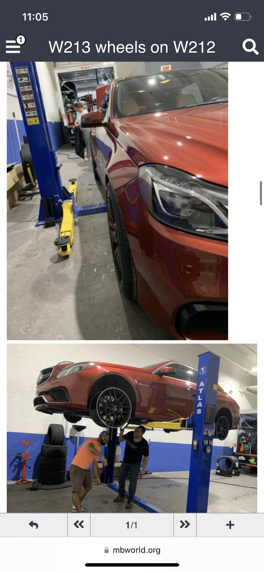

Old Dec 1, 2022 | 12:00 AM
PeterUbers's Avatar
Joined: Jun 2004
Posts: 13,799
Likes: 3,229
https://mbworld.org/forums/w212-amg/...eels-w212.html
Old Dec 1, 2022 | 01:32 AM
Pharaoh1's Avatar
Joined: Nov 2022
Posts: 13
From: NorCal
2016 E63s
Thanks for posting this, super helpful. Appreciate it. I commented asking if they kept the W213 tire package (265/35/20 front / 295/30/20 rear) or swapped tires to a 30 series front and 25 rear. Thanks again.
Old Dec 1, 2022 | 11:23 AM
brfatal's Avatar
Joined: Jun 2016
Posts: 215
Likes: 46
From: DC
2014 E63S AMG
I was entirely expecting to see coilovers w/ camber plates based on that amount of front camber. I'm shocked to see springs instead. I wouldn't think the stock components allowed for that much adjustment.
