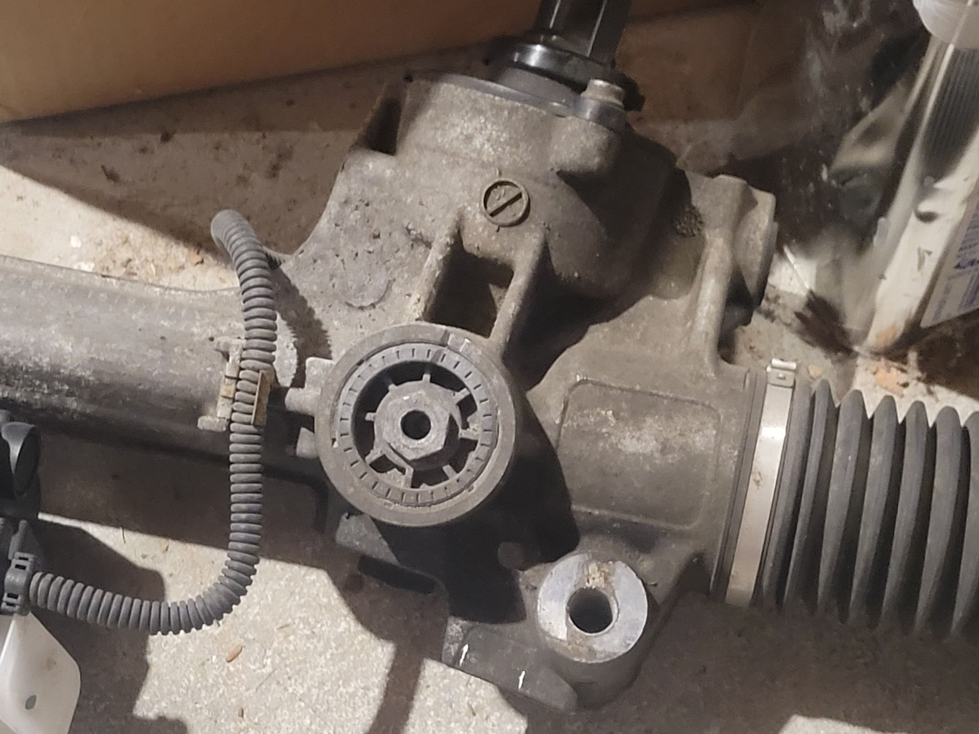

Here is the adjuster.

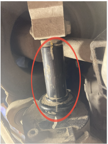

I have a Mercedes-AMG CLS 63 S 4MATIC 2017/12 year with the same exact issue. Steering noise and clunking. I replaced many parts, including the strut mount and the part connected to that but the issue is still there. I thought this would solve the clicking/clunking but it did not, where I assume the noise comes from the steering gear. I'll post some videos below

The first video is strut mounts and unrelated.
The second video looks exactly like my issue but maybe even worse. How precise is the steering when driving on a flat road? Does it feel like there is any slop in the center or does it respond instantly to adjustments?

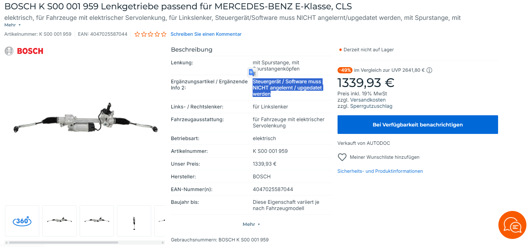

By any chance, did you buy that Bosch steering rack from Germany? I noticed on third-party sites like Autodoc that there was only one Bosch rack available (and it doesn’t require flashing), so I suspect you might have grabbed the last one.

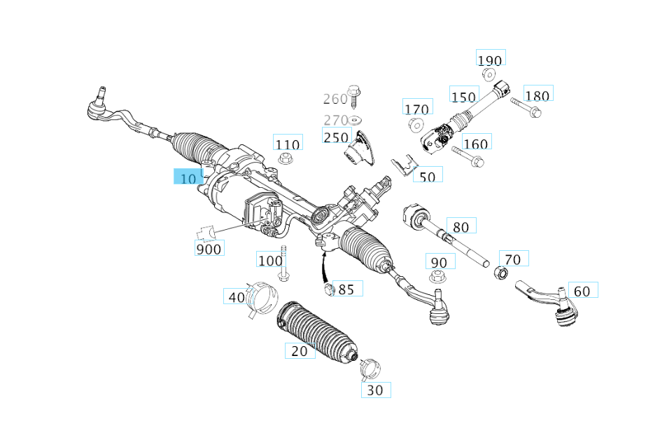

The OEM part number you need is A2184607800. This is the latest, original stock part, not refurbished. If a part number ends in 64, that indicates a refurbished/repaired unit. Those can be fine if sourced directly from Mercedes, but personally I’d avoid them.
The OEM part number you need is A2184607800. This is the latest, original stock part, not refurbished. If a part number ends in 64, that indicates a refurbished/repaired unit. Those can be fine if sourced directly from Mercedes, but personally, I’d avoid them.
Also check part number 150 (A2044620378) and part number 50 (A2124610043). Inspect both to make sure they’re in good condition and that the bolts are properly tightened (they should be, but it’s worth confirming).
Also, I've seen this Bosch Steering Rack, I thought you bought this maybe:
Autodoc Steering Rack Link OEM Reference A2184607800

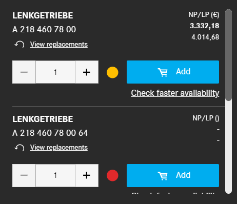

Yes I bought the Bosch KS00001959.
This is the part on my local dealer's parts website (29% discount from list): https://www.mercedesbenzpartsshop.co...UtNWwtdjgtZ2Fz
It is a -64 part. -80 means reman. -64 I think just means like alternate supply, based on a strut I bought recently. They may have a part with no suffix available at the counter, to your point. I could call. But I will be paying straight list price at that point.
Here is the part on their retail website which seems to be the same only more expensive. https://www.mercedesbenzofwarwick.co...Jlc3VsdHM%253D

Numbers ending in 64 or 80 generally indicate refurbished or remanufactured parts, usually done by third-party suppliers. At this stage, they’re not even produced by the original licensed manufacturer, since Mercedes frequently changes suppliers. And wow, prices in the US are noticeably higher than here in Europe. If I were in your position, I’d return the part if possible. If you installed it yourself, a return might be tricky. But if a shop installed it and sourced the part, then you probably can return it. Personally, I’d go for either an OEM original part directly from Mercedes (without the 64/80 suffix), and if it’s not in stock, I’d just grab one from eBay instead.: Steering Rack LHD MERCEDES CLS (C218)
It's also refurbished, but I think the guy knows what he's doing.
