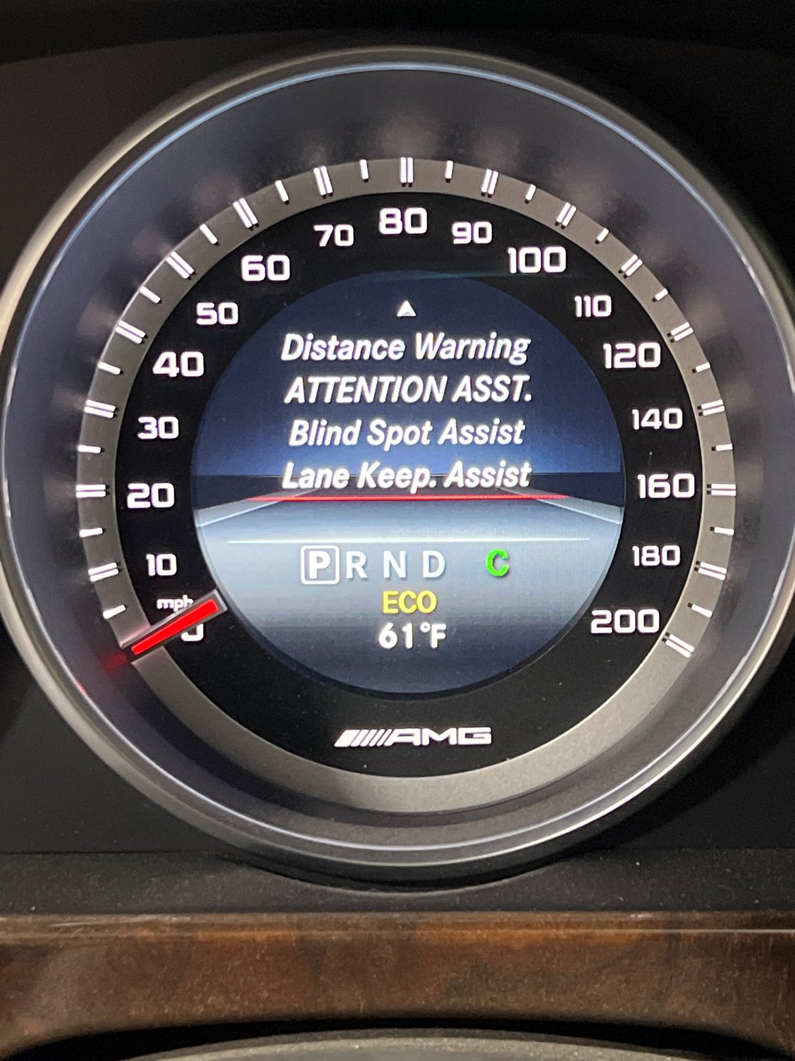

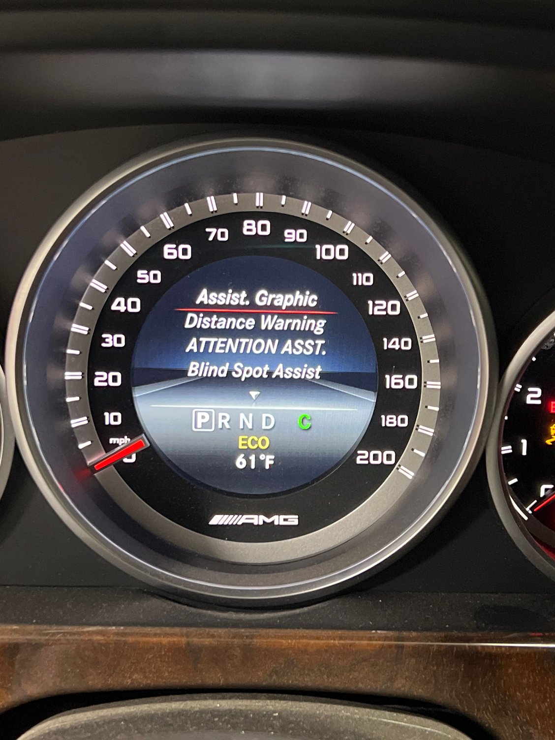

Some of those seem unfamiliar like the steering assist, echo mode, and pre safe brake. Here is what I see on the Driver Assistance screen:

Appears you don't have distronic plus. Still, the fix your looking for is turning off lane keep assist and put attention assist to standard

Correct, I don't have Distronic. I already had lane keep assist turned off so it appears that setting attention assist to "standard" has resolved the issue. Drove around today and the only time it beeped at me is when I was had my left turn signal on whilst passing oncoming traffic.
