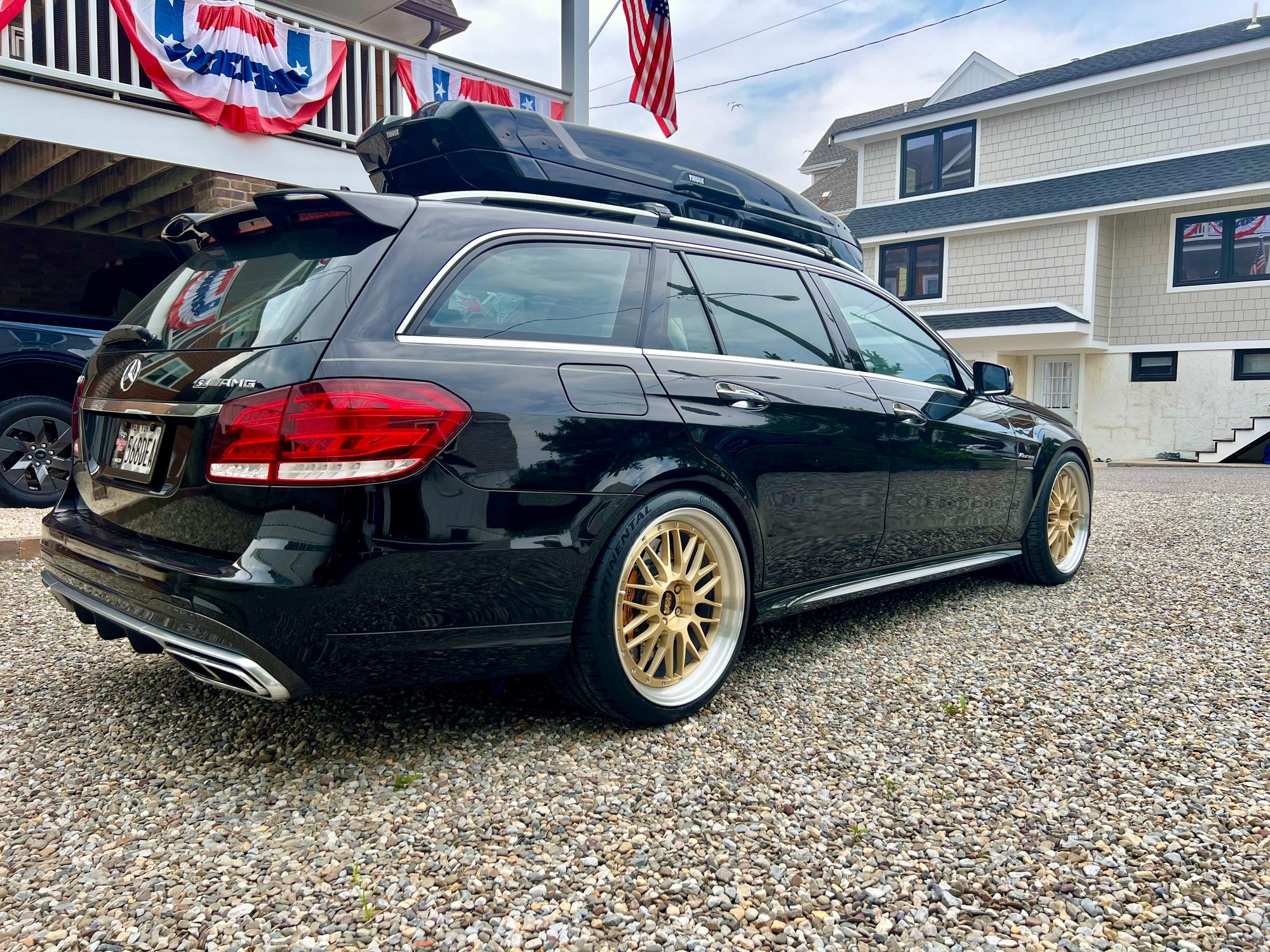

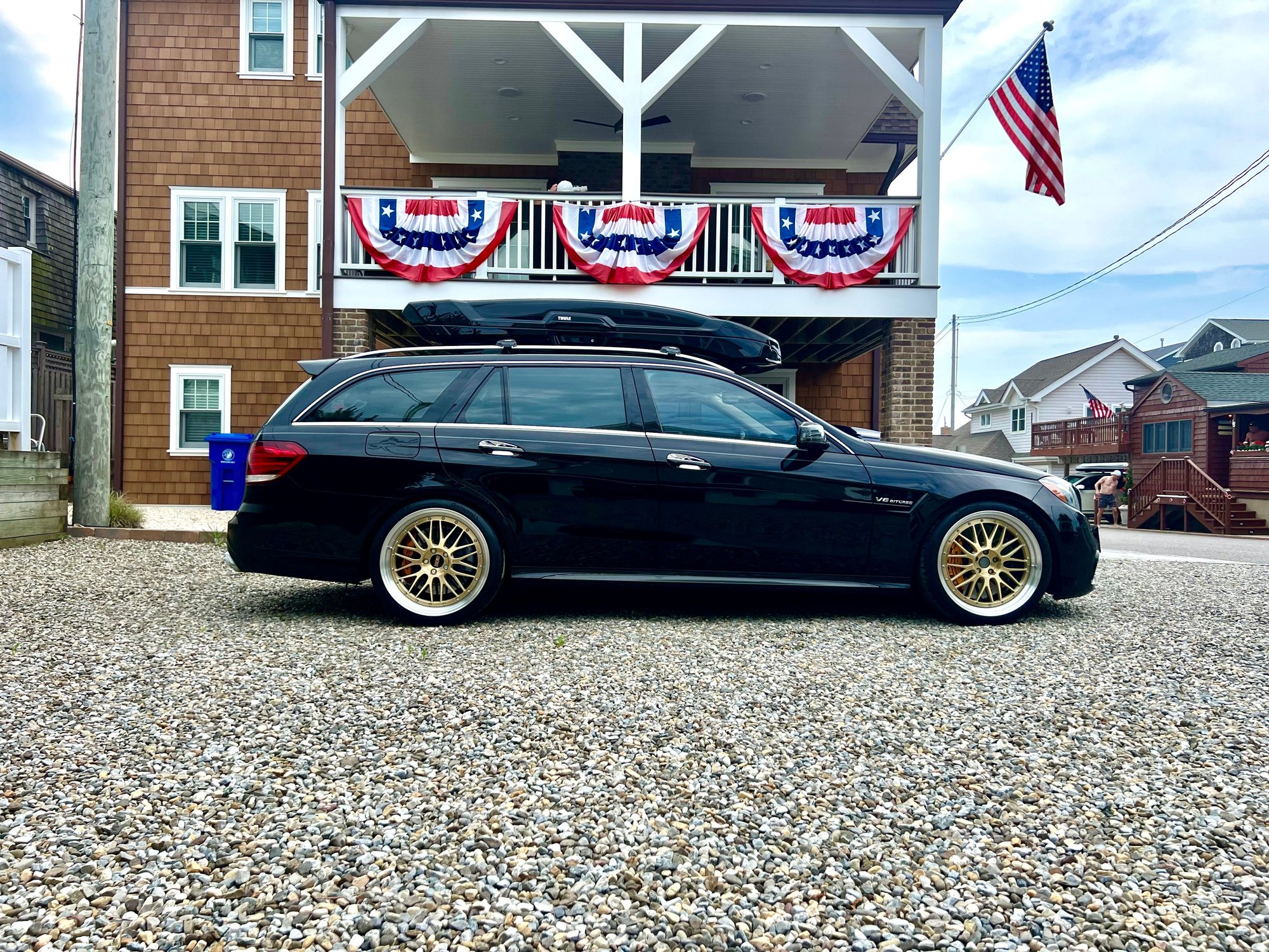

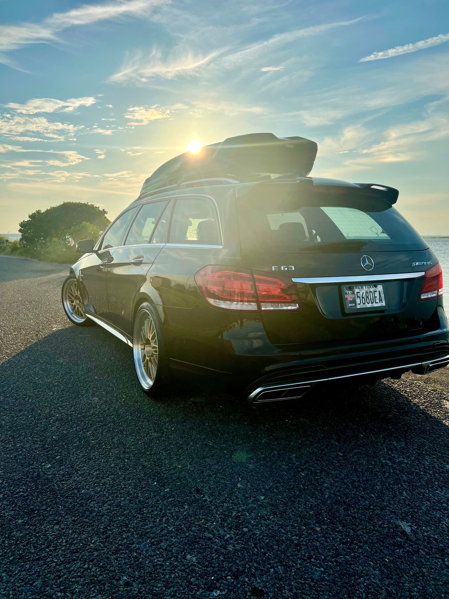

Finally got the new BBS LMs dialed after a couple of trips back and forth across the country. Brushed champagne faces, brushed clear barrels.
Final specs:
F: 20 x 9 et 26, running your Conti Extreme Contact Sport 02s in 255/35/20
R: 20 x 10.5 et 39 in 295/30/20
Lowered on KW HAS
no rubbing whatsoever in either Sport or Sport+ suspension modes (pics are in Sport), even at full lock.
Very pleased with the result.
