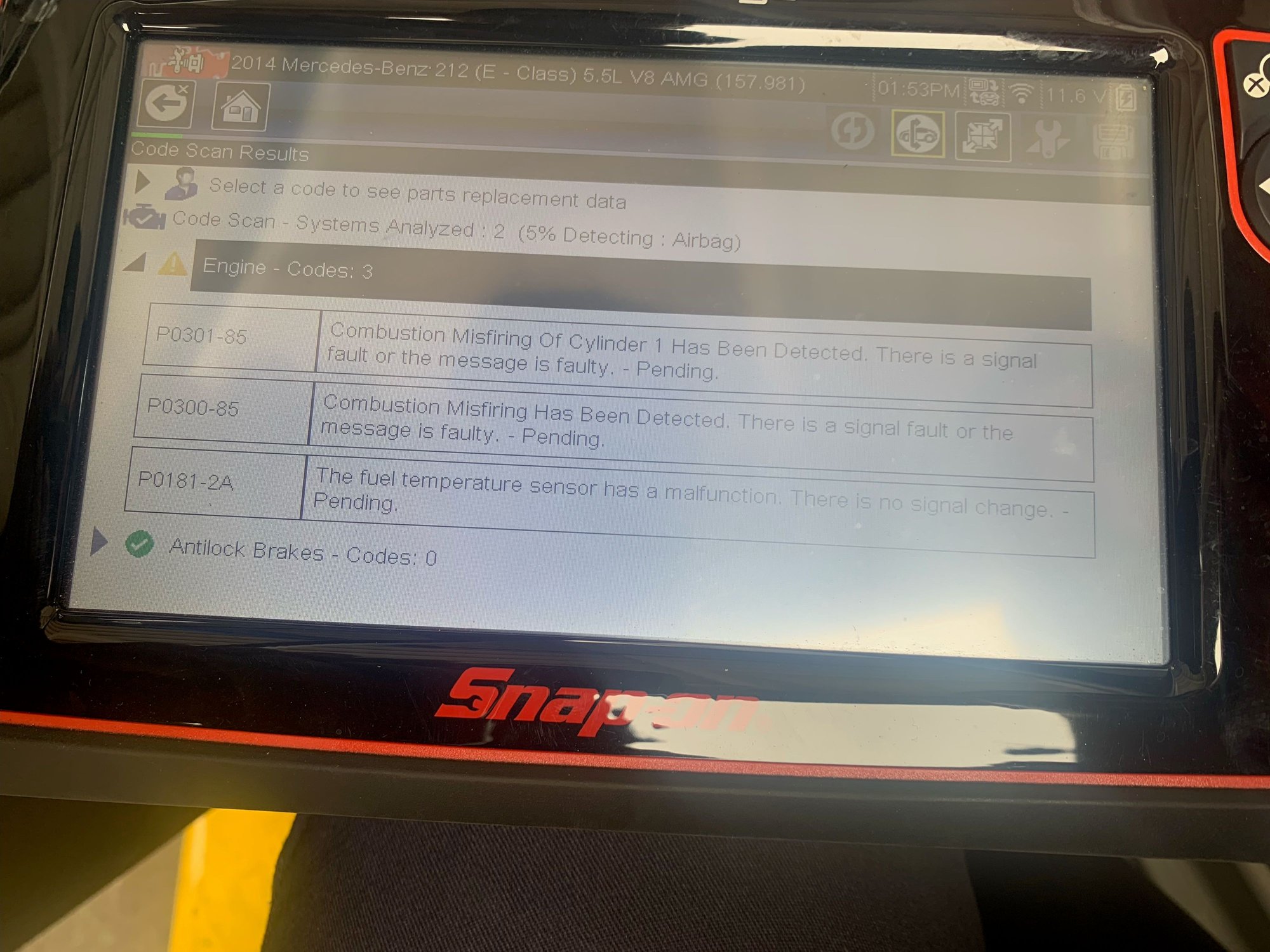

Hi everyone, new to the forum here.
i purchased this 2014 e63 wagon from a Ford dealership in SD two weeks and have not driven it off the lot yet. I texted me sales person yesterday saying I’d be down first thing tomorrow to pick the car up and he says that after sitting for two weeks, he noticed that there was white smoke coming from the exhaust and these were the codes his technician retrieved when they scanned the car. They said they swapped out the cylinder 1 coil and plug. Mind you, no check engine ever came on and the car did not have idling or actual misfire issues according to the sales person.
Then the internal services advisors told my sales guy that that “the Mercedes is had old gaskets that rotted out and liquids leaked into the engine. It’s now junk”
I’ve never heard of such a thing for these engines. The car is CA it’s whole life. And it has 44k miles, not a lot but it certainly has not been sitting all time either.
One of my suspicions is that someone from the dealer is trying to scare me into backing out of the deal because of how rare the car is 😂 (i hope I’m wrong) but has anyone had similar symptoms to this? I haven’t seen any common occurrences of the a faulty fuel temp sensor either.
sorry for the long thread. Just trying to find answers to ease my mind before i take delivery of the car

Wait, why do you still want to buy this car? It sounds like you have a chance to walk away from this car without any financial loss.
Engine needs to be scoped (cylinder scoring), compression test, look for coolant mixing with oil, just to start ...

Welp my suspicion was somewhat confirmed. I had them take the car over to the MB dealer and it turns out they overfilled the oil by 5 quarts when they did the oil change during the used car safety inspection. Turns out the used car manager was put on disciplinary leave for getting caught doing this to another car so it could sent over to auction and make a bigger kick back from the auction company. Glad I didn’t get scared out of this deal
this just became shadier
did the Benz dealer do a full ppi? And they said all is good? What all did they inspect?
if so - congrats on what seems like a great deal. I'm glad you feel validated.
also what happens if you overfill an engine by five quarts? Does anything get affected?
Overfilled by 5 quarts? So, someone put 14 quarts of oil in it?

So this is what i had gathered from my sales guy who was really thorough through the entire ordeal. The used car manager had more incentive to ship cars to auction than to retail it because he was supposedly receiving kick backs from the auction house to send cars over. They caught him doing this to another car when one of sales managers why he was “adding oil to another car after the oil change was already just performed to it” they did some more investigating and placed him on “disciplinary leave”.
When they sent the car over to the MB dealer, i asked the service advisor that was handling it to talk to me directly since i was going to be the owner of the car. After they found out it was filled to about 13.5 quarts of oil, they re did the oil change, cleaned out the PCV valve, replaced the plugs and did a carbon clean all under the selling dealers tab. I offered to pay for a compression and leak down test and spoke to the shop foreman who assured me the car is solid they did their thing. The selling dealer ended up paying extra for that also and for them do to what was equivalent to a CPO inspection.
all in all. I feel good about the whole transaction and glad i didn’t walk away so quickly. It took an extra week for the transaction but I’m glad i got the MB dealer to give their stamp of approval. I know a lot of people would’ve ran the opposite direction the second they’re heard of white smoke coming out of exhaust. But i also work in the same line of business and wanted to make sure everyone on their side crossed their Ts and dotted their Is before i walked away, which i could’ve at anytime. And being in the car dealership business for over 20 years, this is definitely a “new” for me.
