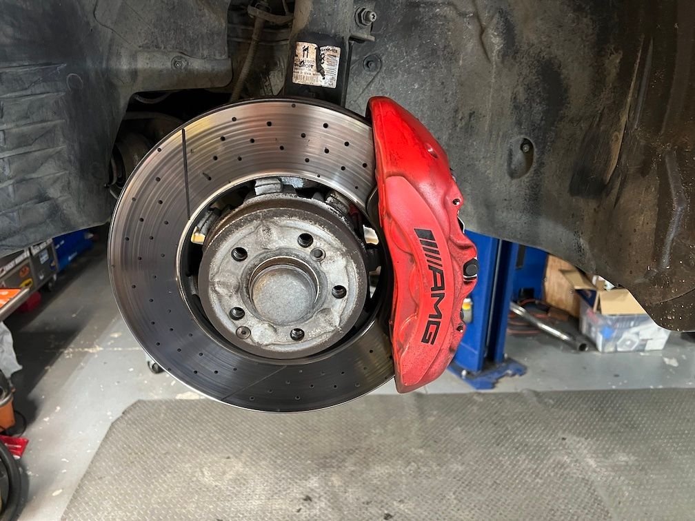

Here is my 390mm installation.. plus belts

Update on the 390mm..
big difference, thing stopps so much better. Definitely worth doing
