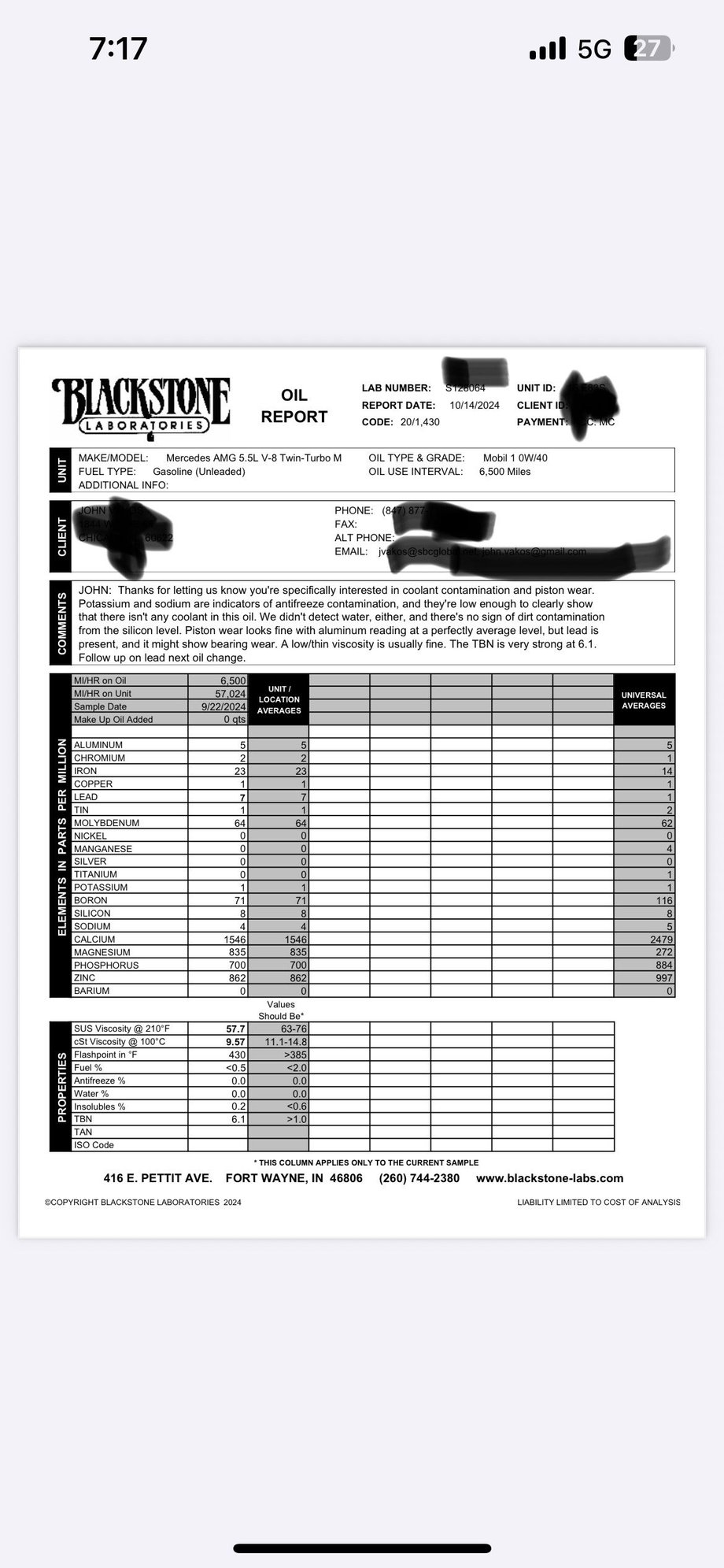

Originally Posted by jvakos
I think this Blackstone Laabs thread is gonna be very interesting. Now that these cars are older and most M157’s are showing signs of mild to severe cylinder scoring depending on if you’re modified or stock, oil type, climate, driving style, mileage etc.
I would love to see more owners post their Blackstone results here so we can see what oils and maintenance scenarios are most effective at minimizing cylinder scoring and maximizing engine health.
Mine is a 2015 e63s with 60k miles and tuned about 35k of those on ams93 dyno tune and few times a year ams100 dyno tune. Just replaced my spark plugs and coil packs and definitely found signs of some scoring in three cylinders but nothing that impacts the performance or causes oil consumption or any other noticeable issues.
I’m not a mechanic so about all I’m able to do is replace plugs and coils and do a borescope and send my oil to Blackstone which I wanted to share here…. Using Mobil 0w40 change generally twice a year with under 5000 miles.
attached Blackstone report - who else has reports to share/compare/learn from?
Are you sure you put in 0w-40 not 5w-30? The viscosity looks too low for a 40 grade oil from the report
I didn’t notice that was low, but yes, it always had mobile 0W40 I’ve got jugs of it in my garage since I have 3 other MB’s that I change the oil on
what oil do you like/use?

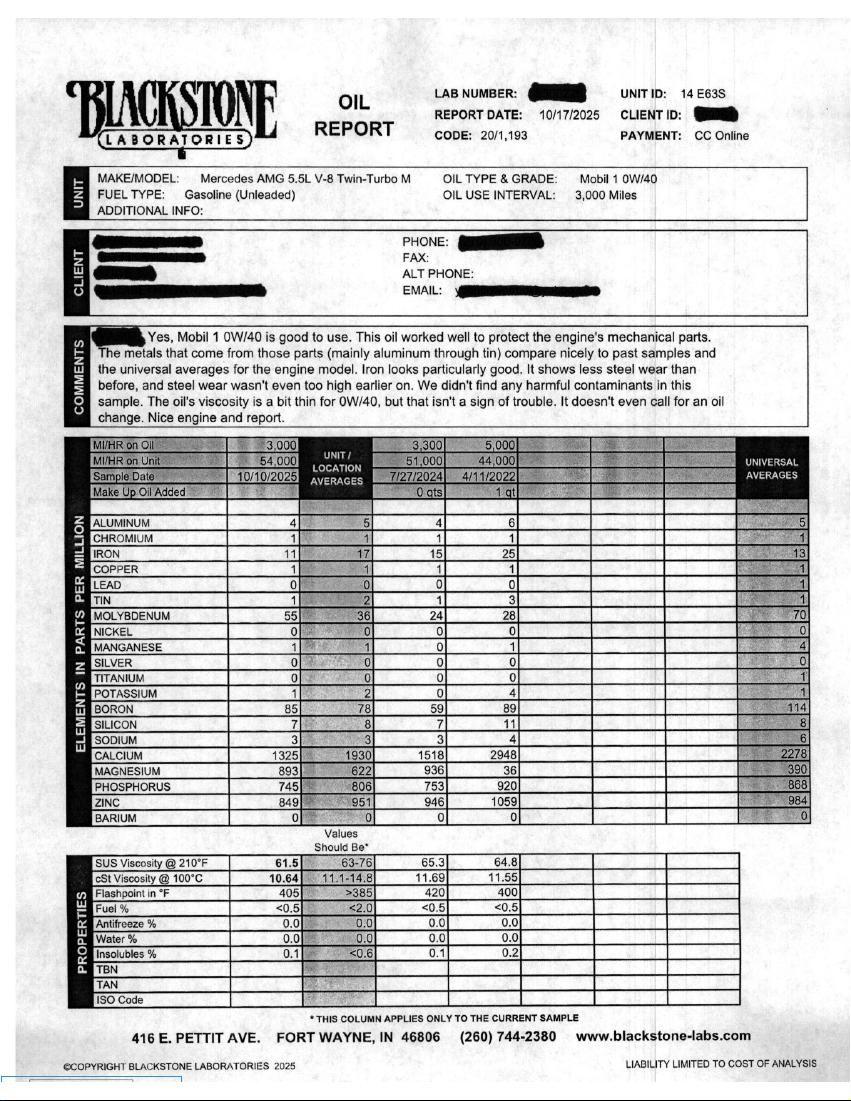

The first 2 oil changes were done at the dealer with their spec oil ?
This time I changed the oil myself using Mobil 1 0W40 without any additives
Driving style:
Wait until the car is warmed up
Occasional bursts of speed --- no launching or extended highway pulls.
Always open up the hood to let the engine cool down
What about the viscosity, switch to ?
Glad to see the metals not only got better but are on the lower side of the norm too
Very pleased with the report.
Also it seems like Mobil 1 0W40 stays in thinner side so I agree with CaliBenz in trying out M-1 5W50 to get the desired 0W40 effect
In my case,
since the car is garaged and rarely get driven in winters 5/50 sounds good to switch to
Driving style:
In my case,
The ECU on these GDI engines are really sensitive to smooth oil pressure plus stable viscosity for predictable timings.
At only 3000k.Mi your W40 oil sample tested in the W30 range.
The effective spray cooling begins in the upper 15W-40 range ... such that 5W-50 offers a small reserve margin according to brand/type/viscosity and driving style.
(Motul, Amsoil, M1.Supercar, RedLine, ...)
Today I'll be upgrading to non "MB-Approved" MOBIL1 "Supercar" SP 5W-50 to see how its viscosity runs its course. Advanced specs are promising.
(MB factory stock setup is good)

The real lesson here is, no one oil, spec, or change interval works for every single vehicle/engine.
The analysis will help you pick what works for your use case. For environmental and budget reasons, the less frequent your changes are, the better. But, not every engine or use case is going to be able to see 10k mi changes, or 6k mi changes.
I would not be afraid of a car that saw longer oil changes if there was analysis reports to support the longer intervals.

It could be good to mention the API rating of the mobil one oil used. The shear stability has increased as it went from SN to SP. It went from an oil I refuse to use to an oil id try again.
Are people seeing the shearing of this new 0/40 Mobil SP?
Regardless, 5/50 as mentioned above is really the best.

I can't justify 5w-50.
Just switch to a good 0w40/5w40
By good I mean fully synthetic with Group IV and Group V only. Not liquidmoly type of scam.
I personally went with redline. Really high HTHS and on the thicker side. Like 14.7 or something for 0w40

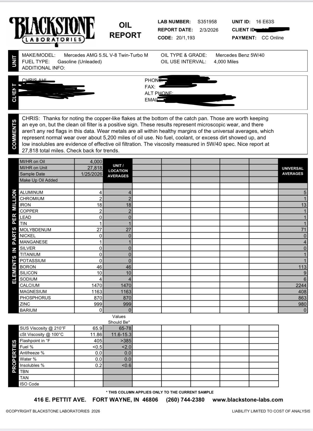

Old Feb 4, 2026 | 09:45 AM
  #74
PnwGLS's Avatar
Joined: May 2025
Posts: 12
2024 MB GLS580 , 2016 E63 S AMG Wagon, 2011 BMW M3 Sedan
I figured this was a good place to add my oil analysis result rather than a new thread. New to me 2016 e63 wagon with 27k miles (purchased on cars and bids in December)
I had a concern about metallic flake I found in the catch pan which is noted on the report. Filter was perfectly clean (cut open and inspected inside and outside). This car is always dealer serviced so I expect oil was always extracted from above and debris over it’s like was never fully cleaned. My dealership tech confirmed the same even though I understand WIS instructs to drain oil from below. Who knows. In 3k miles I’ll change again, and we’ll see!
Later this year I might have my spark plugs changed and have the cylinder scoped.
overall seems like the analysis is fine. Time to drive it!
