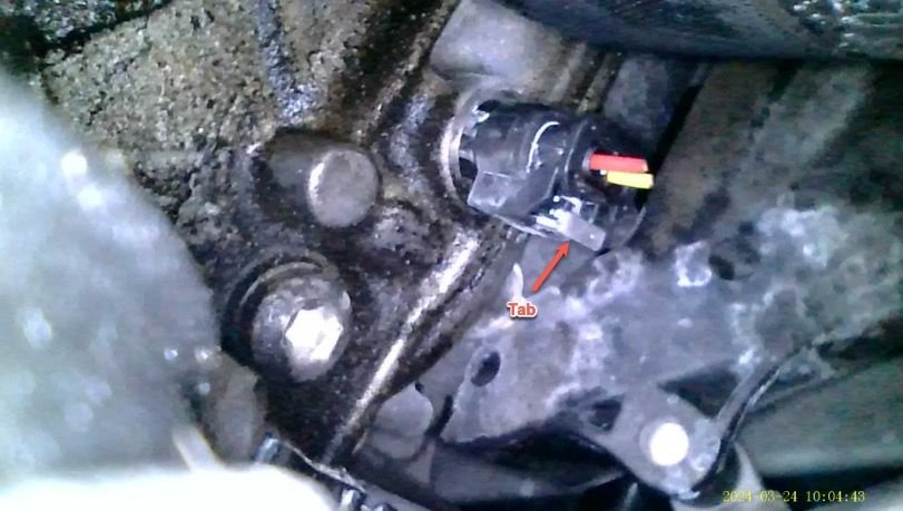

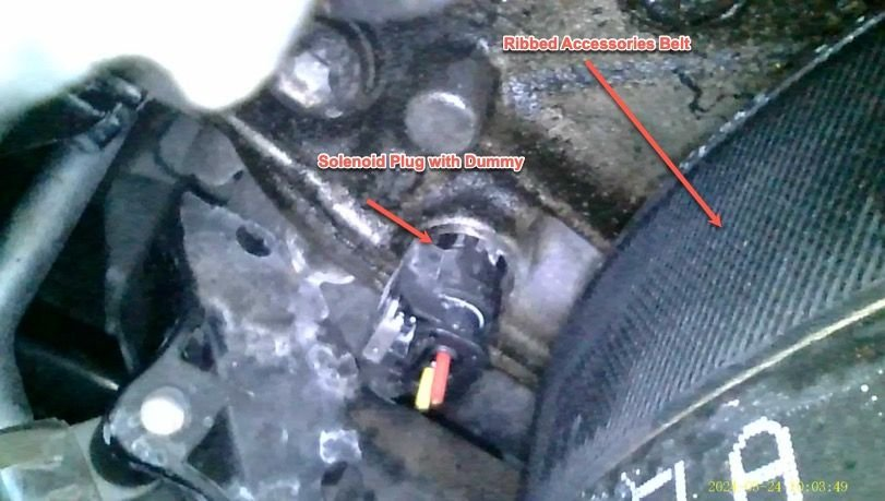

just zip tie it nearby to prevent interaction with the crankshaft balancer.
Personally I left the plug unprotected... I think connector matched the VVT 2-wires "Magnet/solenoid" pigtail so you can use an old one there with wires cut out from pigtail.
Improvements will be caped by your choice of engine oil viscosity.

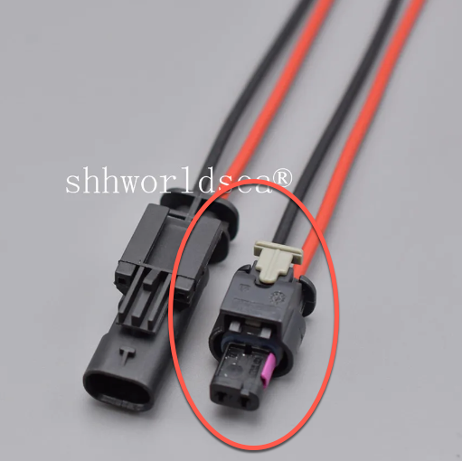

Look at post #1548 in this thread. https://www.aliexpress.us/item/22518...Cquery_from%3A
I used this to protect the connector to the actual inside solenoid. AliExpress. Get the 2-wire connector.  Mercedes-Benz A0225451926

Recommend using the aforementioned connector to plug the engine side but also like other forum members mentioned, recommend using a dummy oil pump solenoid outside the engine plugged into the live ECU connection, that way you also get no more codes.

I did the same.
