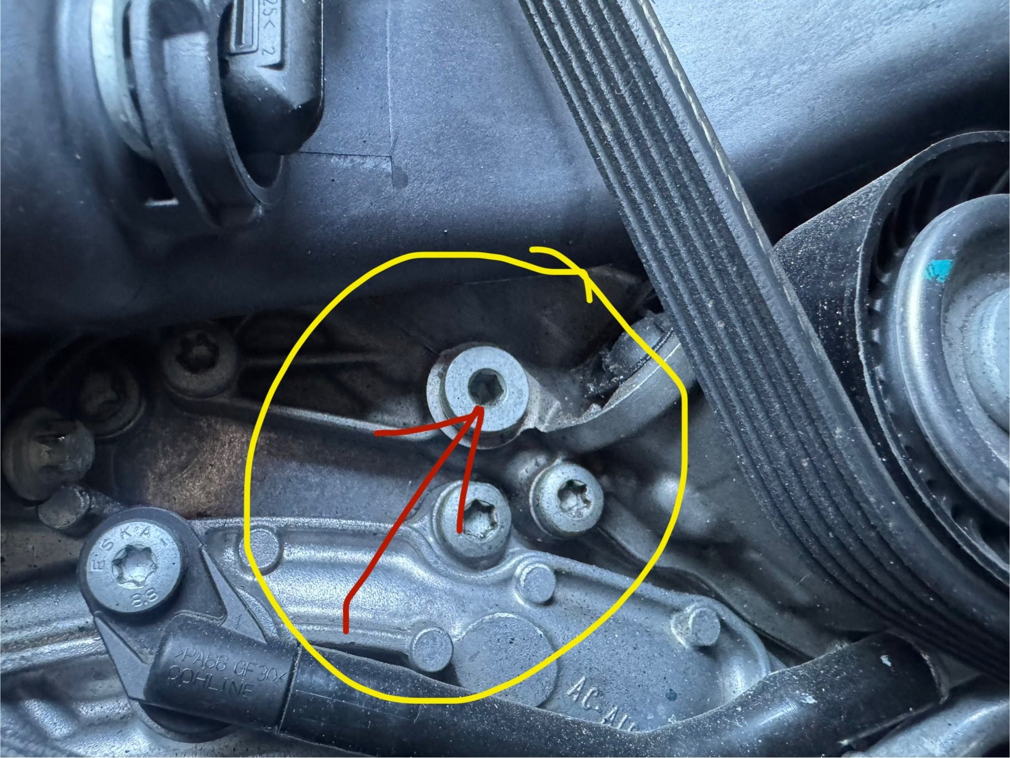

2014 m157. Oil port on the lower oil filter housing

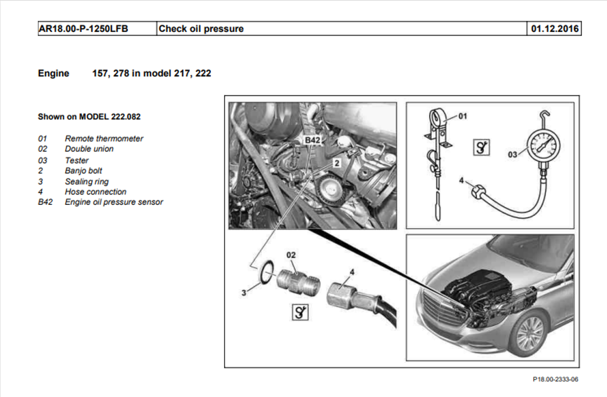

While I do not have an E class, this oil pressure solenoid applies to every m157. The "dummy" harness (another spare solenoid or a resister) is required and not optional on the s class as it trips a hard code with a CEL same code, but because of the oil pressure switch and the changed oil filter housing (it is the same housing just has the block off bolt removed which is the test port for the sensor) it has issues and yells at you. Removing it should let you test it no matter the chassis.
The part number you sent over was for an m156 oil cap. Mercedes makes them for the m156/m159. I am not 100% sure if it works on the m157. Looking at the documentation on wis it does show you can do the block off bolt removal to mechanical oil pressure gauge no matter the chassis. I've linked it for you.
File Type: pdf

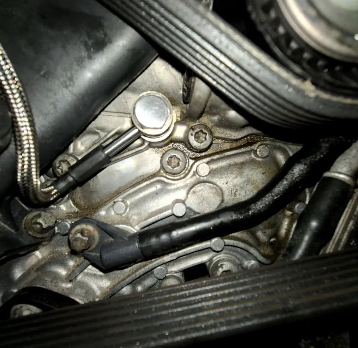

Originally Posted by Cifdig
The 63 motorsports kit I referenced earlier replaces that plug with a banjo bolt and a short section of braided line used to get to a less confined space where a normal pressure sender is connected and then wired to gauge in the cab.

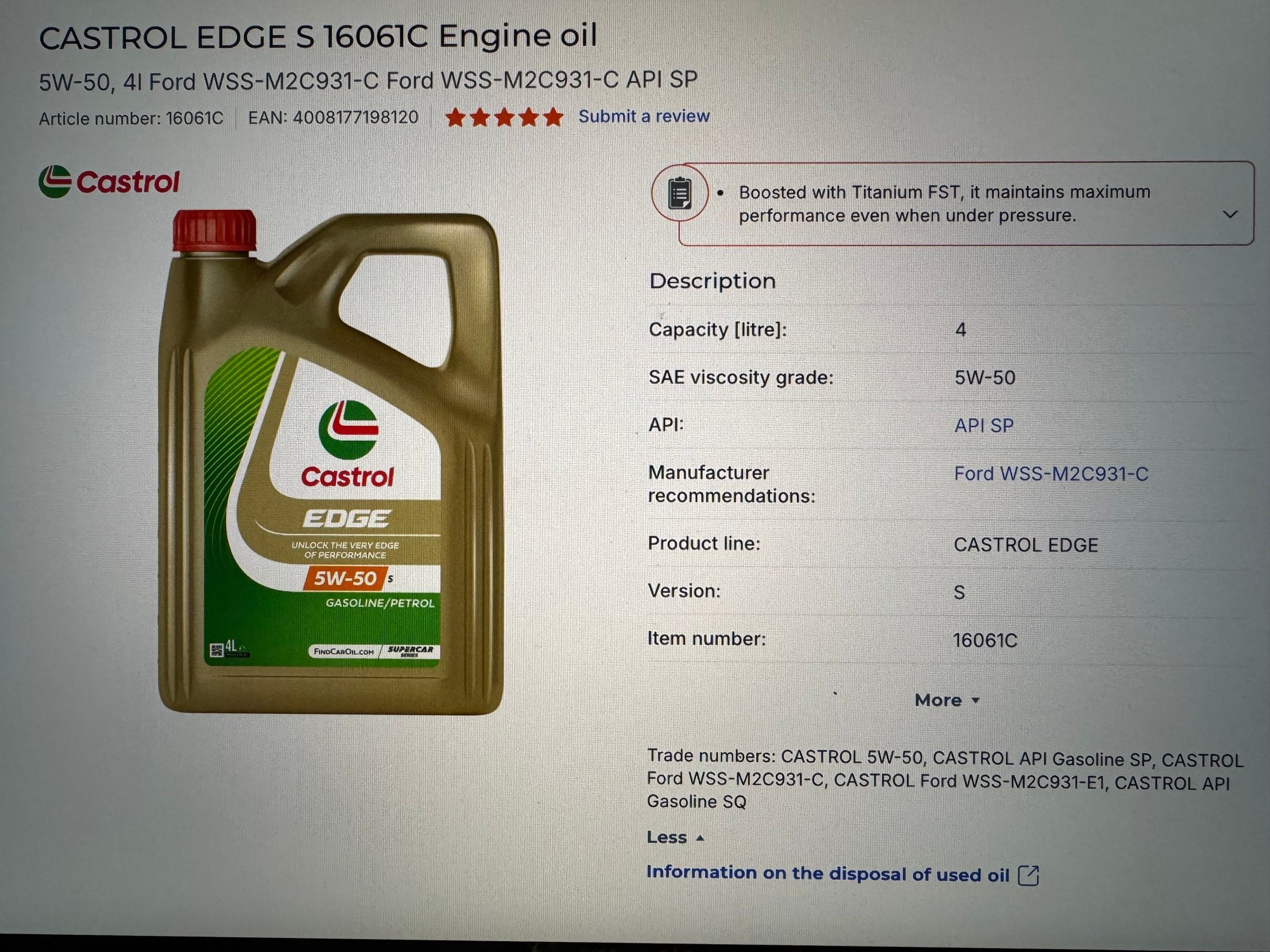

What do you guys think about this:
And here is some info about that:
https://msdspds.castrol.com/bpglis/FusionPDS.nsf/Files/A2190794B97D628580258D0700244A28/$File/wepp-csgw3c.pdf

Sorry I definitely was wrong. I dont know how I totally missed this info. I thought it only applied to certain engines ad not the 157. AND I linked for the wrong model which I hate doing...! In a general description they listed the cap on a 157, but now I do see they have a gauge package.
m157 cap - https://www.63motorsports.com/afterm...l-filter-cover
Has anyone used this? https://www.63motorsports.com/afterm...pressure-gauge
woops, I stand corrected. Thank you for informing me.

Originally Posted by PekkaH
What do you guys think about CASTROL EDGE 5W-50 SP
And here is some info about it:
Go ahead, test drive your selection!
Castrol Edge 5W-50 SP is a Group III oil.
Viscosity will be around for some time.
A Group-IV 5w-50 SP formulation would give you a superior temperature stability:
  • Motul Power
  • Amsoil signature
  • Mob1 Supercar
  • (Redline)
  • (Ravenol)
You can use cheaper oils as engine rince off for shorter mileage like 3kMi. It takes time to clean-seal rings so long they quit building additional layers.
-- The difference will be cooler, cleaner sealed pistons rings.
-- Less oil consumption deposits onto valves & chamber surfaces.
-- Effective spray cooling at driving Rpm will get oil hotter than coolant.
-- Engine heat will eventually get under control.
-- Cylinders contributions will eventually balance out for responsive ECU fuel mapping.
-- Engine vibrations will smooth out at all Rpm signaling it is firing on all cylinders instead of laggy lean throttle response.
Enjoy experimenting your upgrade

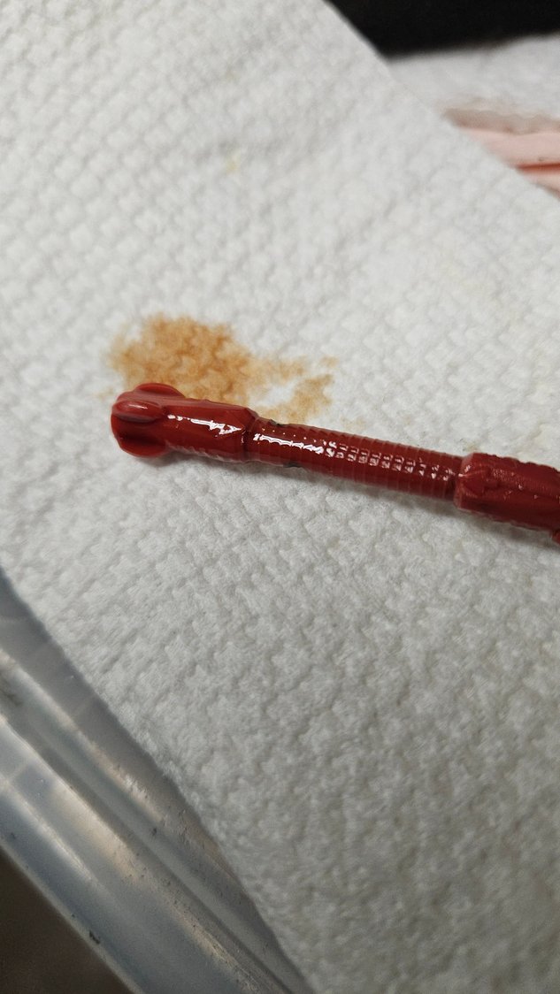

Pulled the harnesses off my camshaft magnets (C43 M276) and theres a small amount of oil on the magnet side but not yet on the harness.
Presume best course of action is just to replace the sensors, solenoids, magnets and add the sacrificial harnesses?
Is there anything that can be done at the ecu harness side to help delay it?
56k miles…

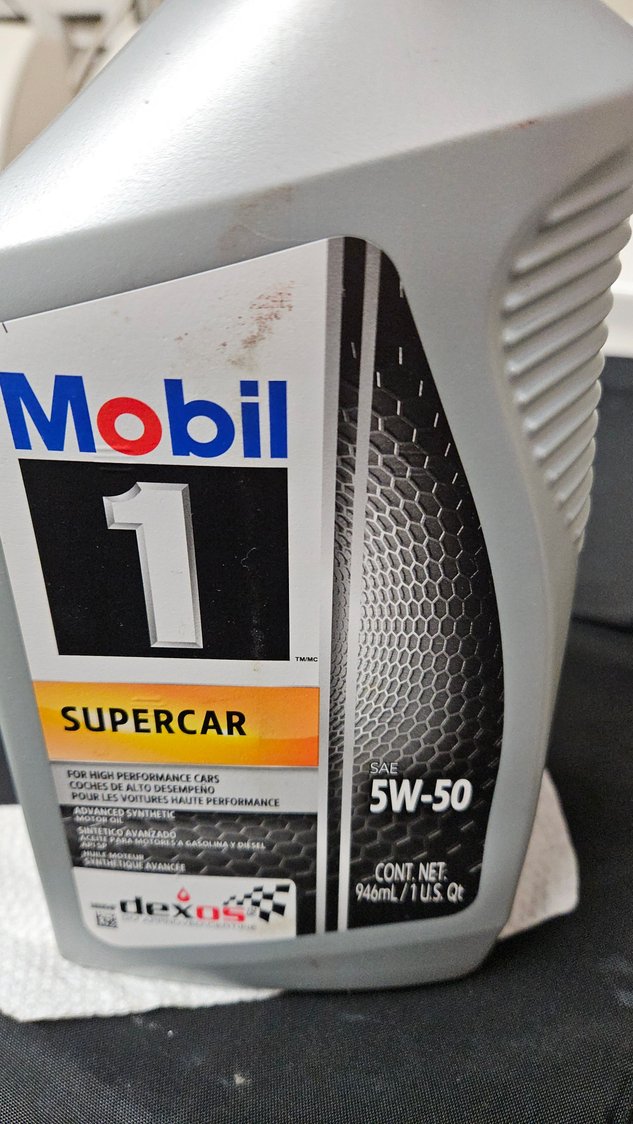

Here is my oil upgrade after 2,200.Mi @79kMi:
Mobil1 Supercar 5W-50 API-SP
Mobil1 "Supercar" 5W-50 API-SP
Possibly my favorite oil so far
Let's see how viscosity holds towards 5kMi ??
2199 Mi oil service + Purflux filter (+ magnets)
2,199 Mi oil service + Purflux filter (+ Neo magnets)
PAO honey colored holding up heat great
Still honey colored PAO holding up heat great
Filled to the halfway mark.
Vaporization losses minimal, not wholesale.
standard oil aging coloration
standard oil aging coloration (misc fwd ref)
Oil gets burnt when it can't cool sizzling pistons... then it is time to service near 3, 5 or 6k Mi.
Fresh stock oil burns just as soon as previous one unless something's changed to improve the setup.
Less heat, less vaporization shown to keep my valves abnormally cleaner.
