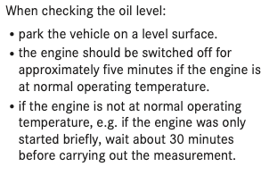

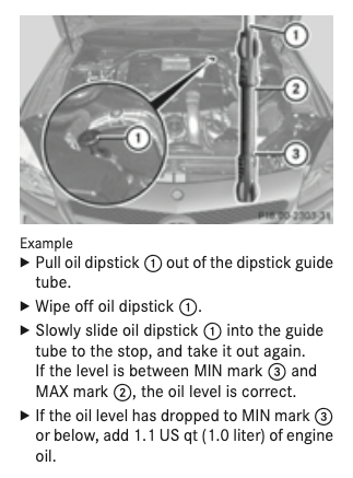

First, read your owner’s manual on how to measure the oil level. It is very common for our engines to show a dry dipstick on first check. Don’t know why. Can’t explain why. Just happens. Search and you will see.
At operating temperature, let the car set for 5 minutes. Pull the dipstick, wipe and reinsert for 3-5 seconds. Pull it again and check the level.
Between the high and low marks on the dipstick is approximately 1 quart. Adding two quarts when the oil level is at the minimum mark is way too much!
Since you are so nervous about this, measure the oil pressure (see attached). But, even if it is stuck in the low pressure position (which is doubtful because the power off position is at full pressure), remember that the solenoid does not deactivate until 3500 rpm normally. So, just drive gently until you figure this out.

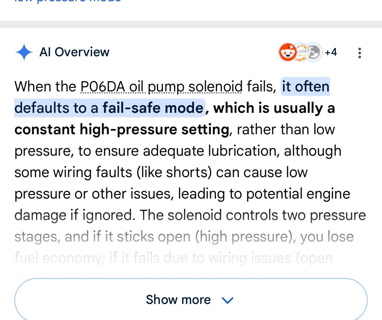

just got word from my Mercedes tech …is he bull****ting me right now?
“From the technician theoretically someone could disconnect the the solenoid, but the oil pressure would default at 2 bar. That being said since oil pressure is defaulted to 2 bar you would run into the concern of not enough oil pressure to fully advance timing and or starving top end of oil when supply cannot meet demand.”

Which means a failed solenoid would default to low pressure. Not likely.
Yeah, he’s mistaken. What does that video show you? In fairness, other manufacturers sometimes have the default to be low pressure. Your guy just doesn’t know what he’s talking about.

yep thank you I figured he was just saying that, I get dealerships probably won’t do that and just disconnect it which is why he’s giving me the run around and just wants the money to replace . I told him to unplug it and measure the oil pressure for me at higher rpm’s. I guess we see what he comes back with soon lol
