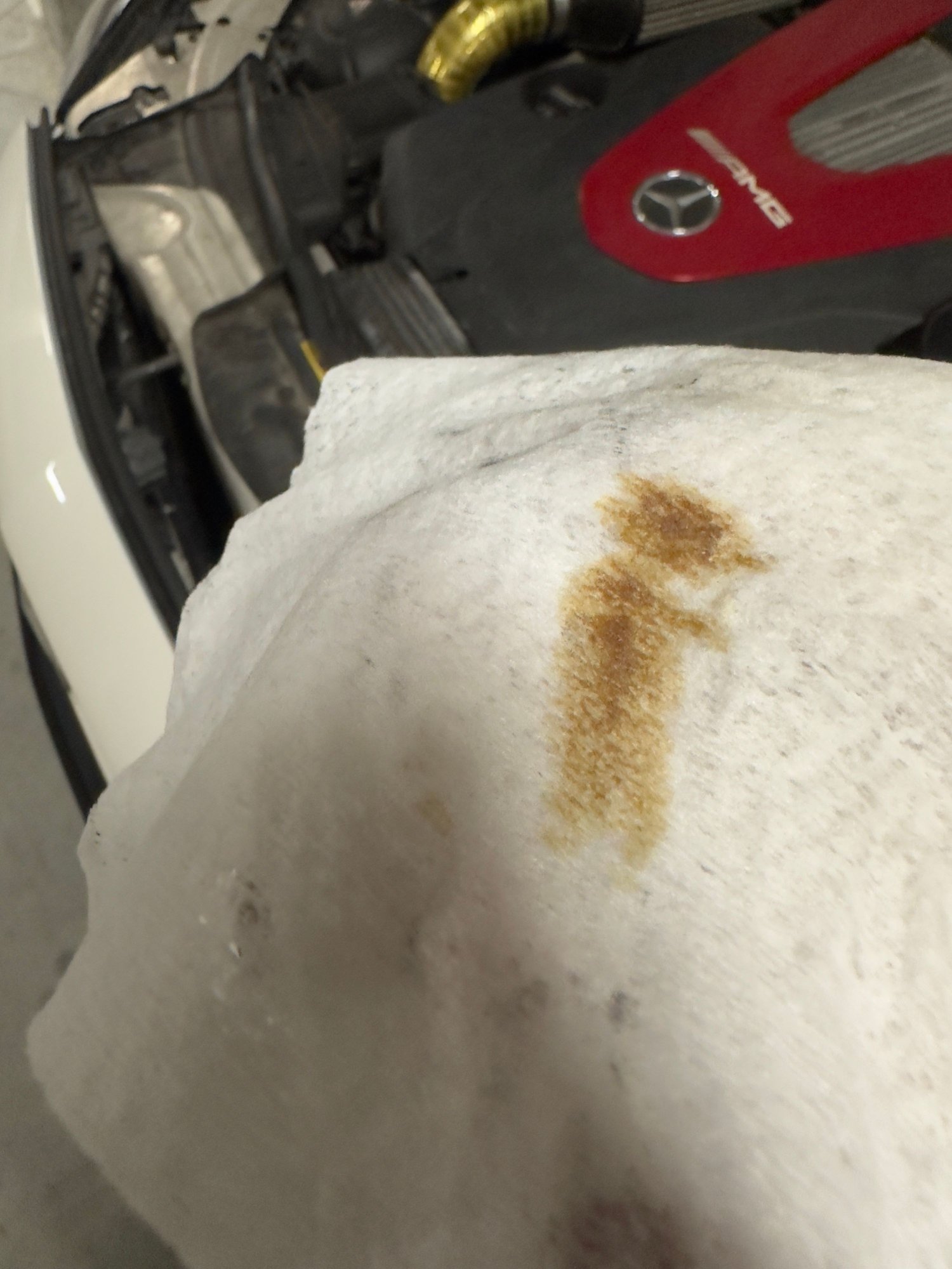

KristiyanPetrov's Avatar
Joined: Nov 2022
Posts: 512
Likes: 86
From: Bulgaria
C43 AMG '17 / Stage II
~3.5k km with 0W40 AMG oil this is how it looks (can't wait to change back to 5/40)
Old Oct 29, 2024 | 05:53 PM
  #2245
W205C43PFL's Avatar
Posts: 32,224
Likes: 6,283
https://cimg0.ibsrv.net/gimg/www.mbw...7cfcfb7a91.jpg
Just use Motul : ) I guess you could also switch to 5000miles/8000kilometers intervals as well.
Old Oct 29, 2024 | 06:04 PM
  #2246
Joined: Nov 2022
Posts: 512
Likes: 86
From: Bulgaria
i change my oil every 7-8k km and i was thinking which oil to choose for my next change since till now i used only Mercedes one, i was thinking for Mobil 1/Motul/Liqui Moly but I might go with Motul if you recommend it, can you tell which one exactly i think @CaliBenzDriver mentioned to be SP, if so i guess i should pick this one MOTUL 8100, X-CESS GEN2 112351 as this is SP?
btw: i think isn't that darker (burned) yet, considering my driving as it's stolen

W205C43PFL's Avatar
Posts: 32,224
Likes: 6,283
i change my oil every 7-8k km and i was thinking which oil to choose for my next change since till now i used only Mercedes one, i was thinking for Mobil 1/Motul/Liqui Moly but I might go with Motul if you recommend it, can you tell which one exactly?
Oh I rev mines out too, constantly, it is my daily driver but also my fun car so when I hit the twisties, I rev it out. Don't worry these cars really appreciate the Italian tune up.
I am using Motul 8100 X-Cess Gen 2 5W-40, the engine purrs at me. Forum member JettaRed also had excellent experience with Pennzoil so that is worth considering too.

Oh ya, I forgot yours is tuned as well, so that plays a role too, was it stage 2? I would also shorten the duration of spark plugs service as well.
What is the engine oil temperature at just cruising maintained at when warmed up? What about the highest temperature the engine reached? Do include the outside temperature as well when you record this information.
mm not sure if it's to me but yep im running stage 2 during summer here gets around 38C but when i unplug it was almost end of the summer, so ambient it was around 32C with 5W40 Mercedes one was around 8k km already the oil, normal driving i was keep 103-106C and when i push it a bit goes to 114C and then cool down to around 107-109C (im with BMS intake so it's heat soaked, also I run the "IC pump mode" all the time )
then Dealer changed with 0W40 AMG ambient temps was around 28C with normal driving 98-100C and when i push it goes to 112C (considering is new oil maybe that's why had 2-3C less difference between the temps with old oil)
at the moment ambient is around 10C, normal driving 97-101C and when pushed 104-110C
last year the dealer changed my plugs, since then i have around 20k km, so not sure if they've to be changed (not sure on what interval i should change them as well when you are tuned tbh..) and on next change should i go with OEM ones again or should i pick something else considering isn't stock?
