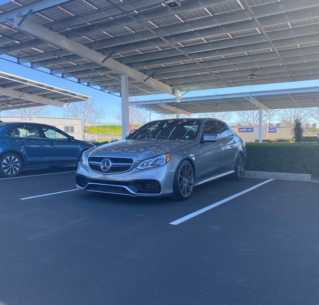

I have KW coils on mine with no issues. This was my fear with H&R springs.
Old Jun 6, 2025 | 12:30 PM
Treehouse's Avatar
Joined: Oct 2023
Posts: 49
2014 E63s Wagon
Looks like you might have spacers in the front to have the stock wheels fit flush like that? If so what size, unless there’s a drastic difference between sedan and wagon fitment. Looking at lowering the wagon with the stock wheels for now.
