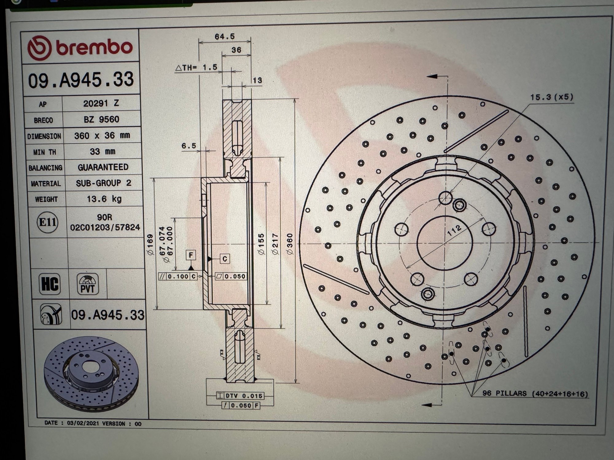

Here are the pic and schematic of the correct part from the Brembo USA site.

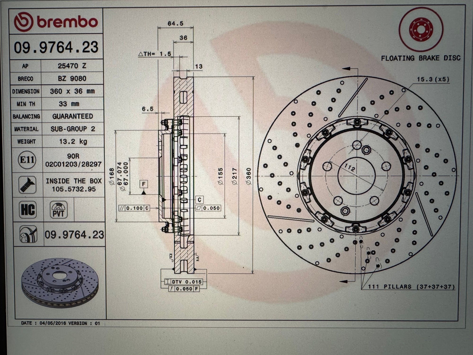

Here for the incorrect but often recommended as factory correct part.

Here's more detailed fitment info from Mercedes on the two E63 front brake rotors in question.
Mercedes says part# 212-421-05-12 with the silver hat and seven courses of drilled holes between each of the three slots (see pics and technical drawings in earlier post) is factory correct for 212 E63 with the 5.5L V8:
This part is manufactured in Italy by Brembo and available as part# 09.A945.33 from Brembo and in the retail market. It's also correct for various other 2011-2023 AMG vehicles.
Here's an MBUSA screenshot indicating correct fitment for 2014-2016 (facelift) E63 S:
Mercedes says part# 219-421-02-12 with the black hat and six courses of drilled holes between each of the three slots (see pics and technical drawings in earlier post) is factory correct for 211 and 212 E63 with the 6.3L V8:
This part is also manufactured in Italy by Brembo and available as part# 09.9764.23 from Brembo and in the retail market. It's also correct for various other 2007-2016 AMG vehicles.
Here's an MBUSA screenshot indicating incorrect fitment for 2014-2016 (facelift) E63 S:
So I have no idea why MB switched to a different Brembo front rotor when they rolled out the 2012 E63 with the 5.5L V8. The newer part is certainly more expensive and more difficult to obtain as a Brembo part in the USA. Do the alterations to the patterns for the holes, dimples, slots, and venting pillars (see Brembo technical drawings) of the newer part improve performance? Are the parts interchangeable as some (e.g. FCP Euro) suggest? I'm not sure on either question. For me, if the newer factory correct part is available for a reasonable price (in either a Mercedes or Brembo box) that's what I'm going for on my 5.5L E63. Opinions may vary.
