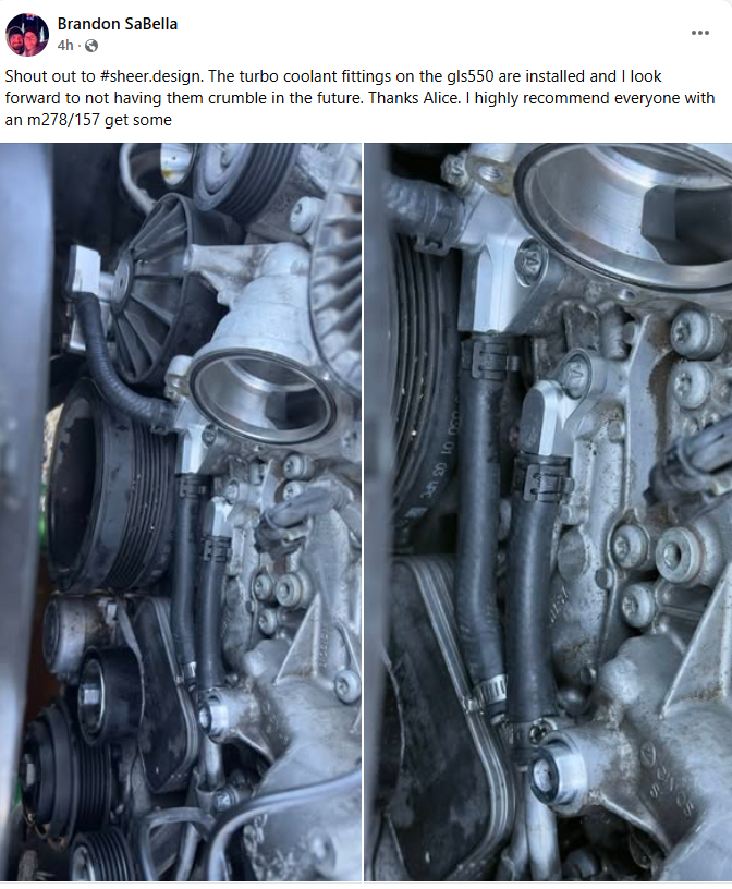

For those unfamiliar with this work,
Billet Aluminum Turbocharger Coolant Line Fittings for Mercedes M278 and M157 Engines
Old Jan 30, 2026 | 12:44 PM

Originally Posted by Nor Cal SL55
Great video of the work and looks like great aluminum parts! Thanks for sharing
Glad you like it. I have been following his offering since last year, and today an owner bought and installed them posted some photos
