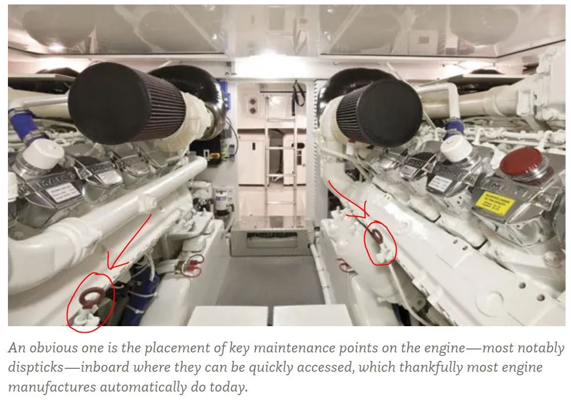

On yachts with twin marine engine set up, yacht builder and engine OE, will adjust positioning of the oil dipsticks of BOTH engines to be in the inner (inboard) side or engine room middle walkway....
for ease of inspection.
As such the dipstick actual level marking height wise from its bottom of the disptick is not the same between Left and Right side engine.
What the engine manufacturer do when commissioning these two engines are, both engines are oil filled to target liters, example 27 liters as maximum.
They then insert the dipstick and see the oil level and then mark with 2 holes one as FULL and one more as LOW.
They use some sort of hole puncher. See below the dipstick level using 2 holes.
The video from MB is fine tuning oil level alarm, seems like how the marine engine I speak of get actual FULL level/height.

Are those the washer and dryer?

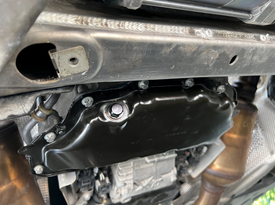

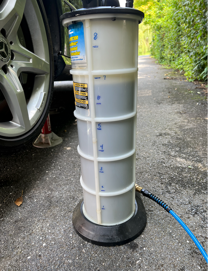

It's been a couple of days without that annoying message to Check Engine Oil At Next Refueling. I decided to suction all the oil out and measure it. Let me say that I had thoroughly cleaned out the container before suctioning out the oil. I did that to avoid contamination of the oil because I was going to reuse it. There were less than 100 miles on the oil. It didn't look like honey, but it did look like pancake syrup. Ummm, ummm, good!
As you can see, it looks like 6.7 or 6.8 liters were drawn out. I then moved under the car and opened the drain plug, but no oil came out. I used my endoscope to look around inside the oil pan and saw oil was still slowly draining from the engine. But because the front of the car was raised and the drain plug is on the front side of the oil pan, it didn't flow out of the pan. If the car had been level, it would have drained completely.
It's still too soon to say this has been "fixed" but things are looking hopeful.

Twin generators.

Thanks. I was just being a smartass.

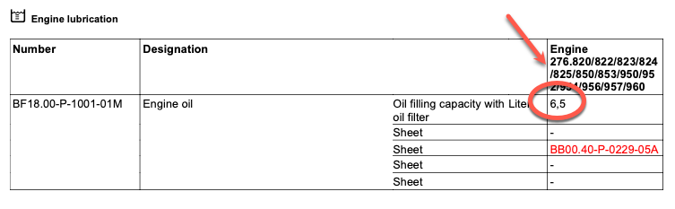

You were adding 6.5L to an engine that was supposed to have 6.8L. That's why I recommend adding more oil at the start of the conversation. You have to be a good bit over the recommend amount to get a high oil message and I typically go around .5 quarts higher than the recommend amount as it creates a safety cushion. Glad you figured it out and had an adventure doing so.

I appreciate your response. But the specified amount for the M276 according to the WIS is 6.5 liters (see below). However, based on what I suctioned out the second time, you have a point. What is not clear is does that capacity mean at the minimum mark, the maximum mark, or halfway between?

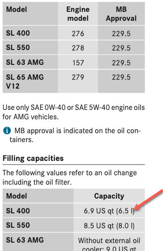

I assume you have been posting on your SL400 in your signature? If so, the fill level is in your owner's manual. It's actually 6.9L so I was a little off. Page 607 of the attached PDF or on page 604 of your owner's manual. You were just underfilling your engine.
sl roadster 2014 Owner's Manual PDF Download | Mercedes-Benz (mbusa.com)
Actually it is 6.5L which is 6.9qt (you must have misread it). OP is correct.

6.8 quarts is the recommended oil amount, and you added 6.5 quarts, correct? Is it low on the dipstick? If so, add, at least, another quart and see how it goes. I'm betting the last shop or person that did the oil added 8 to 8.5 quarts which is about average for many models and that's why you got 6.7 liters out. If it is happy at that level, again, give it another quart and monitor.
Used L when I should have used Q in the last post. The OP was putting in 6.5 quarts which is less than the recommended amount of 6.9 quarts. I pointed this out at the beginning of the thread, but I said 6.8 quarts based on memory.
This all started as the OP was underfilling his engine.

6.5 liters or 6.9 US quarts. Regardless, the issue now appears to have been caused by some kind of signal glitch. Since checking continuity from the X26 connector to the oil level switch and to the ECU, the message has not reappeared. I am slightly overfilled, however. The oil level exceeds the maximum mark but does not touch the multi-strand metal part of the dipstick. Tomorrow morning I will pull out 100 ml at a time until I get the oil level to the maximum mark and see if the message comes back. Keep in mind, the car just turned over 50,000 miles and this is the first time I got that message in nearly 30,000 miles of ownership. I have always kept the oil near the maximum mark.
