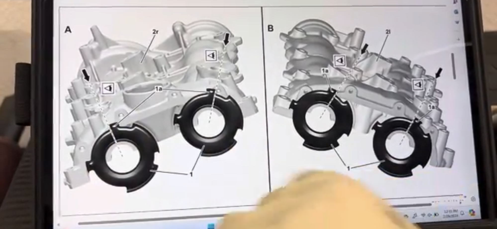

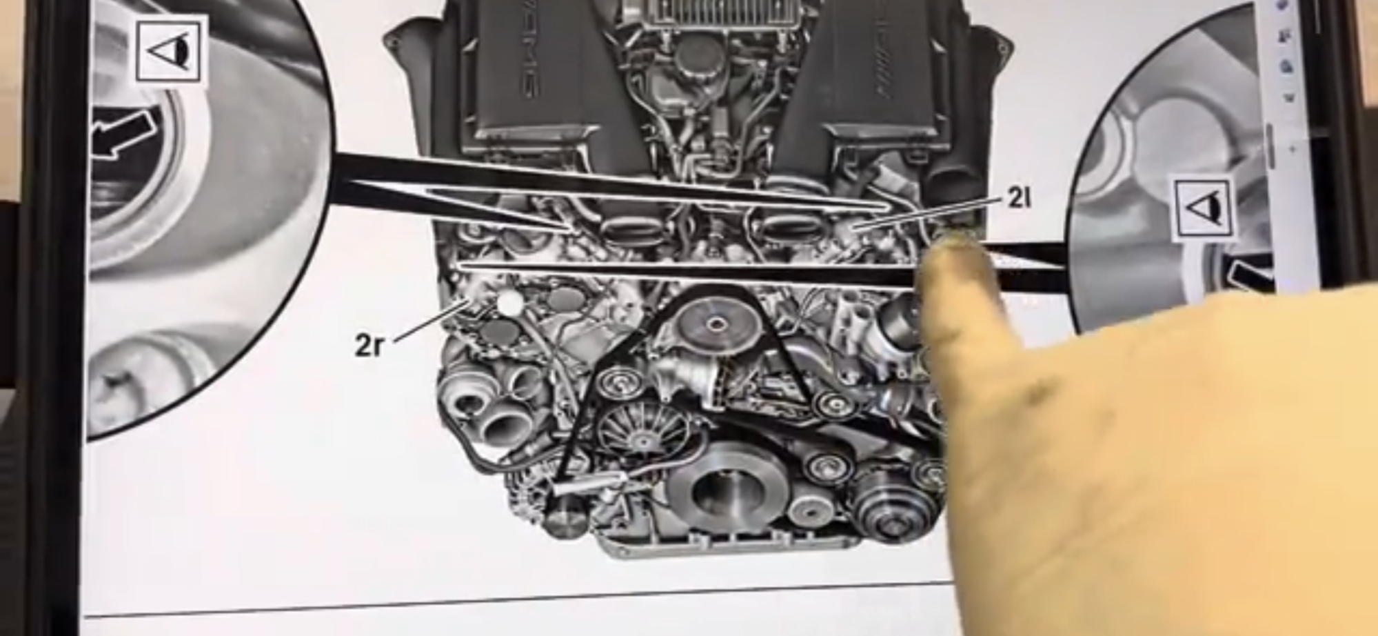

Does any have a trick for checking timing without disassembling anything major? I found a video of a guy checking an M276 through the sensor holes but wanted to see if anyone had any advice on this subject. Thanks! M157

That is the way. Xentry could also help you see it.

The crank position is 53 degrees right?
From 32 mins.
