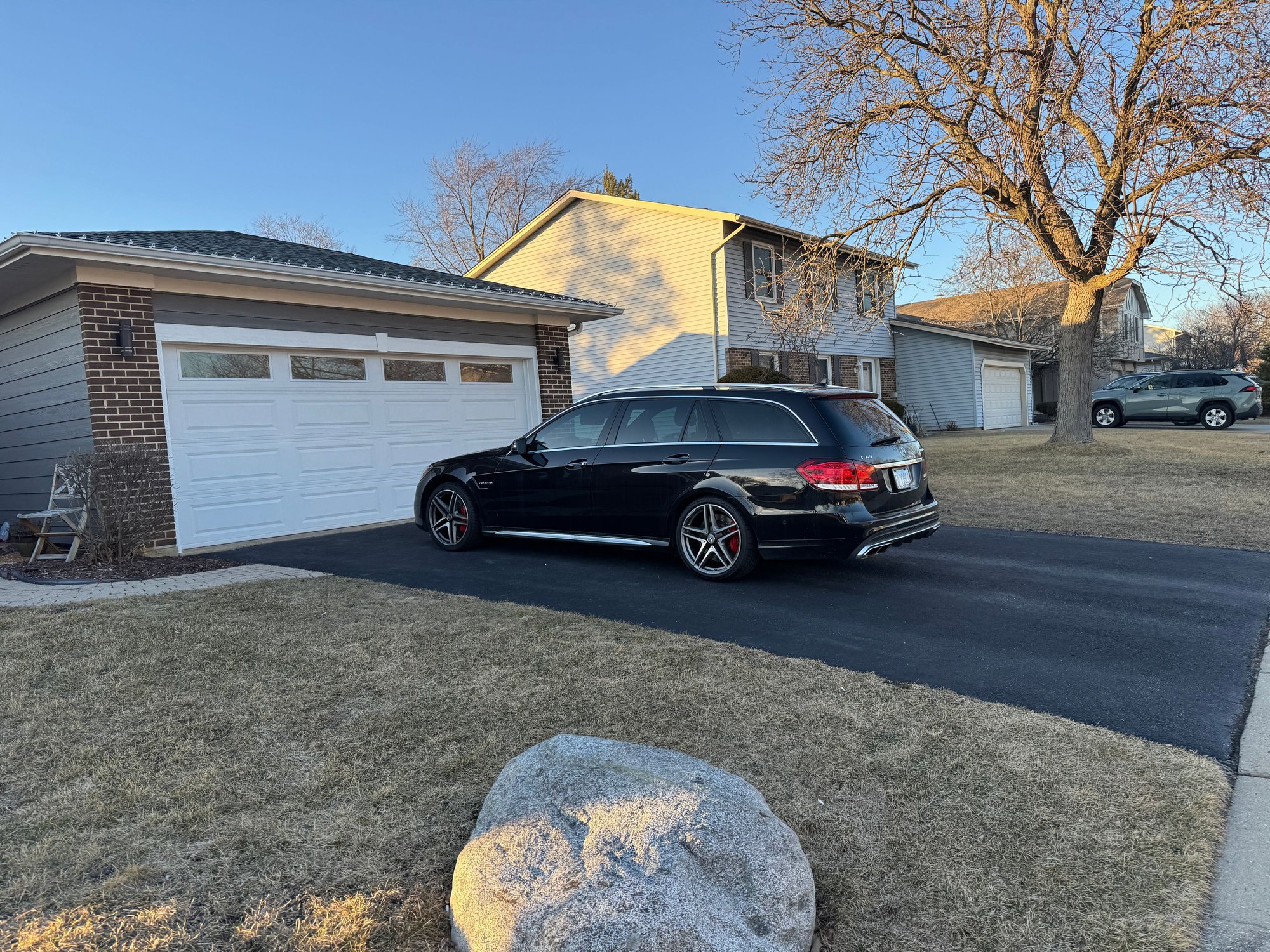

Hi to all…
Long story short. I purchased beautiful and clean 2016 E63s Wagon with 56k miles, black with designo black/orange interior. Car is super clean, no accidents etc…. Mint
Before purchase, took it on a test drive, everything was fine… didn’t drive more that 50 mph probably (small “residential” streets and cop’s everywhere). After purchasing, on the way home, on the highway, speeds 55mph slight vibrations coming from the back of the car. Faster you go, bigger vibrations. At 90mph it’s getting really uncomfortable.
i didn’t contact dealer, i will not waist my time fighting with them over this issue, since it’s a used car with no warranty. Paperwork signed, nothing else to discuss.
i took it to my good friend mechanic shop that usually works on german cars.
he change engine oil, trans fluid and both diffs fluid. No metal shavings etc. he check all suspension components, driveline, engine and transmission mounts, all good. Only thing that he found was little oil around one cam magnet (but harness is dry).
tires are pretty much new, made 24th week of 2024. Wheels are in great condition, no visible damage or even curb rash.
Does anyone had similar issues?
It’s hard for me to believe that problem is in unbalanced wheels because usually vibration going away with higher speeds, in my case, they are way worst….
any help is greatly appreciated….
