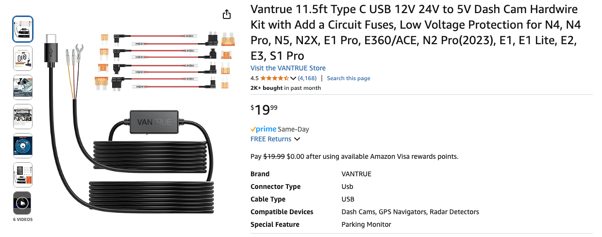

I have a Vantrue dash cam wired to start recording if the car gets bumped, etc. They have a wiring kit for $20 that should work with any cam using a USB-C connector for power.
