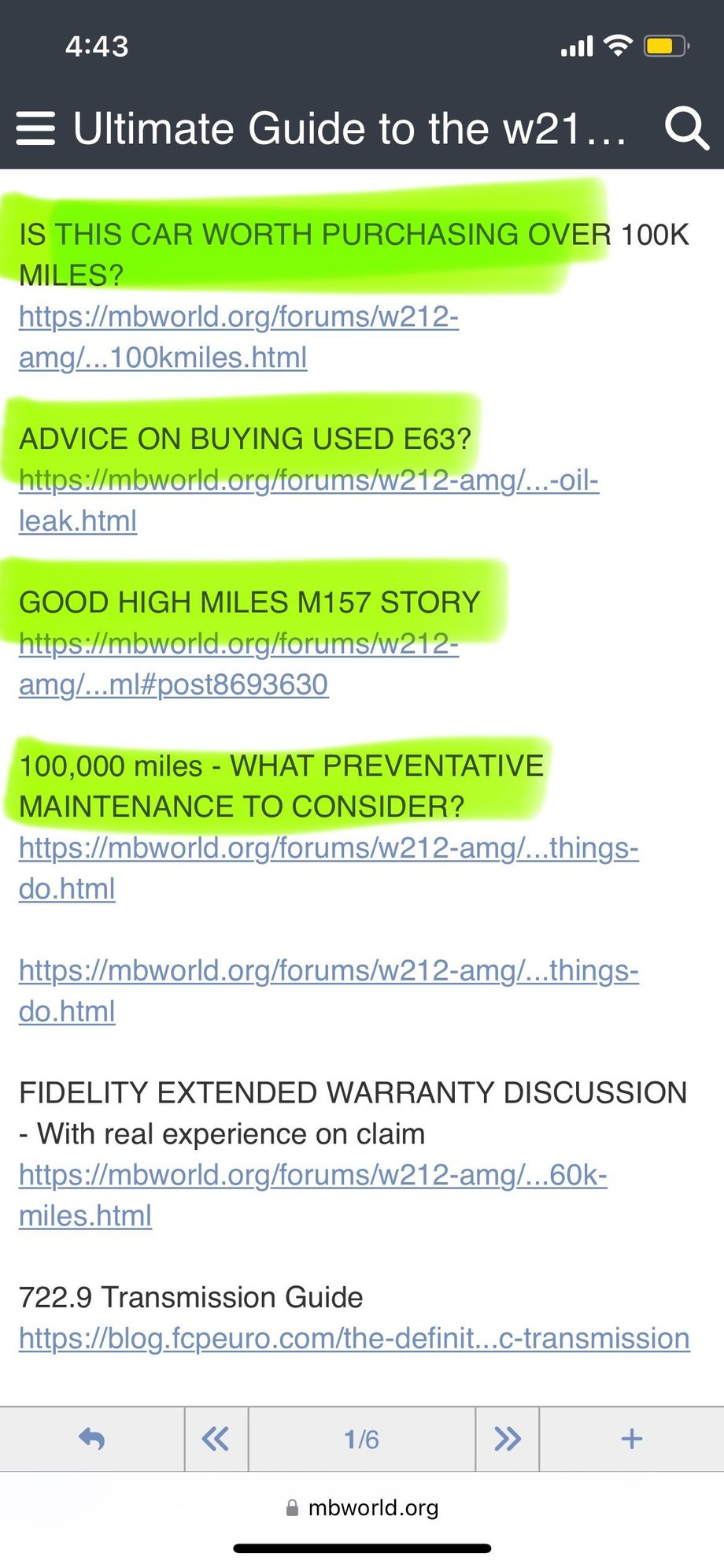

Consider this sticky - many threads on your very topic - "buying a used e63" and many threads on problem areas to focus on (sounds like you're already familiar with this sticky)
https://mbworld.org/forums/w212-amg/...fixes-diy.html

Thank you for the links,
has been very informative!
Your surely right, ll just do borescope and compression check on all 8 cylinders to be safe.
