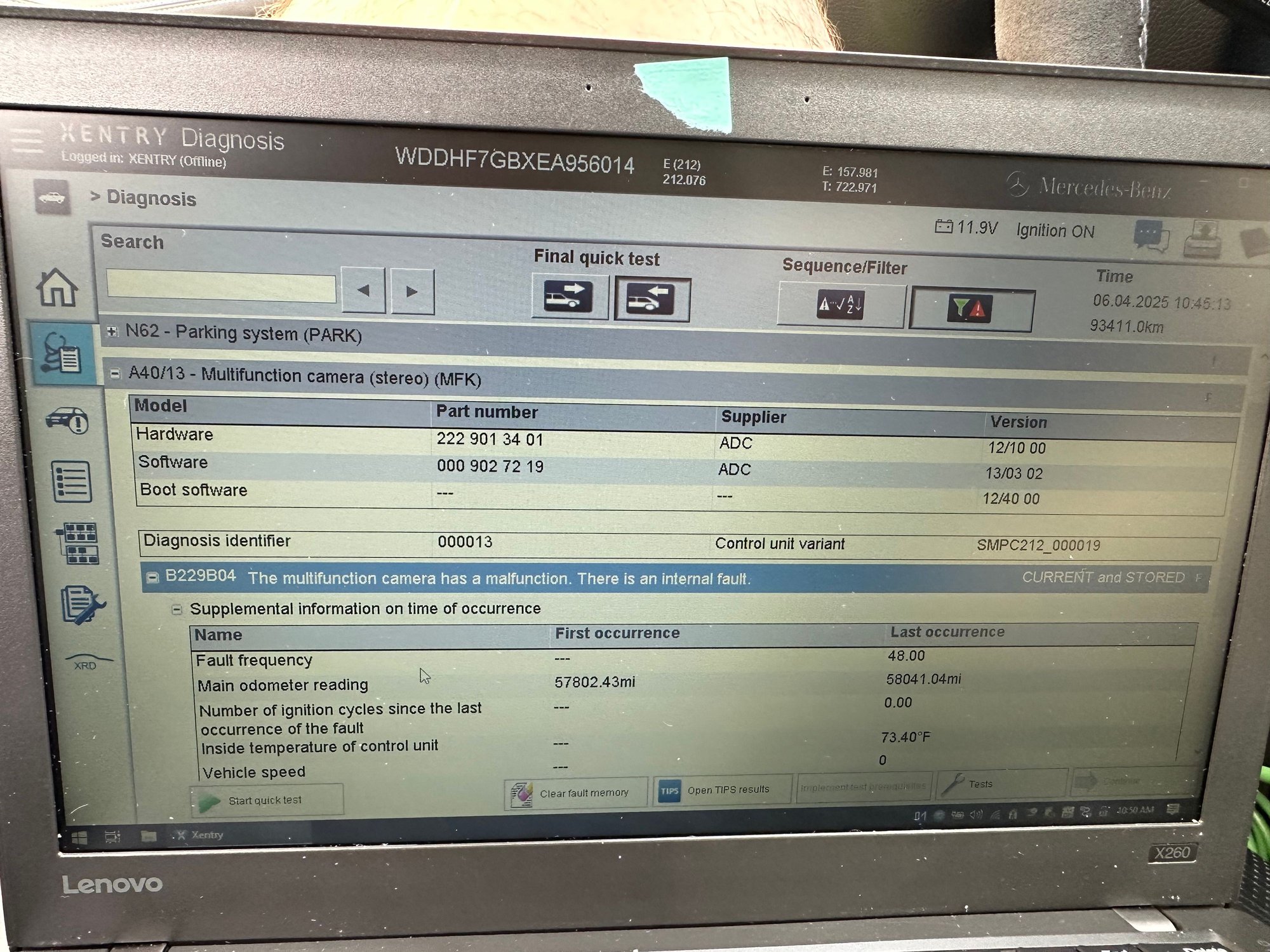

My 2014 e63 has been showing "PRE-SAFE functions limited See Operators Manual" on startup.
I ran a Xentry diagnostic and pulled:B229B04 The multifunction camera has a malfunction. There is an internal fault.
Xentry seemed to indicate that the module is bad, and needs replacement. Before I pull the trigger on that though, has anyone come across this error before and not needed to replace the camera? Are there other diagnostic steps I should take?
Thanks in advance!

Tick the fault code and press Continue/Test on bottom right button.
...but the "internal fault" is quite obvious translation
If I remember correctly, that's what gave me the explanation of the fault code, remedy for which was "replace the unit". Seems like that's the recourse for now.

So... replace the unit...very easy to copy the coding and software from this camera and paste to any second hand camera with the same Hardware number.

If you can't get this unit to cooperate get a used one.
yes, i applied a good quality fresh thermal paste. After that, i noticed the MFK's metal plate was getting warmer quicker than before, but not like sizzling temperatures, just a nicer warmer surface it started to have during operation. Not sure what you mean by 'trust soldered were done right'. Those tiny pins you showed in your earlier message was perfectly tight and i did not see any corrosion on them.
getting a used MFK is what i am currently on. they are plenty on ebay and are around 200-300 USD with identical part number, so i am not worried to find a replacement one. just i am not rushing
