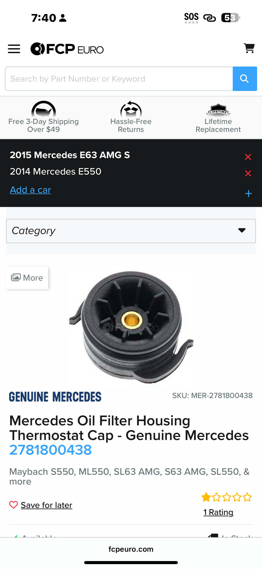

It’s not impossible to reach them, but it is definitely a PITA! I’ve done it a few times on two different W212’s. You need a very specific thin long ratchet and you will likely bleed/yell/cry. Don’t forget to do the oil filter housing gasket and the spring-loaded piece on housing. How many miles on your engine?

100,000 miles
which is the spring loaded piece ? will look it up and order those parts now

Apparently it’s called oil filter housing thermostat cap…plastic circle with locking tabs and o-ring. Costs roughly $20, hopefully attached a pic below

why do you suggest replacing this ? does it need to come out ? or just do it while you are there. my car has done around 120,000 miles.
