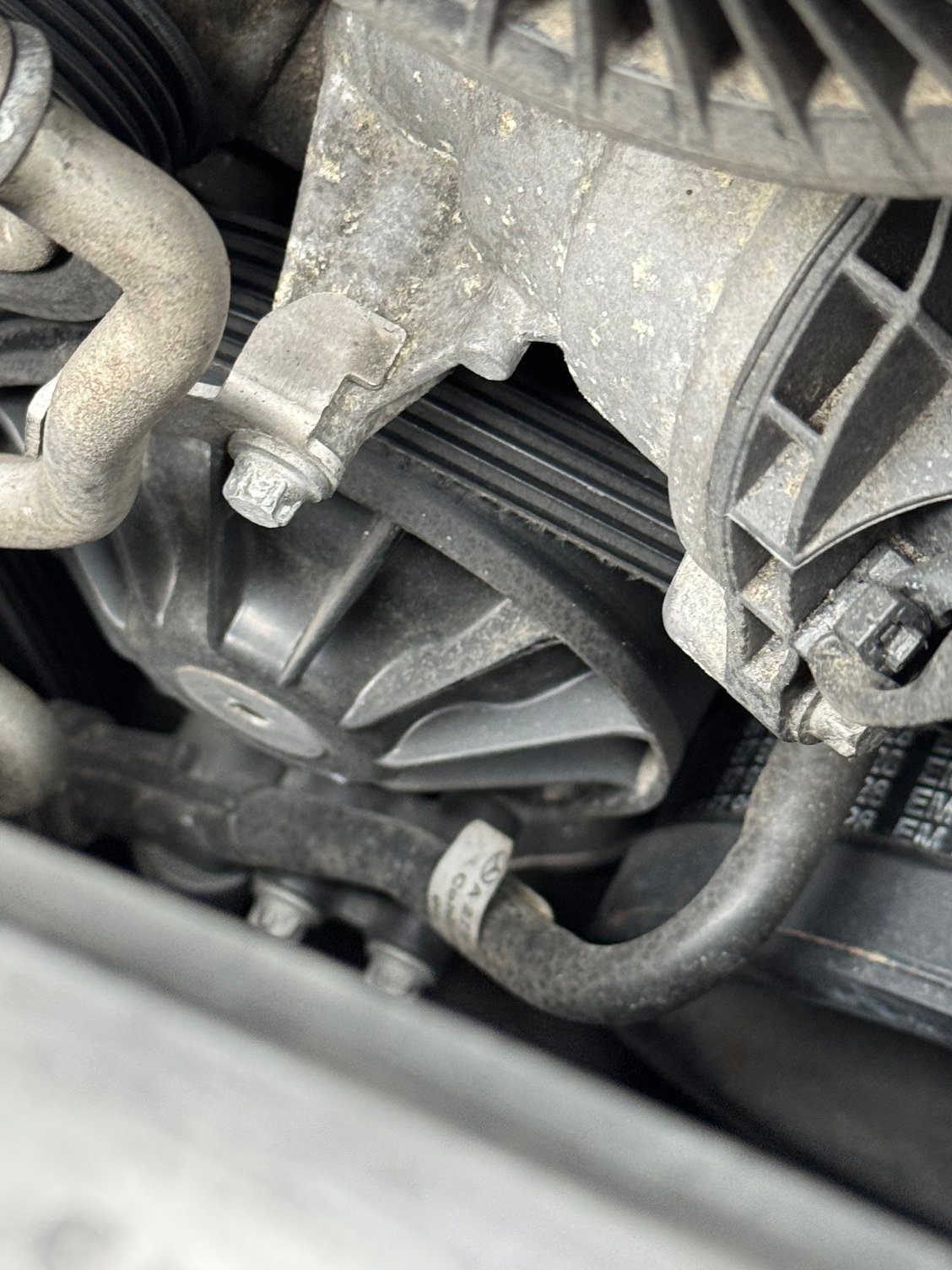

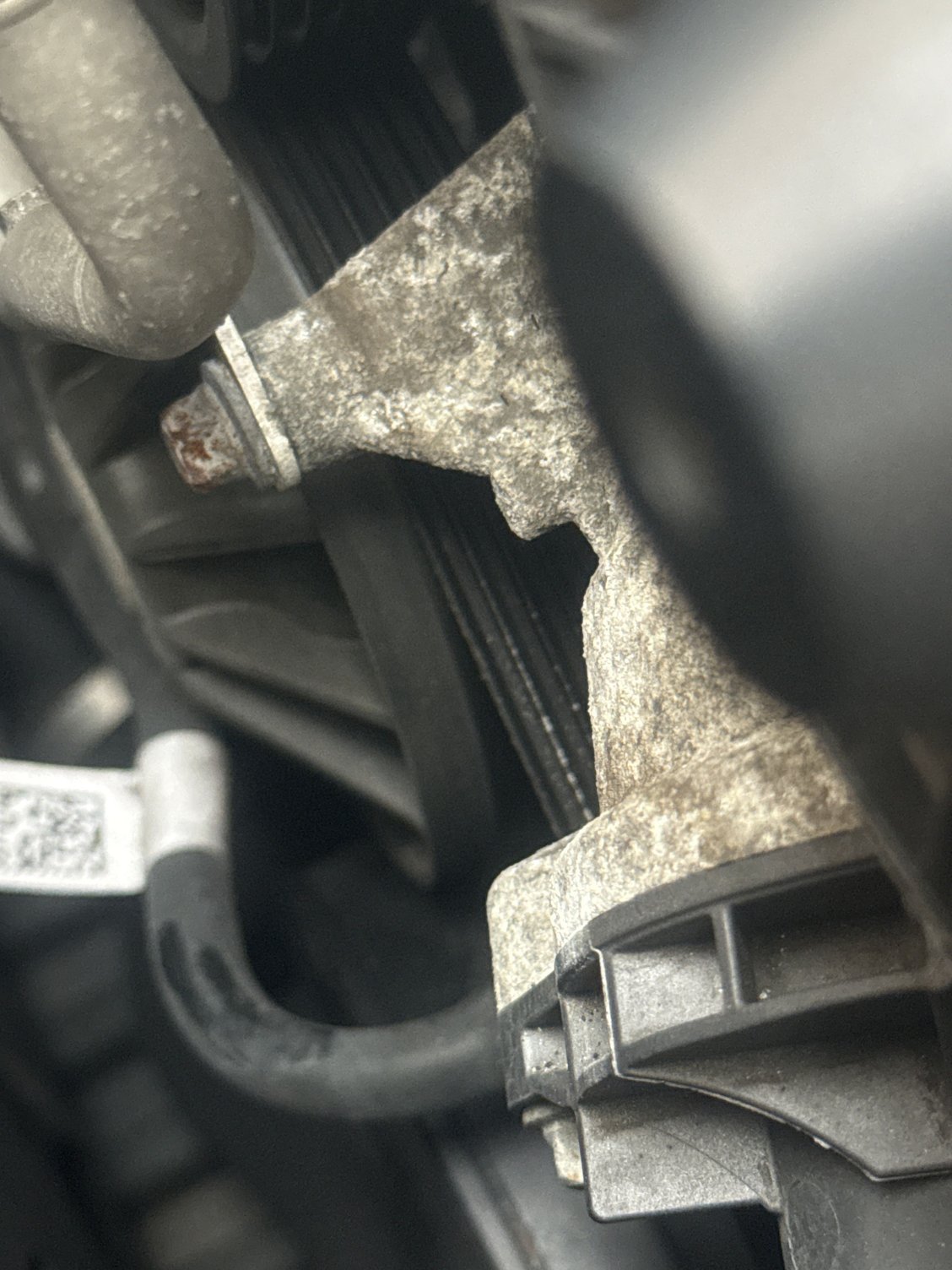

@5soko Does my pump need replacing, or is this normal? It's a 2013 M278 with 60k miles.
