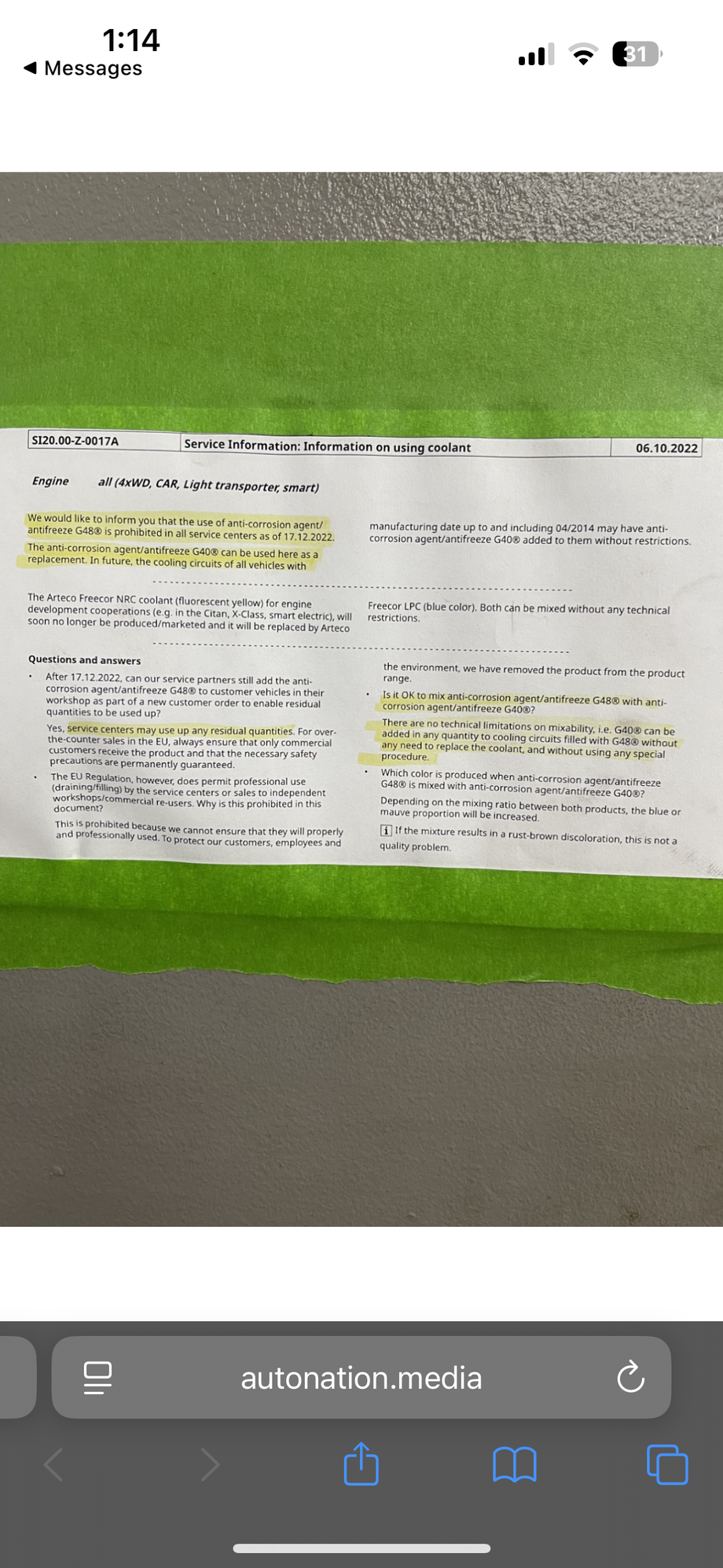

I keep posting this but nobody seems to search…or want to believe it..
Things have changed over the years… This is from Mercedes, to a large dealer network with hundreds of locations.  What a dealer does and what you can buy at an auto store to diy bring different solutions to the same question.
Things have changed over the years… This is from Mercedes, to a large dealer network with hundreds of locations. This has been posted on their wall for three years due to the constant confusion…What a dealer does and what you can buy at an auto store to diy bring different solutions to the same question.

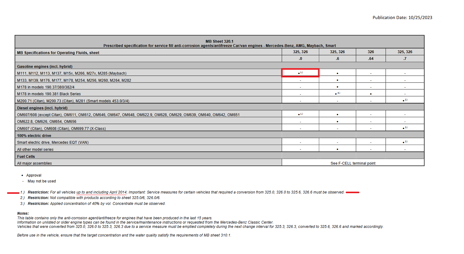

I would simply follow what the latest updated info says in the MB Bevo website.
Since I have a 2010 M272 engine I use the Zerex G48 50/50 pre-mix coolant. I can get the Zerex cheap at my local Napa auto parts store. I use the 50/50 because my house tap water isnt the best, leaves water spots on my car after washing so I dont feel comfortable putting it in the cooling system.
As for using the Peak brand European antifreeze I would use it if I couldnt find any other coolant that has the specific MB spec listed. The only spec i can find listed on the Peak info is astm spec.

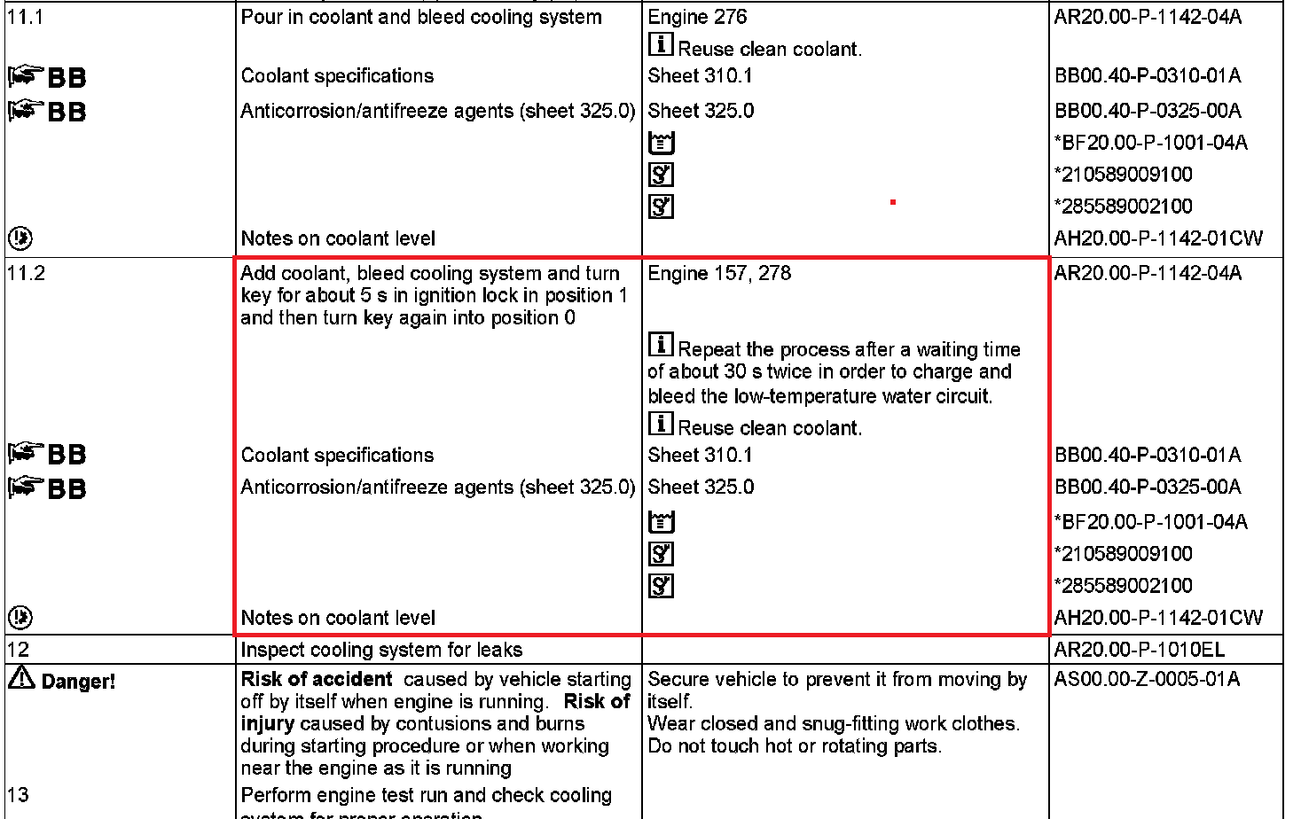

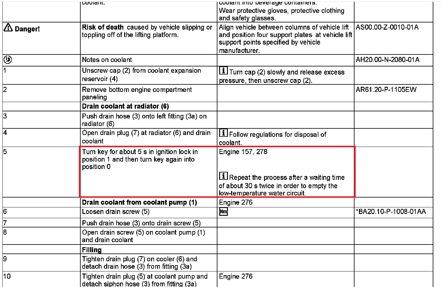

Heres some useful info for the M157 and replacing the coolant:
