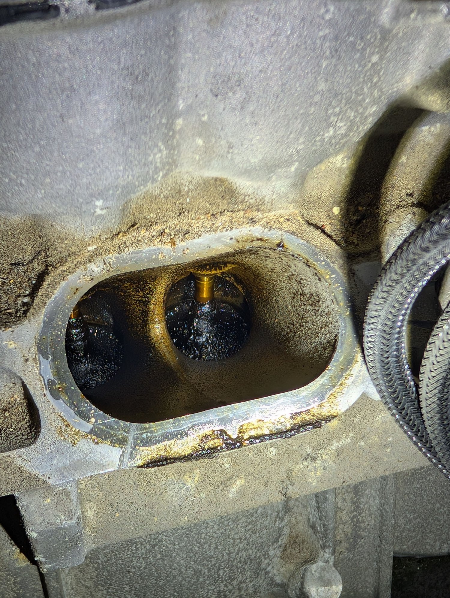

Here's one
sets of intake valves @ 73k miles
Old Jan 21, 2026 | 04:53 PM
  #46
CaliBenzDriver's Avatar
Joined: Apr 2019
Posts: 11,727
Likes: 6,670
From: Silicon Valley
W212 MY'14 M276-3.5NA @75kMi
that is really not bad considering the turbo GDI territory
73kMi 👍
73kMi 👍
Lower mileage engines have been shown with much thicker buildup on the intake valve stems.
The valves buildup is 100% from non combusted vaporized oil.
What is the look of cylinder walls above pistons side where deposits can buildup?
Inside combustion chambers oil carbon is combusted... only SP/SN package heavies are left behind.
