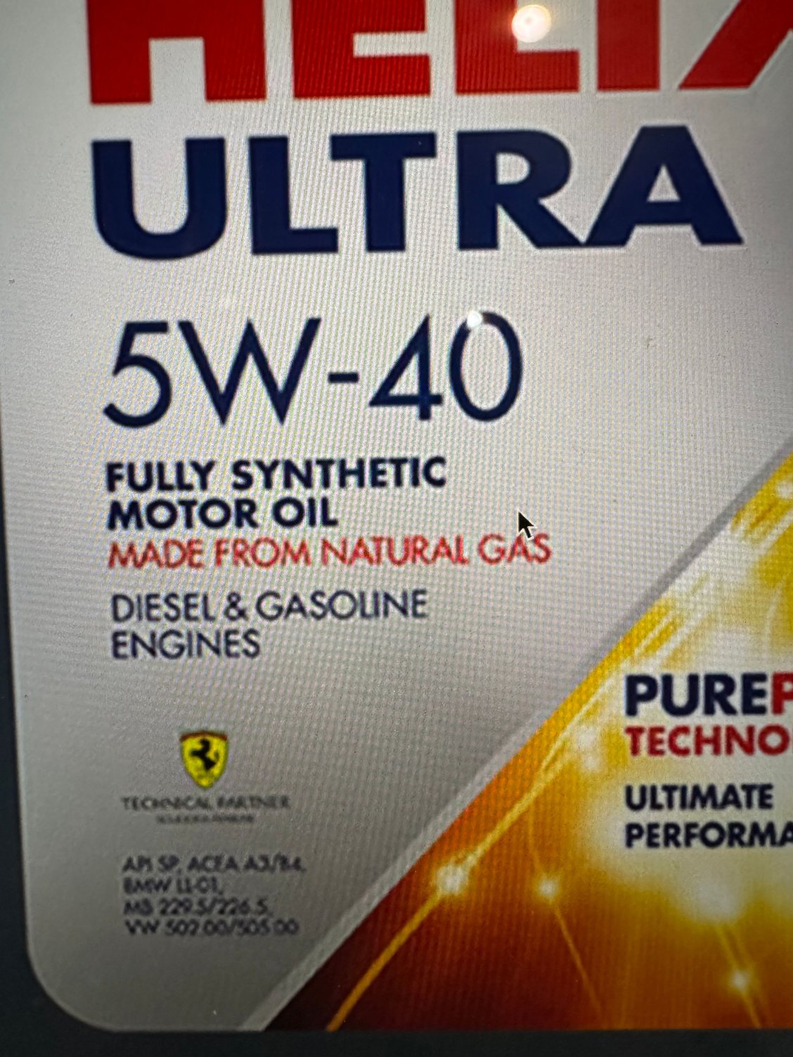

Okey Cali now I know how you see why the swap to 5W-50 oils will cause pinging, thanks for explaining. I still have a bit hard time to believe that's true and cause problems to people who go straight to 5W-50 oil.
Thank you Cifdig for your comment. I have respect your point of views.
I have run 5W-40 Shell Helix Ultra API SP about few years. I will go next to either Motul 8100 x-cess Gen2 5w-40 API SP (that Motul have a lot versions like API SN etc) or Motul 8100 x-cess Gen2 5W-50 API SP. I don't feel comfortable to make my own oil blending, just use 5W-40 or 5W-50 API SP.
I have done all new lambdas, walnut blasting, flow tested and get cleaned all injectors etc. Car is tuned pretty heavily for M278, so Motul 5W-50 API SP might be the best choice for me.

Here is the oil what I have used. 5W-40 API SP Shell helix ultra.
Shell Helix Ultra 5W-40 API SP
