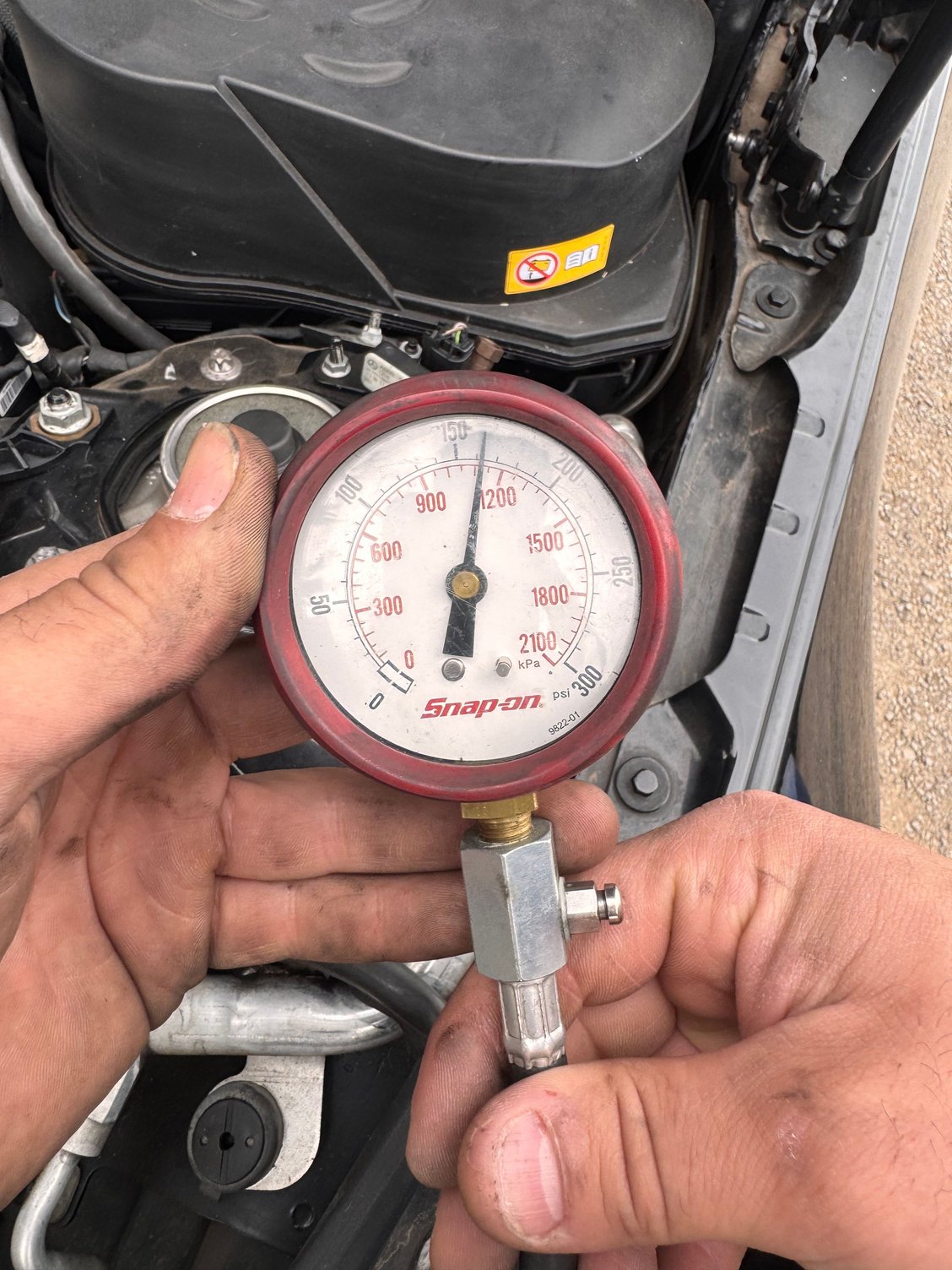

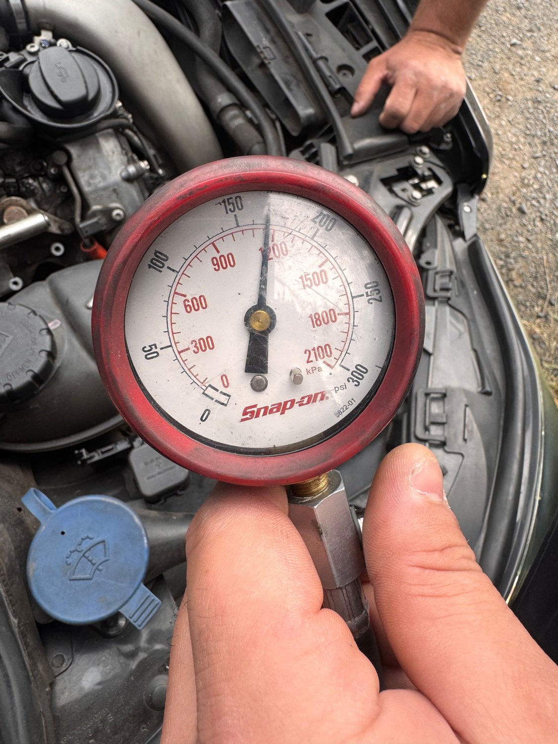

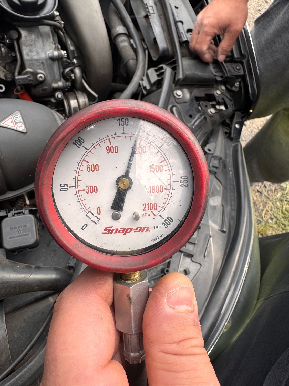

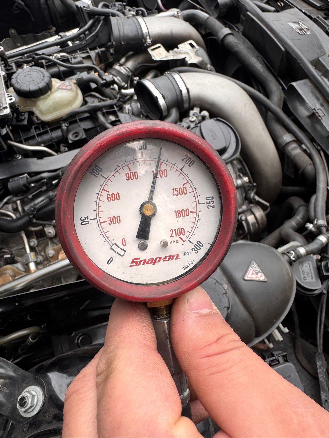

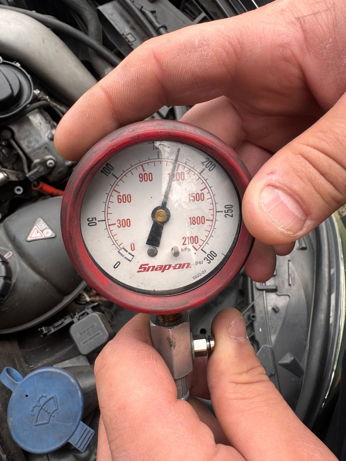

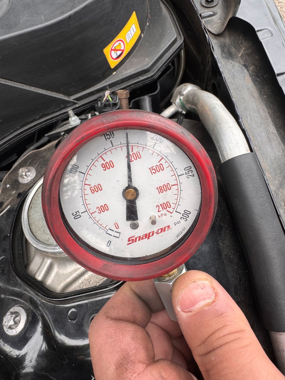

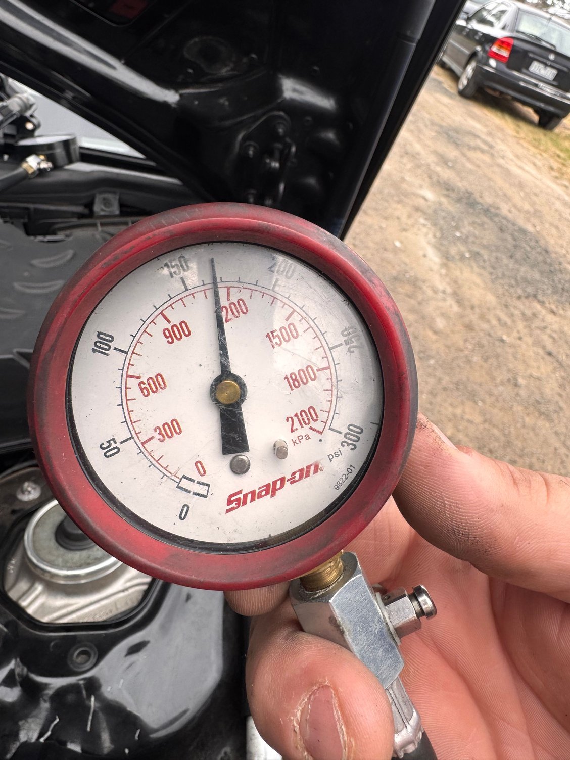

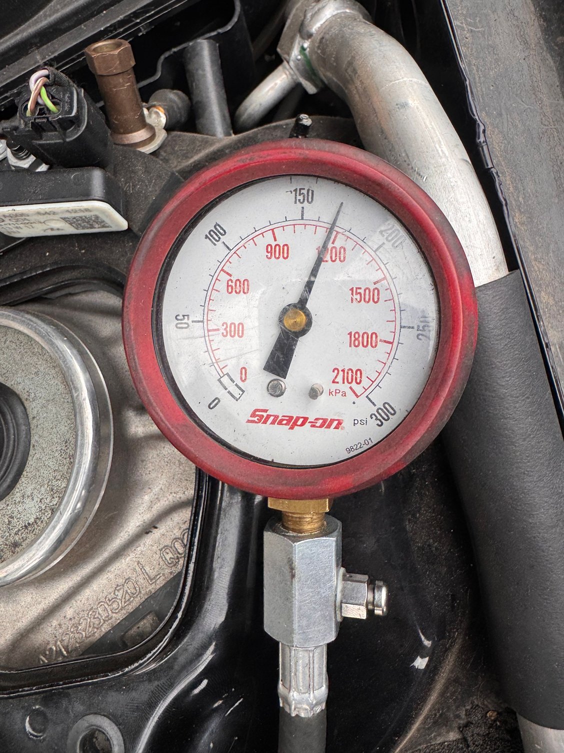

I have a e63s amg m157, no tune but do have down pipes, all o2 sensors plugged out for the car to run richer. My car is currently blowing blue smoke, yes I know it’s burning oil, I have checked the intakes no oil, I have checked both sides for the PCV valves, plugged them out and still continuing to blow smoke, I have done a compression test all pistons are running at 160 psi. I had taken out spark plugs, I will attach a photo of the order I’m going in, piston 1,4,7 & 8 have oil residue on them, clear indicator that’s it’s burning oil, if it was the rear of the turbos leaking there wouldn’t be any oil residue on the spark plugs, no oil leaks visible, I was thinking it was the valve stem seals but no smoke when you first start the car only when starting to rev the car. I am stuck in this situation and don’t know where to go from there.

Last time I watched a video of a compression test on an M157. The cylinders were all 190-200 psi.

I would boroscope the cylinders. Wet pistons can make compression appear higher than it really is. These engines have an issue where if the last person didn’t do short oil change intervals and let the car properly warm up, it likely has stuck rings or dirty rings and needs to be cleaned up. I personally used all the different types of chemicals safely with the caveat that I know exactly what I’m doing and how to use safe procedures. Also, despite many people’s feelings in the younger days of this engine, the valves do deserve a cleaning before they drop their carbon chunks into our delicate cylinder walls.

I had done some research, typically the compression would usually be between 130psi and 170psi, 170 indicates good of course, also if compression isn’t good then they all wouldn’t be showing the same readings due to the fact cylinder 1,4,7 & 8 has oil residue on the spark plugs, that given I wouldn’t think rings are the problem…. Or am I wrong

i will be going to try get a camera today to check them out, I’m from Australia Melbourne, I’m very familiar with performance work and people in the industry ( garage Worx, RPM performance group, very known ) I’ve been told 160 is very good and I shouldnt worry about piston rings. I can try cleaning everything but what kind of product would you recommend and where exactly should I be cleaning?

I say that the compression might actually be unknown now because those wet cylinders might lower if they were dry. The scope will show you the full picture there…

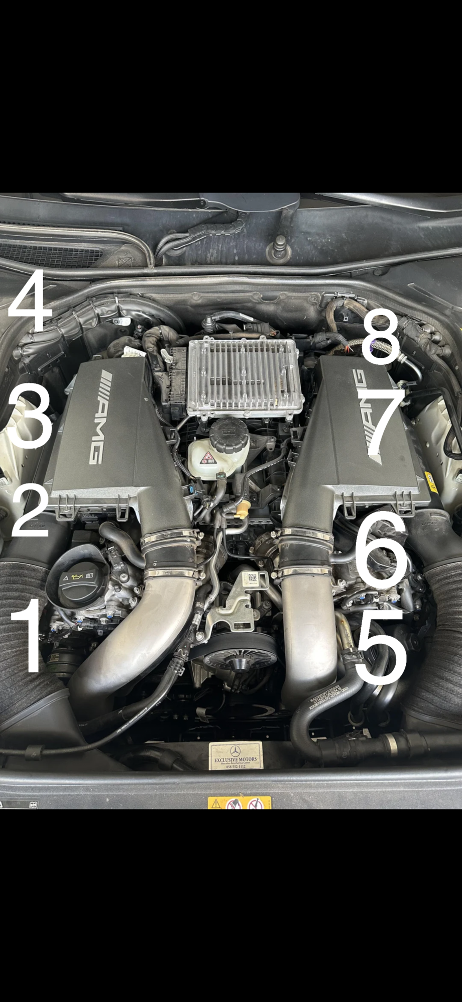

Cant -not- be blowing past the piston rings. Sucks, but....I got $5.00 that says #5.

As for the number five cylinder, just Google M157 engine and number five cylinder. Lots of history there which you do not want to be a part of…
