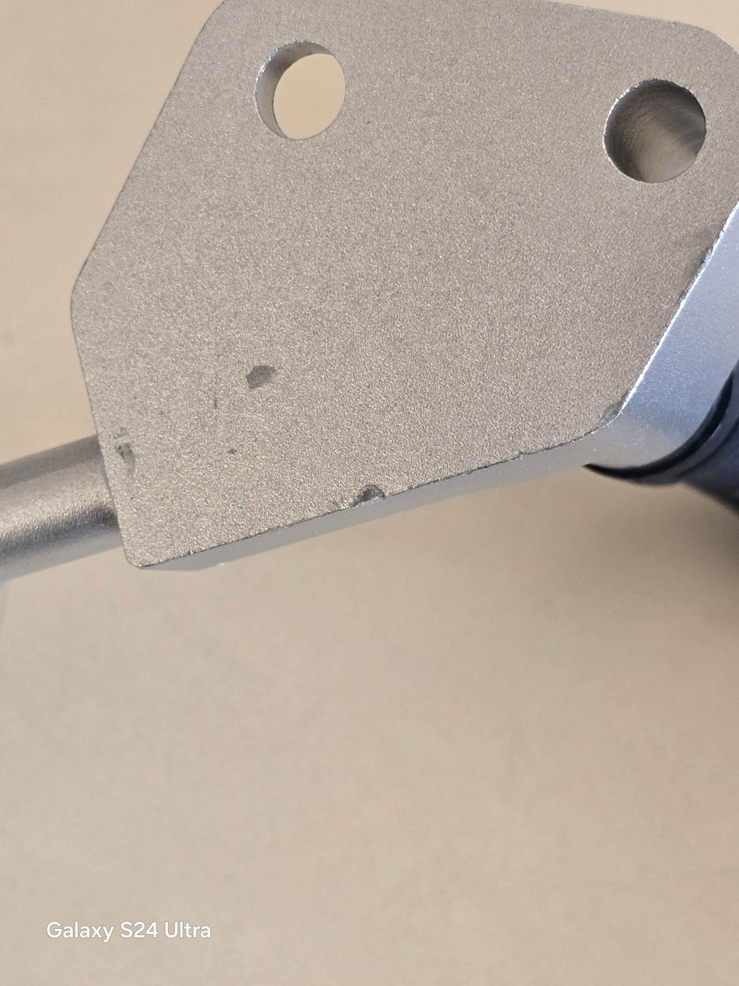

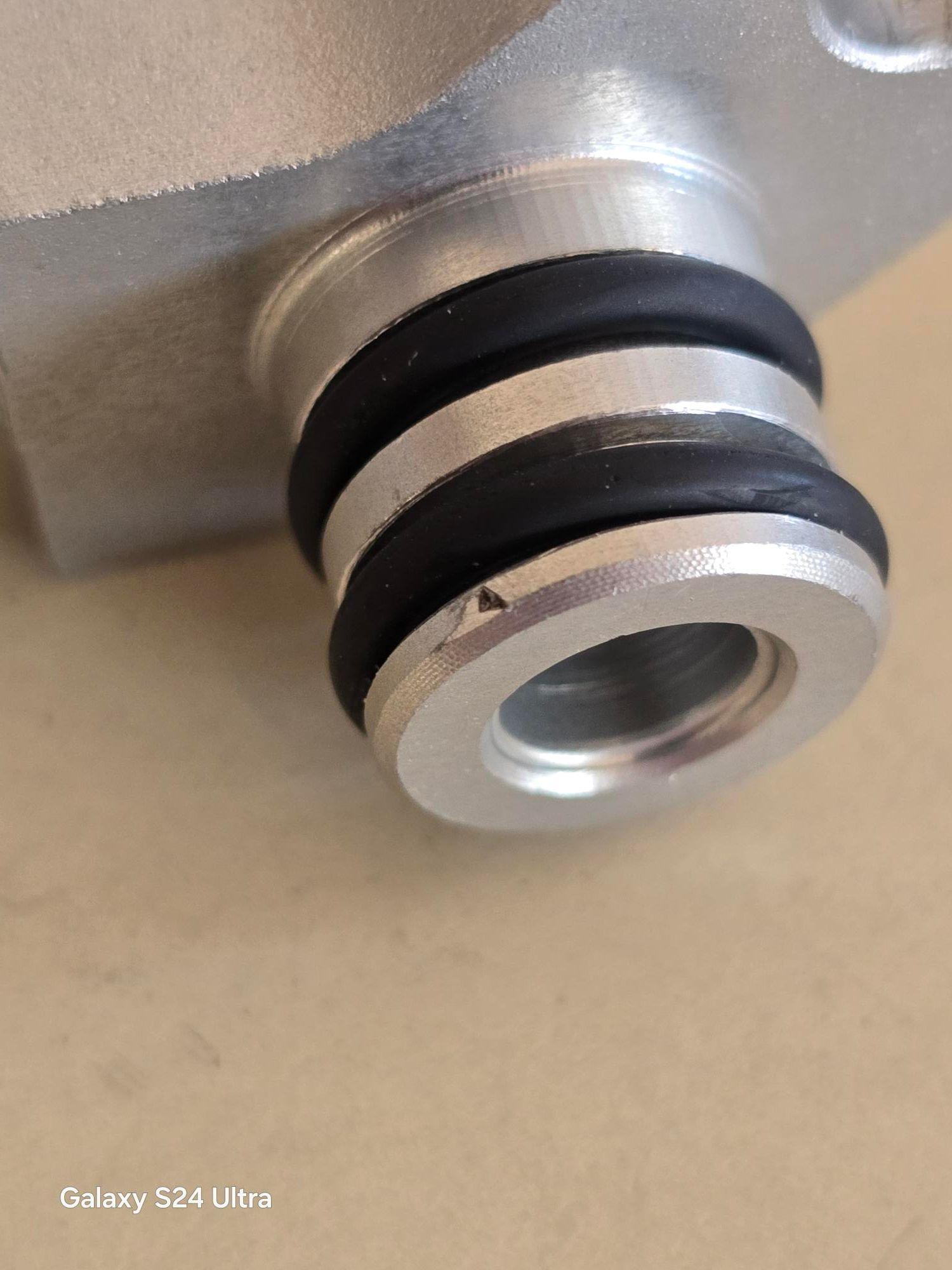

Just a FYI update on this. Figure I would post here and not the larger DIY thread that has had recent action. That aside I ordered on 1/31/2026 and it arrived 2/4/2026. In all fairness, I think it could have gotten here sooner but UPS seemed to sit on the package for about a day once it was in thier possession with no progress but that could have been the snow storm that hit a big portion of the US. Below are few pics. After taking a close look at the fittings I saw a couple items of note. Not sure if they will be an issue but time will tell and I am withholding judgement until I get things installed which will unfortunately be a couple/few weeks out at best. I feel like its probably more likely these dings occurred during shipping not necessarily during machining.
[img alt="This is what came in the package.
"]https://cimg9.ibsrv.net/gimg/www.mbworld.org-vbulletin/1500x2000/e63_turbo_cool_line_kit_2e341e6fadfdde2ee85fb97ffe 3aff58b288899f.jpg[/img]
Small fitting zoomed out.
Small fitting zoomed in...notice the nick on the edge
Large fitting zoomed out...
Large fitting zoomed in...again a ding at edge of the fitting...

That knick on the inlet doesn't look like something that would have occurred during shipping. If it was me, I'd contact the vendor to exchange that one out.

When you zoom in on the photo, the first O-ring doesn't appear to fit in the groove correctly either. It probably wouldn't leak, but the goal of this entire project is to improve the OE reliability.

Those look like cast and then machined. If billet, would see the tooling marks all over and would be unlikely to have all of those defects in the surface.

Mine arrived without any defects. Is the fit for the O-ring about the same? Yes.
She claims to be using oem o-rings.
Am I concerned? Not in the least bit. The issue for the OEM part is heat exhaustion in plastic parts. I feel this solution (however the aluminum is created) is far superior to the oem hard plastic and the rubber hoses we all agree are better than the hard OEM plastic. Extra value - if these leak, ,I will take them off, install a thicker o-ring and call it a day. Try doing that to the OEM parts.

It's not the size of the o-ring that looks funky, it's the size of the groove. Like to see what the oem part looks like.

I wasn't mentioning it as if it really matters. I just wouldn't list them as billet aluminum if they are in fact cast. It undermines credibility out the gate.
