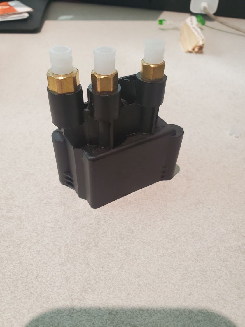

Solenoid replacement...car going to drop?
So, when I put this in (today) is the car going to drop to the ground as I disconnect the current solenoid? Not sure if I need to jack up the car or not...not like it is hard...I hate hate hate lifting the rear of the cars...
yes, you're right about your chassis dropping low without air-spring pressure.
Jack up the rear diff. and install jack stands at side lift points before valve replacement.
Use soapy water to double-check air connections while dealing with this.
Inspect & silicon lube your ride-height sensors to slow down the ball-joint rusting stuck.
