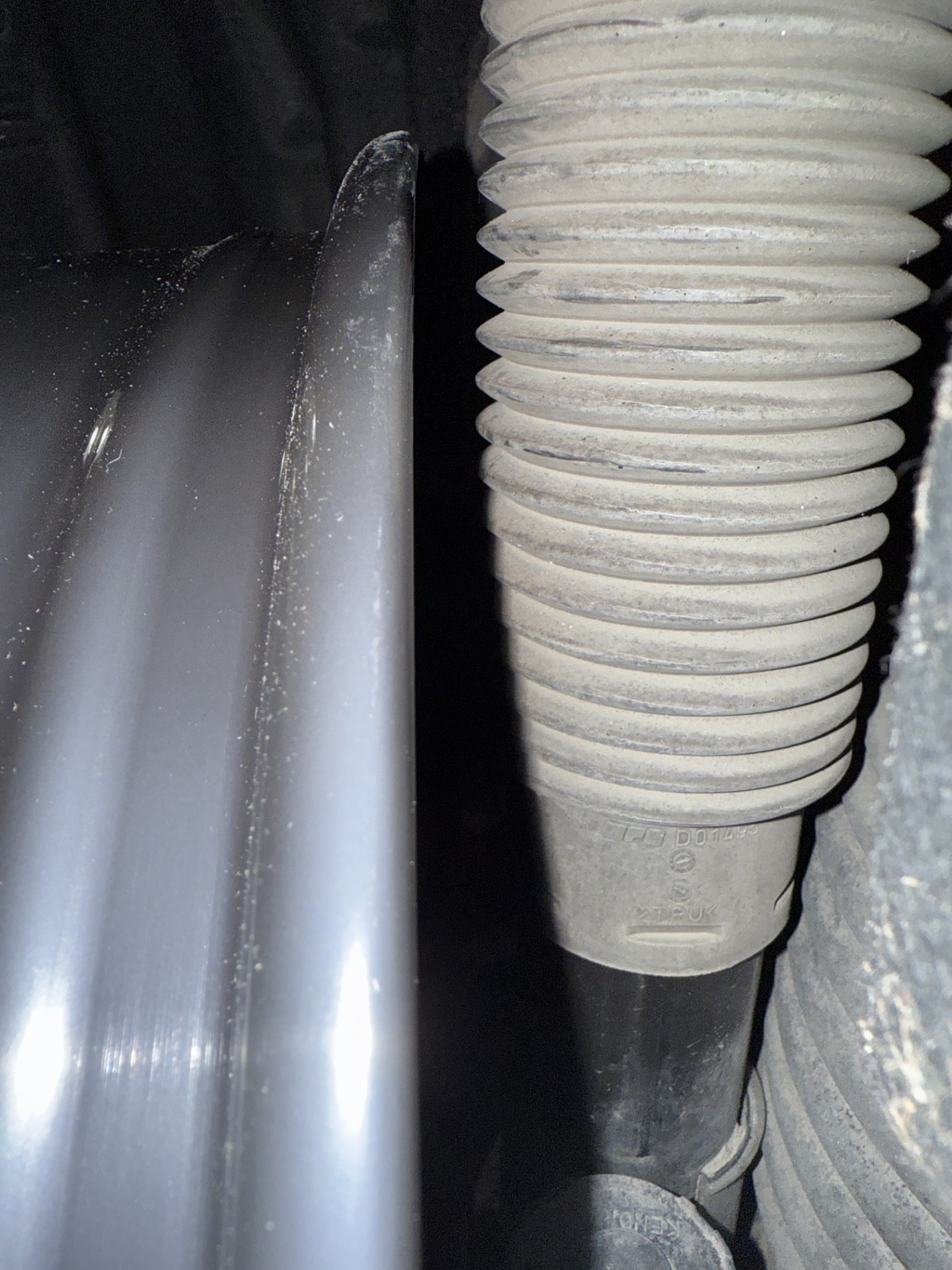

PS from the pics looks like the shock isn’t touching 👍

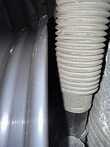

If you throw spacers on like @ I.T. Guy suggested, would you be dangerously close to contacting the fender, and if so, would adding a KMAC Camber kit resolve your issues? I certainly don't have the answer to those questions, but maybe an option should the manufacturer not help you out.

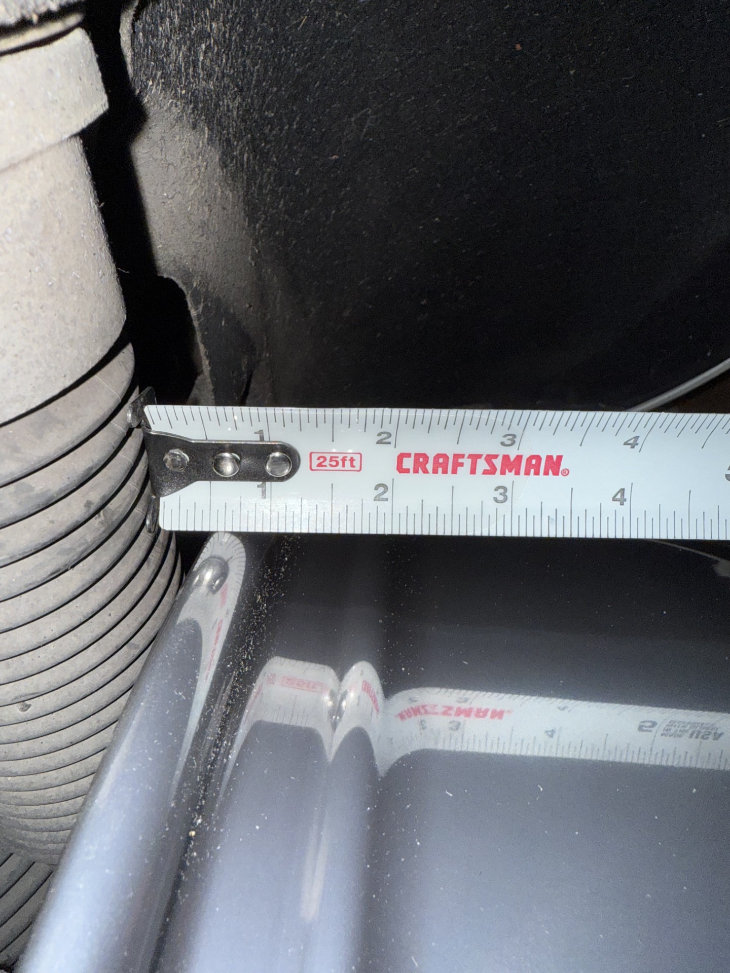

I went out to the garage and did a test fit of mine...
Looks like I have about .5" clearance from the shock cover boot. How in the world would a 305 tire fit in here without destroying that boot?
Mike
Mike
on compression, the wheel/tire will be up at the top, near the shock perch....that metakl bracket up at the top. i think youll be fine still, but mine is dangerously close and rubs on another part of the body, if looking at the driver side, sort of oin the 2 o clock position, theres a really high spot on the body, and it definitely rubs the fender liner on mine. it sgonnas just destory that felt.
so far the mfr is only offering to remake at cost and I pay full shipping and te re-ceramic the new wwheel, even though HE suggested 56mm offset after i repeatedly expressed concern. Im hoping he changes his tune because I really feel like he sort of pushed me to that offset but in the end i did agree. I would rather run 20x10.5 et50 in the rear and run stock tire sizes than have issues with rubbing etc. PLUS, i have a warranty that may preclude me from runnign that larger tires size? separate issue for now but definitely on my mind
I also priced some 5mm hubcedntric spacers but then im runnign spacers, which i dont want to do, and the outer face is ion a different location that planned. UGH
As for the boot, on the inside edge i dont think the tire sticks out as far as the face side because who cares if the inner edge gets scraped etc. But on mine its rubbing even with 295's

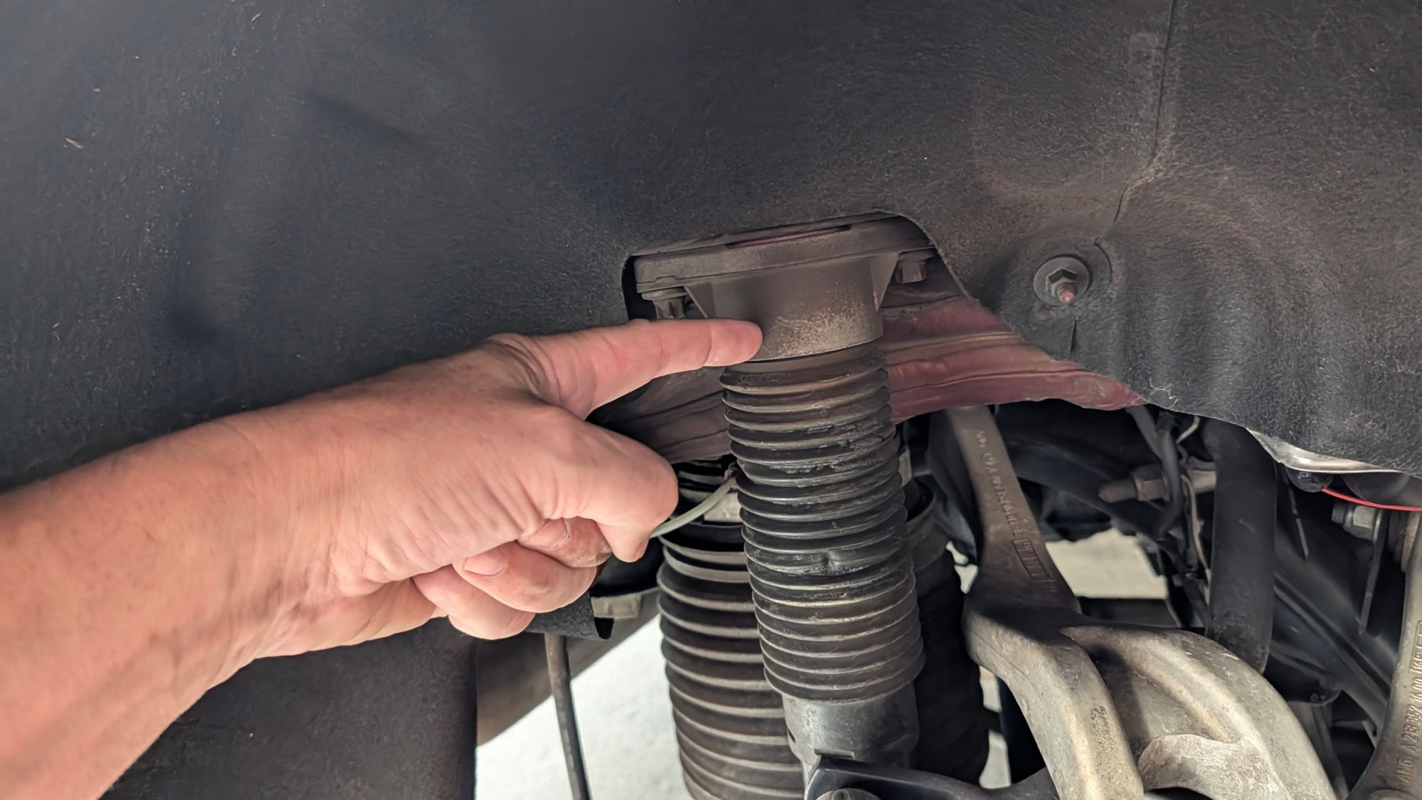

Old Oct 15, 2025 | 05:22 PM
  #392
BRGR TME's Avatar
Joined: Mar 2012
Posts: 214
Likes: 77
2018 E63S Wagon
Mike
Tire and wheel will be up here near this area when sitting on the ground

Is the ET really 56? Math says Bead to Mounting Surface should be around 195mm and outside lip to mounting surface (assuming "standard" 1/2" lip) should be 207mm. Did they make the wheels right in the first place?
I'm blown away ET55 works with 315 but ET56 is a no-go with 305. I guess it is what it is!
This is what I measured......it seems its actually 56mm, maybe even slightly less at 55.85, but like i said, even the stock tire is an issue

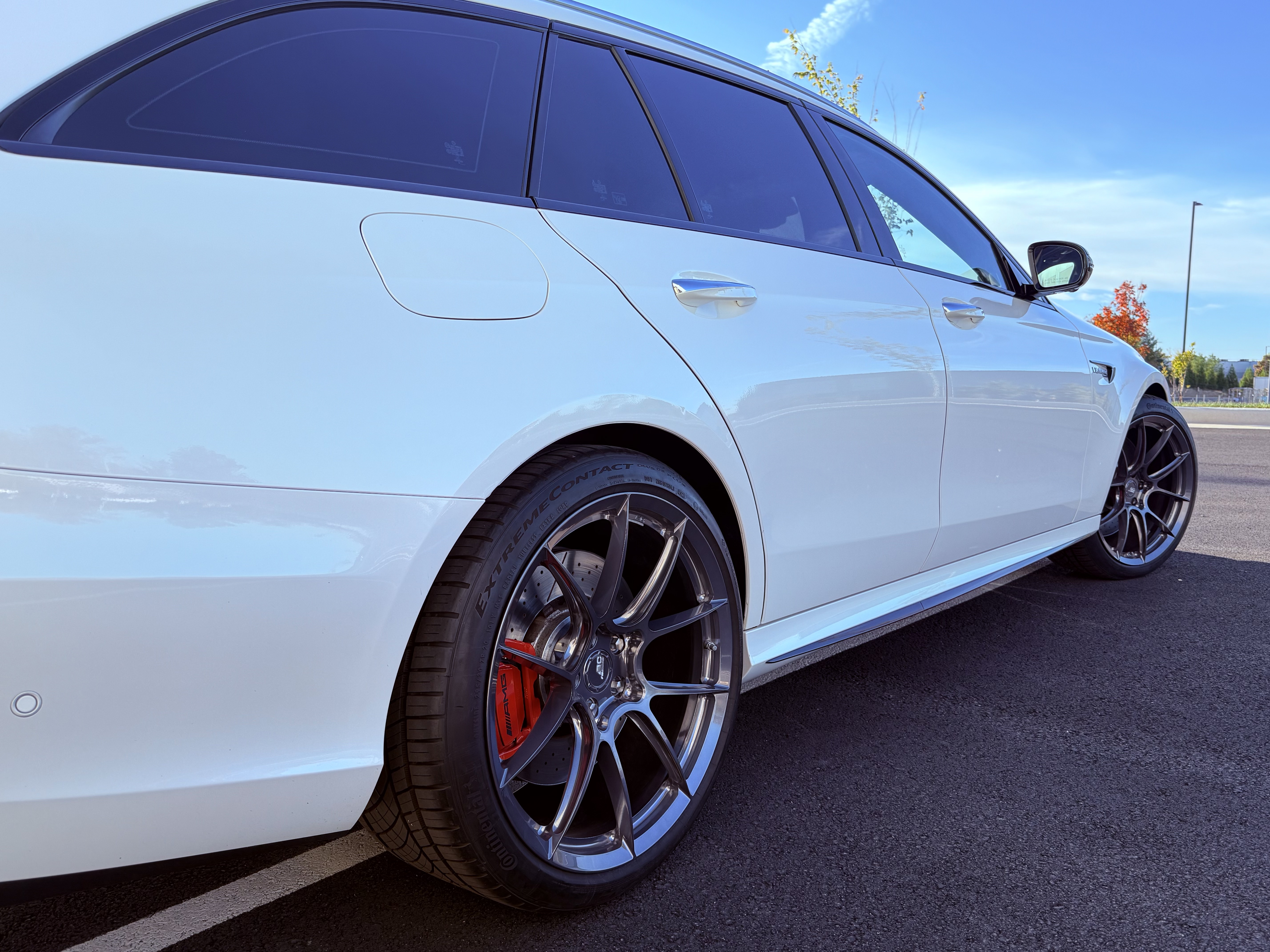

Sorry for the mediocre (and not so many) iPhone pics. Hope I can produce some better ones once I get her cleaned up and the ride height dialed in.
Curious to know what the collective thinks, but I happen to LOVE them!
BC Forged KL51s in Bright Graphite Grey - 20x10 ET +15 Front - 20x11 ET +50 Rear - OEM Tire sizes for the moment until I can run these DWSs out of tread.
Mike
