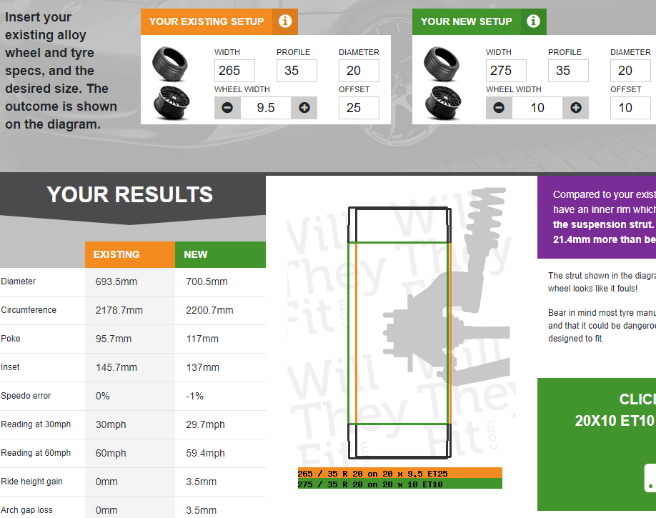

Go here and type in the before tires and wheels and after tires and wheels and you can see exactly the effects
https://www.willtheyfit.com/
Good advice and I've been using that website for years when doing wheels and tires.
Something else I do is once you've calculated what you want to do, take that difference from your current setup, say your new setup sticks out 30mm more as an example... cut a stick or something rigid 30mm long and run that along your current tire sidewall (sticking out) and it will provide a visual around your fender opening to see if you're close.

For example here is the specs I mentioned they stick out 22m more then stock (difference in poke)
And the much safer specs bobblehead posted stick out 16mm more then stock (again the difference in poke) and pepole frequently run 15mm spacers on the front with stock wheels, so guaranteed his setup will fit.
The setup I'd think about will poke out another 6mm more then bobbleheads suggestions which I think will be fine but could also look dumb and rub but I'm banking on this guy's post here:
https://mbworld.org/forums/w213-amg/...ml#post7885466
Here's that site with the front numbers calculated first with +10 then when +16 offset:
I’ve tried to use sources such as the above listed website in the past, but it still leaves me in a state of indecision.
I guess I’m just trying to go with the safest spec that will still provide me with a somewhat flush look. If that makes any sense… LOL
