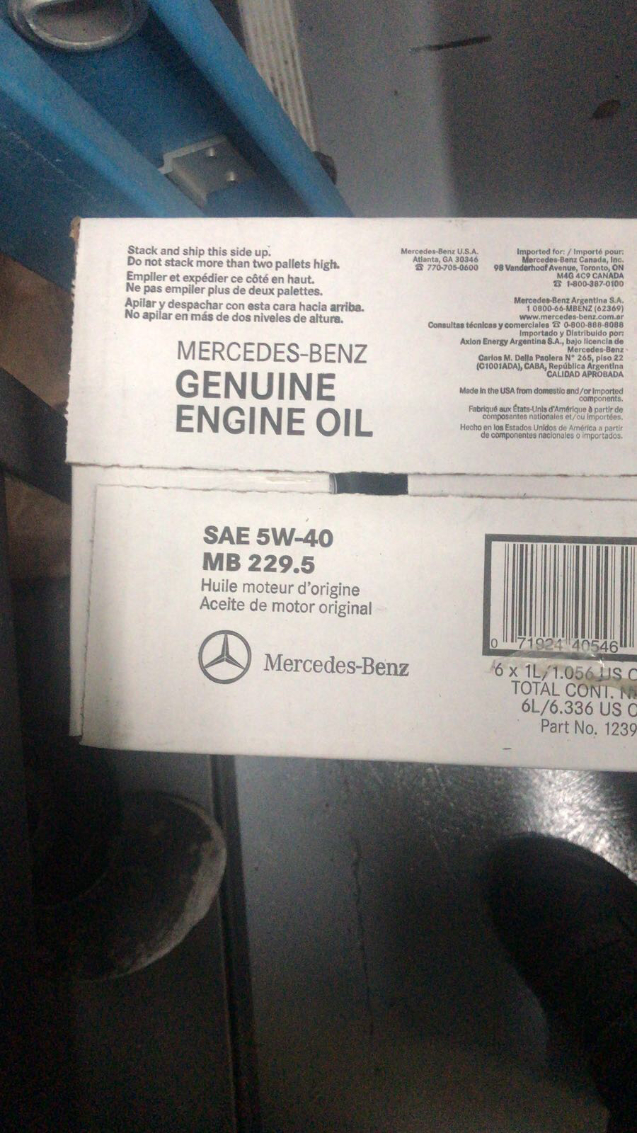

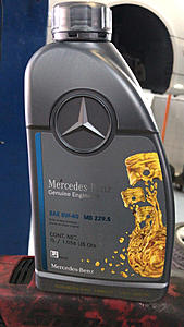

I just got this from the dealer per my VIN.

Is that conventional (mostly guessing bc it's doesn't say "synthetic")?

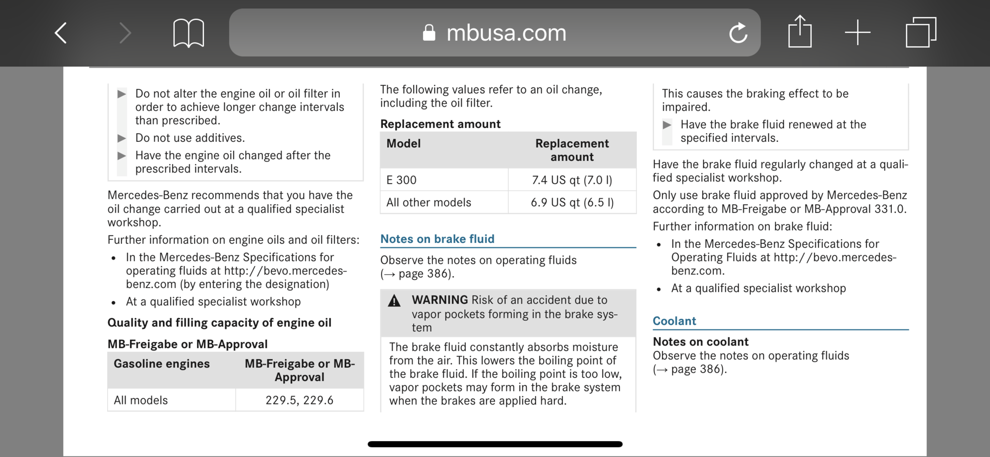

Are you saying
[QUOTE=jdhertz11;7422961]I just got this from the dealer per my VIN.
Attachment 416144Attachment 416143[/QUOTE
we need 12 litres of oil for an oil change?

I thought it needs just 8 litres for the oil change

I was only kidding...
straight from the manual
but e63 4.0 litre engine requires much more than 6.5 litres. The owners manual is not updated with the e63 engine requirement.
Castrol site says our e63 requires 9 litres for oil change. I checked w205 c63s needs 9 litres.
can someone confirm which is correct ?

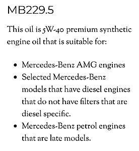

Was that info from the regular manual or the AMG supplement?
I thought it was something closer to to the 9.5 L value posted above.
First oil change is at 10,000 miles, so I'm guessing that's not dino oil and must be a synthetic.

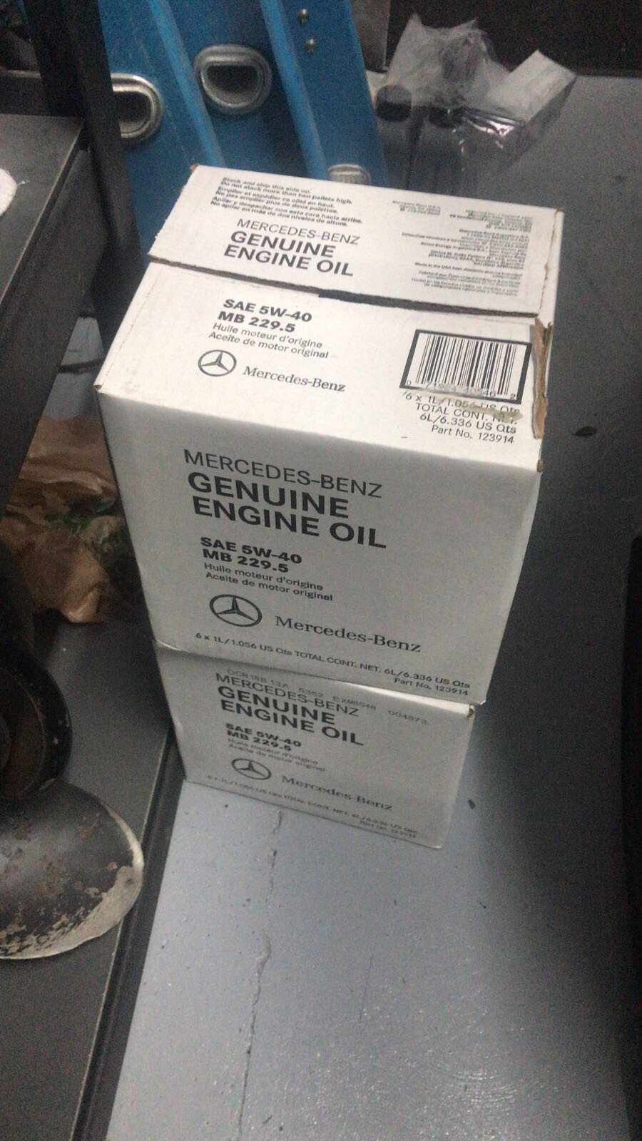

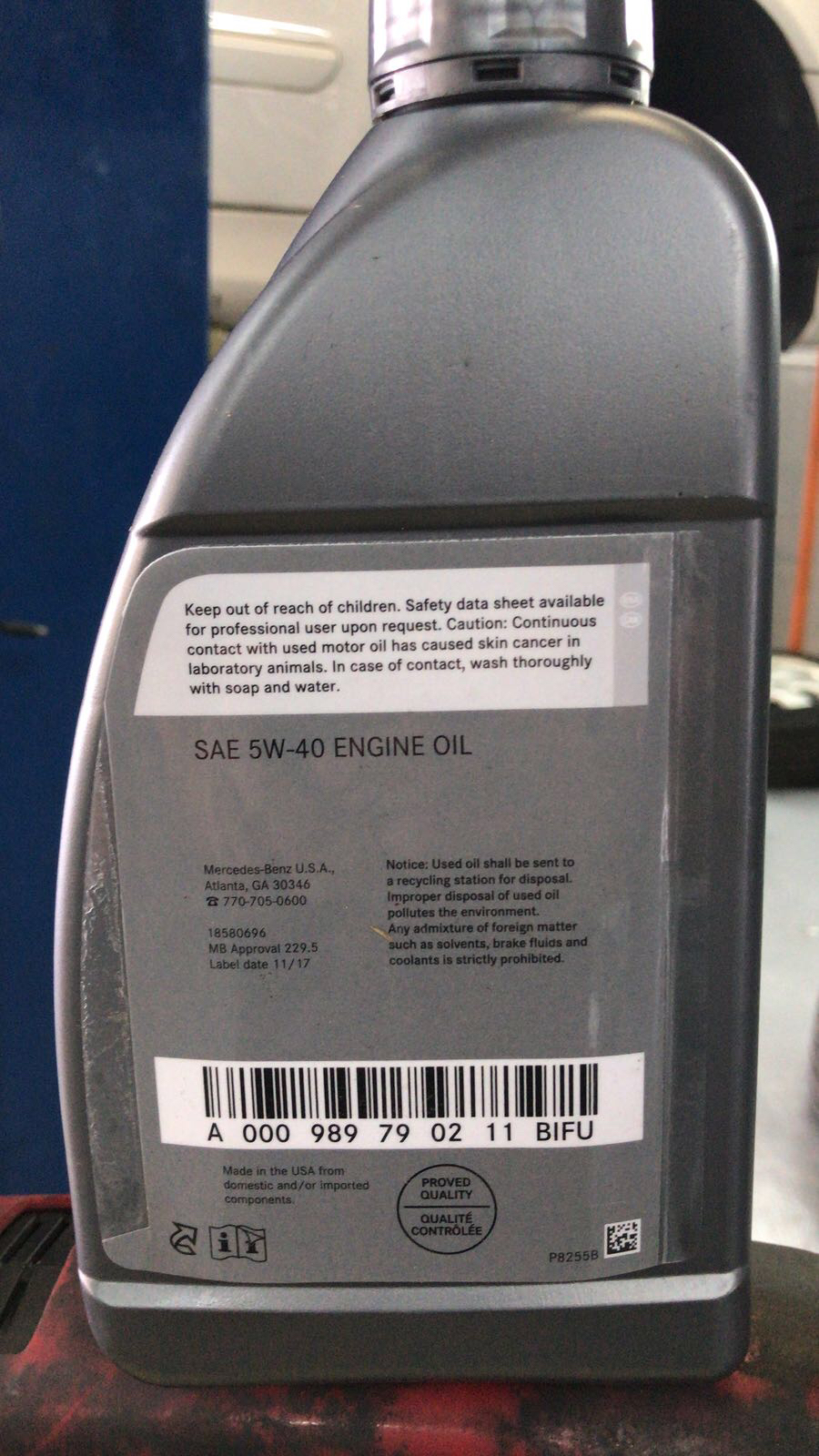

New Car Factory Oil-photo291.jpgNew Car Factory Oil-photo922.jpgNew Car Factory Oil-photo371.jpg
