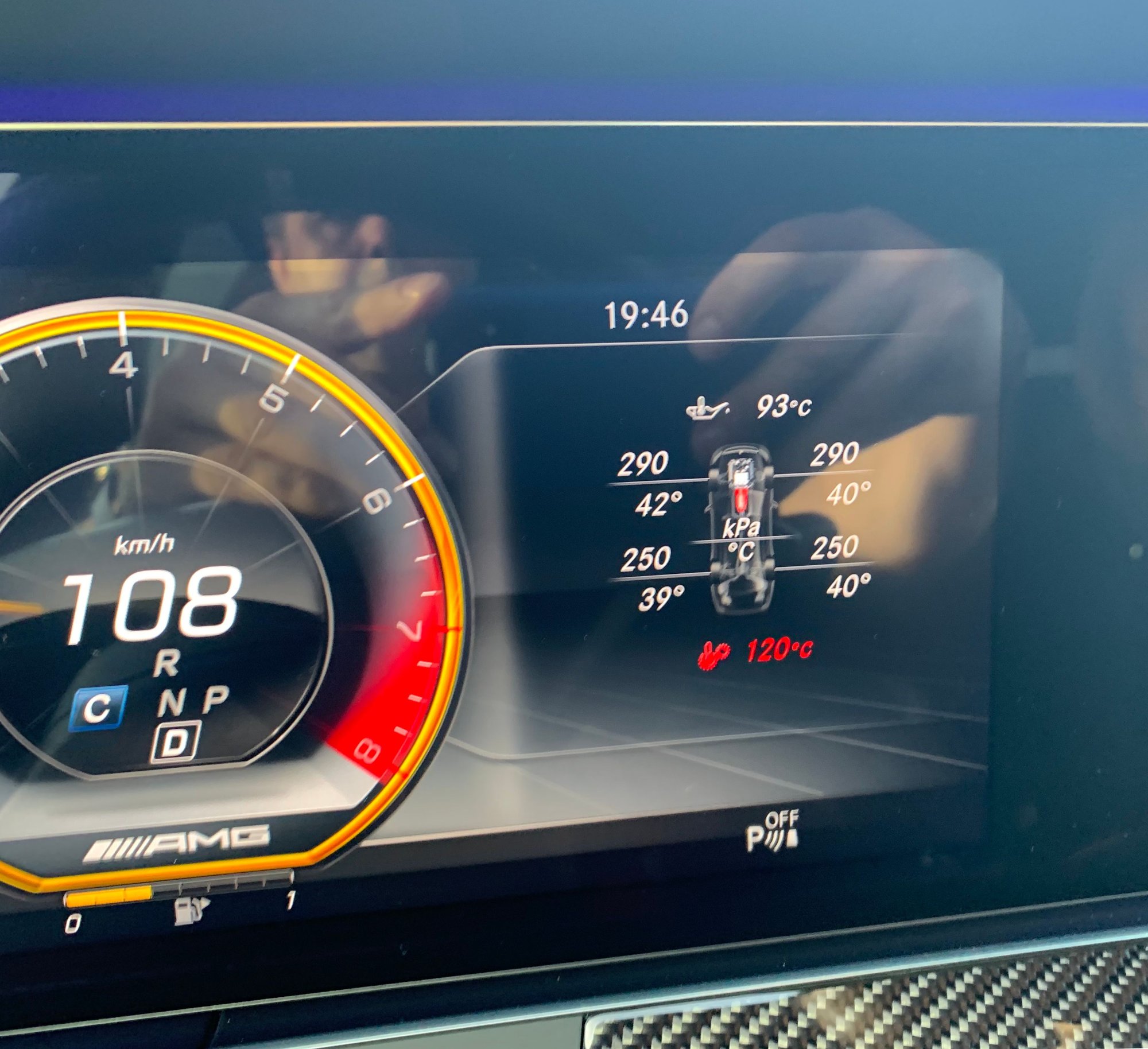

No,they told me that was a some cooling tube conection.But when i pick up y AMG and back to my hause the temperature go up and the coolong liquid going out again like a firts time.The liquid is from the litlle cooling circle,from the second cooling tank under the engine tap,whos cooling turbos and gearbox.

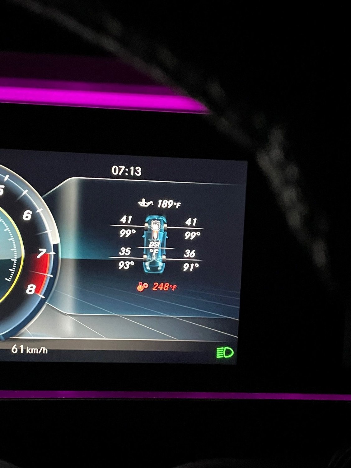

Sorry to hash this thread up - but just had this happen to my 19 e63.
trans temp went to 248F.
car is CPO, have an appt set up to take in.
anyone else have a different experience with this?
Been driving the car normal - after 45 minutes to an hour of driving, temp steadily increases and fans are blowing non-stop.

I'm almost 99% sure a rock or debris punctured your heat exchanger core for the trans cooler. The leak is causing inadequate cooling and your temps are spiking, it's happened here before to plenty of people.

Confirmed a couple days ago there was a puncture.
