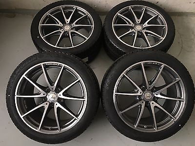

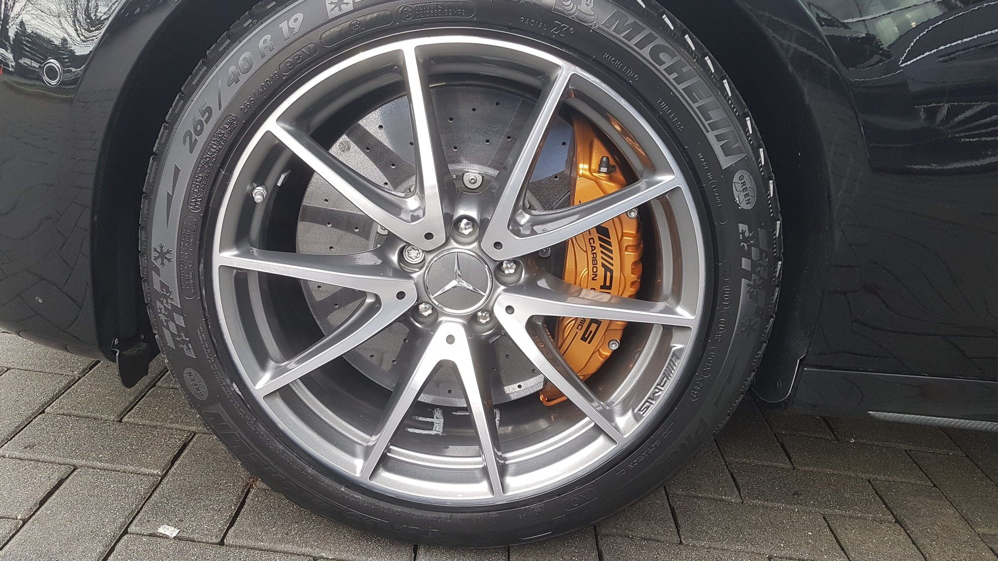

There’s an OEM winter tire package for the E63
Front: 19 x 9.5 et 25 A2134012600 265/40/19
Rear: 19 x 9.5 et 52 A2134014600 265/40/19
I was quoted $4200

CCB require 20", right? In which case I wonder if that winter tire package can be done for the 20" as well. Seems worth the price.
They do clear the ceramics.

Just checked with my parts Dept. Those numbers are for wheels only and are NOT orderable in the US. The parts manager checked with MBUSA and those part numbers are also for the previous E63S. They will have winter package by OCT, 2018 for the 2018 E63S.

Your dealer is wrong. Those are the w213 e63 offering since last winter. It’s the only winter package offered.
I bought the same wheels but opt for different tire sizing and brand

I'm in Colorado and I was able to order those rim part numbers (front part number: A2134012600, rear: A2134014600) from my dealer and I received them along with my 2018 E63S Wagon in November 2017. See my post in the "Winter Setup" thread with details here:
https://mbworld.org/forums/showpost....3&postcount=81
The dealers were clueless last winter regarding the appropriate winter setup for W213 E63S - it sounds like things have not improved since then. But I can tell you those rims worked perfectly for us last winter on our E63S.
