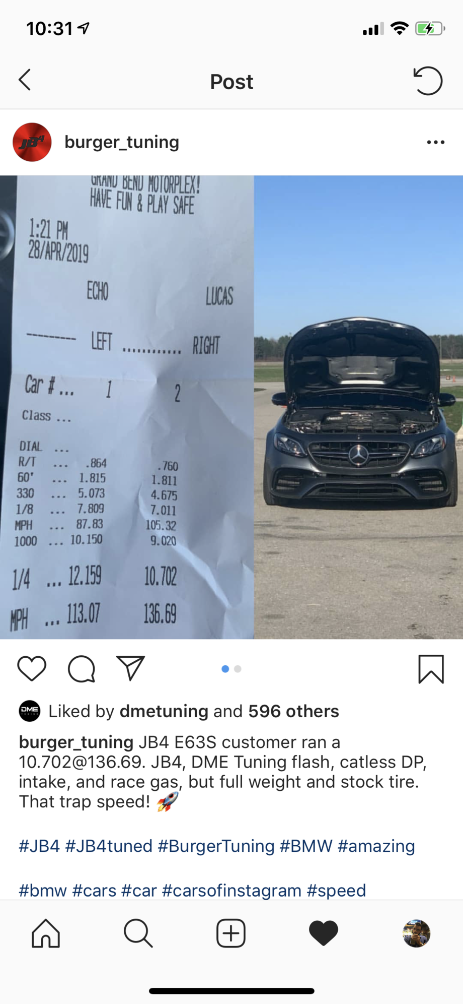

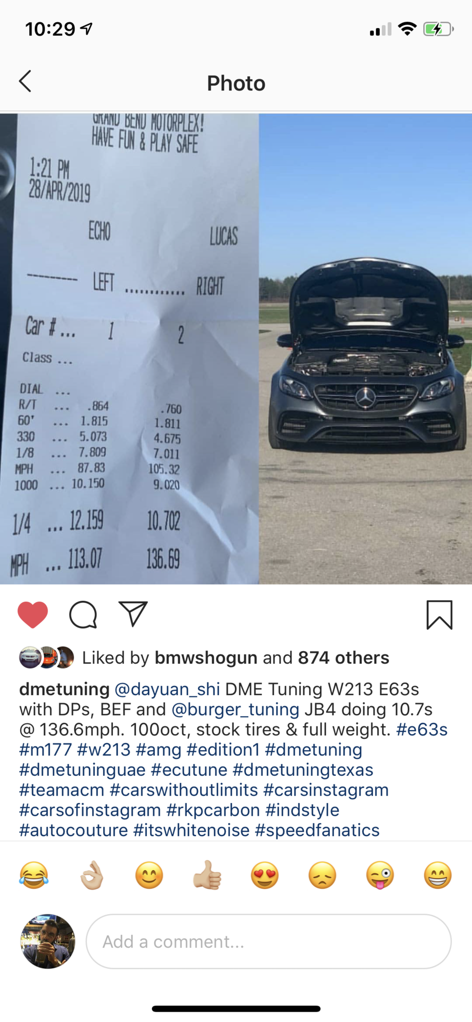

JB4 helping reach E63’s potential
Looks like the Burger tuning JB4 unit with DME tuning, downpipes, intakes and 100 octane is matching an equally prepared F90 M5’s mph in the 1/4. With a better 60ft, it should be a strong race between the two cars coming down to the driver.

Compared to the front half and even to the 1000ft mark, the trap speed looks like a last second nitrous hit. That mph doesn’t add up. Without a second timeslip to help clear things up I’d suspect a timing/mph error.
I agree that the 1/8th mph is low compared to the back half. I would expect around 108/109 mph with this terminal speed. I’m sure we’ll see more results soon. DME Tuning is the real deal making world record hyper fast high 8 second McLaren 720’s. Exciting, nevertheless, if true. I vaguely remember a Burger JB4 F90 M5 with 100 octane fuel hitting around 134 mph so even if there was a timing equipment issue, this car would be on par with that one with similar mods. I’ll look that one up and post the IG.
DME has had some issues getting anything out of the W213 platform so if there’s any credit due it probably goes to Burger. However, that timeslip is a perfect street car 10.7 slip in every single measurement except for the terminal mph. Somehow it went from a 10.7 run up to the 1000ft mark then it’s speed jumped 6mph above normal in the last 320ft without improving its time. The trap beams were likely tripped by a bird or debris. It’s not common but it happens and makes more sense than any other explanation.

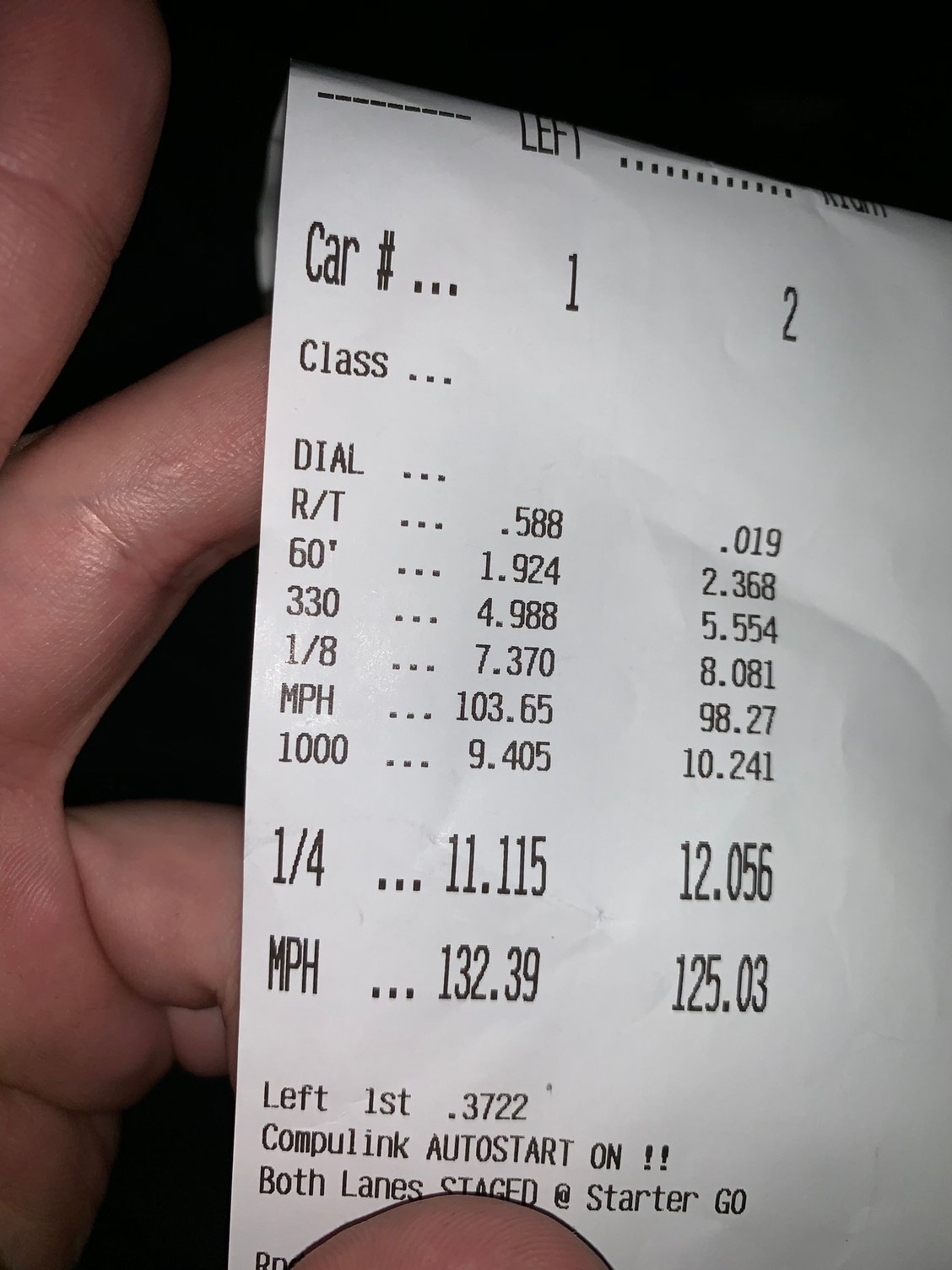

Running 132 all day doesn’t back up a near 137mph random trap speed. In fact it helps validate my concern over an error with the speed measurement equipment.

Actually both time slips show an equally impressive performance in the last 1/8th of a mile. Without knowing the DA of the track it can be as difficult to compare time slips as it is dyno graphs.
Nope, the second slip shows a mild improvement in the 1/8 to 1/4 mph. The first shows a massive improvement!. The second slip makes sense for a car increasing boost in the upper gears. The first one defies that explanation, at least when we’re talking about stock turbos.

I must be missing something. The first slip shows an increase of 31 mph and the second slip shows an increase of 29 mph. Both very impressive and very close. Please correct me if I’m wrong.

There is more to it but just going by the delta you’re looking at, it’s closer to a 3mph change. And keep in mind, it happens in the last 320ft because the 1000ft time corresponds to the rest of the measurements of that run. A 3mph increase in that short of a distance is highly questionable. Even the owner stated all his runs were in the 132mph range. Why would anyone not be suspect of a random 136+ mph run that couldn’t be duplicated. 4mph would be like his car just happened to make an extra 80-100hp on that run., and to make it even more weird, that 100hp only affected his mph but not his ET.
Keep in mind I’m not knocking Burger, he’s doing some great things for several platforms and I’d love to see AMGs quit getting spanked by Audi’s and Ms in the 1/4mile. I’m just calling out the obvious in this particular case.

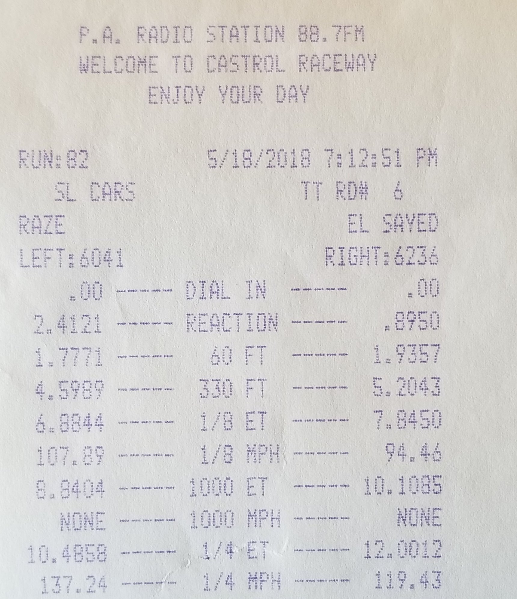

At 137mph trap speed in the 1/4, trap was ~108mph in the 1/8 in my w212. 93 Octane tune. If there are problems like transmission or tires slipping in the first few gears there can be discrepancy between the 1/8 and a 1/4 trap speed.
136.7 trap on oem turbos is very very high. If it is real it will be reproducible. Instead of putting down the forum members just reproduce the run a few times and people will stop asking you questions.
